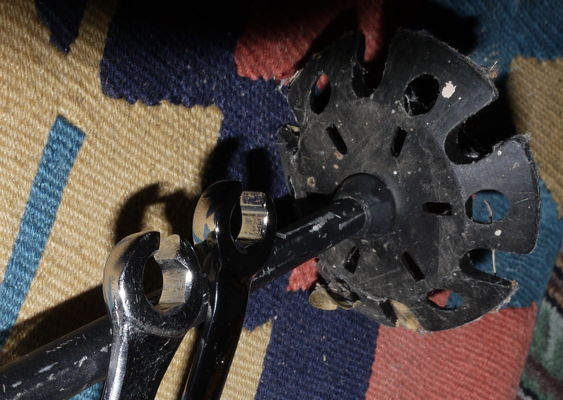

ski pole to prop the brake pedal seems to work ..
just inspected a new Halfords professional flare spanner 10/12 right .. next to an older used williams 11/13
where is this junk made .. are they forged ? look at the imperfections on the jaw face , I'm afraid it could knack a flare nut; does their lifetime guarantee reimburse me for that.
