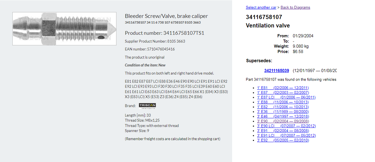

but looking yesterday evening at car - seems I need to change a couple of corroded bleeds screws cracked two rears, but front two have little grip
they're now well plus gassed, but I think I will need to cut tops off and drive a small socket on ?
after getting some replacements ...
I don't understand that oem number matching parts/34116758107 I find on google all have bigger nuts 9mm than the existing 7mm of ones on there now
no do tell - I'm imagining virtual reality rehearsal for the actual work .... the weather isn't playing ball today.

need to double check w/caliper bleed valves I order will be correct size

it's either a m10x1 or probably m8x1.25 .... there's enough of the thread visible to measure with a caliper .. which I should have done on Friday;
often, adverts tell you it matches oem part number but don't say/confirm what size it is (like buying tap valves)
