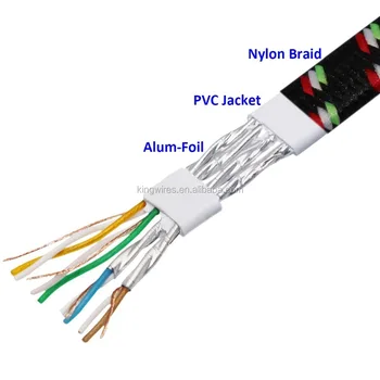

I would use flat cat 5e for that ive seen network cables bend a lot more than that without issue
Flat Cat5e/Cat6 cable isn't a thing - it relies on the twists in the cable to provide noise rejection. Any flat cables available don't meet any CatX specifications
