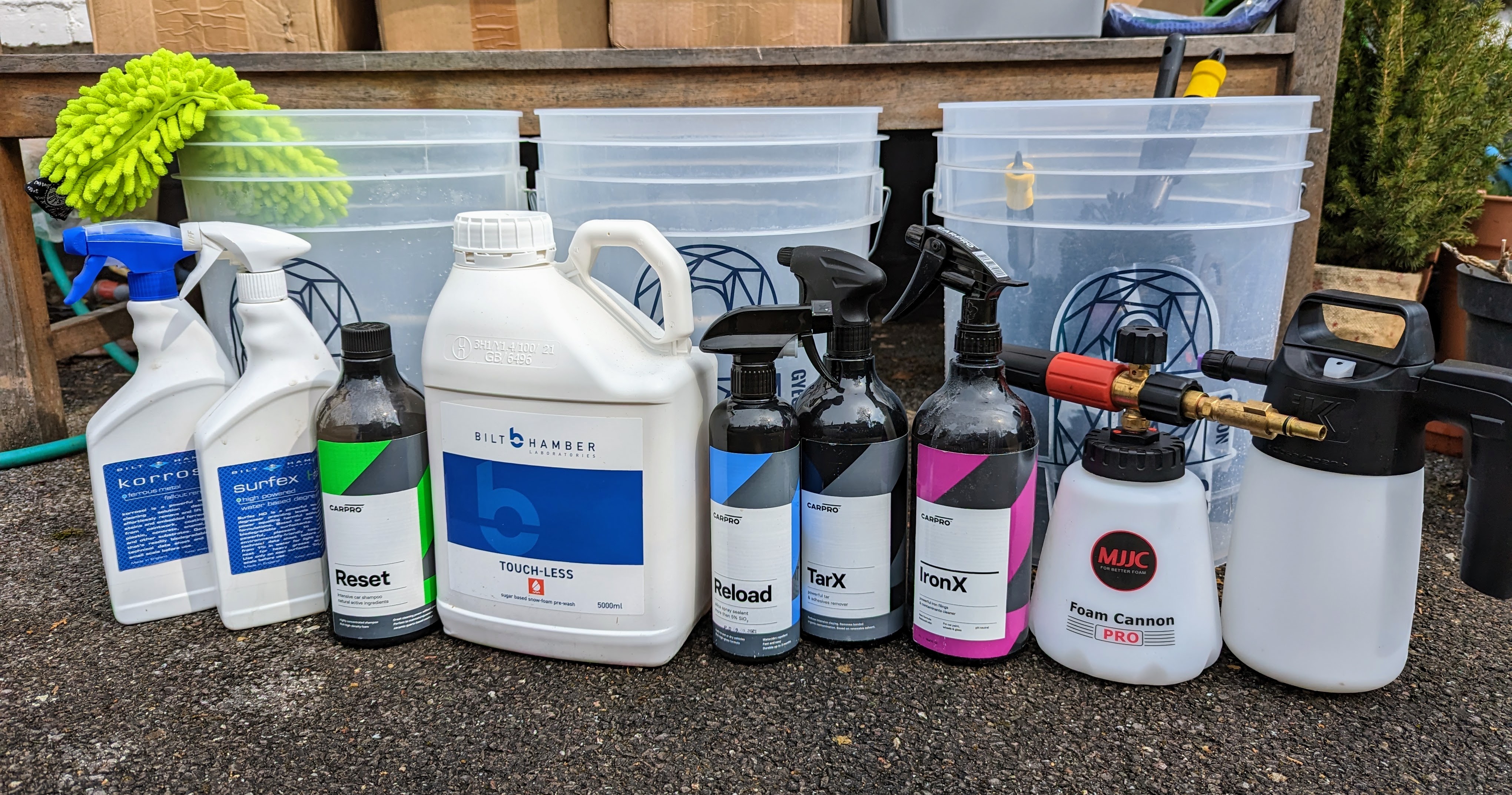

I'll detail my process just so I can link back to it, this is more for the obsessive person with more time than sense.
Basic assumptions - you have access to running water and ideally own a pressure washer.
1. Wheels - Rinse wheels, spray on AD Britegel and scrub tyres with tyre brush, go over the wheel with whatever brushes are suitable for the design of wheel you have. I use a Wheel Woolie for the barrel and chemical resistant sash brushes to get in the recesses for the nuts and an old noodle mitt to go over the wheel. Rinse throughly. If the wheels have not been cleaned for a long time this is when you'd use a fallout remover such as AG Magma or Carpro IronX, let the product dwell as per the instructions but never let it dry out, agitate with brushes/mitt and rinse thoroughly. If you can, get right in the arch liners with your lance to blast out any dirt.
2. Pre-wash - If the car is really bad, usually in the winter or if it's covered in bugs, I will spray the lower half with Bilt Hamber Surfex HD at 5% dilution otherwise I will go straight to covering the car with Bilt Hamber Touchless with a snowfoam lance - I use a MJJC Foam Canon Pro but there's loads of good lances to suit all budgets. I'll adjust the dilution depending on how dirty the car is, and the time of year as in summer months the car is just dusty rather than being covered in salt. You can use a pump sprayer but this will take a bit longer and will give your arm a workout. While that's dwelling I'll use a soft detailing brush to clean the window channels and around the badges. After 5 minutes rinse the car off, if it's warmer you may have to rinse sooner if you see patches drying out, if it's cooler you'll get more time.
3. Wash - Two buckets, both with grit guards. One full of clean water to rinse, one with soapy water. It's hard to go wrong with shampoo, anything pH neutral will do, I tend to stay away from wash and wax types as I'll use a detailing spray to add protection at the end. I've used AG Foaming Car Wash in the past, I'm using Meguiars NXT Car Wash at the moment as I got a big bottle cheap on Amazon. I use an Adam's Wash Pad on the majority of the bodywork as it holds loads of soapy water and lets me cover a large section at a time, I'll use a microfibre/noodle mitt on the lower sections last just to minimise any risk of causing swirls.
3a. Decontamination - If this is the first 'big wash' you may want to use fallout remover on the paintwork to remove any stuck on contamination. First you can cover the car in fallout remover, let it dwell and agitate with a wash mitt. The next stage would be to use either a clay mitt or a clay bar. A mitt will let you cover large areas, a clay bar will take longer but as you mould it to the shape of the bodywork it does remove more contaminants. Once this has been done you can move to polishing and waxing but I won't go into that here.
4. Protect - Now the car is clean I can spray Carpro Hydro2 Lite sparingly over a panel at a time and rinsing off, this is a quick way to add protection to the car. Gyeon Q²M WetCoat is also very good. These will also act as a drying aid as water will bead off the car instead of forming puddles that you have to soak up.
5. Dry - Fold drying towel into four sections (stops you from dragging it on the floor) and dry from the top down, I have two Meguiars Supreme Drying Towels, one for the outside and an older one that isn't as absorbent any more but it's perfectly fine for door shuts and wheels. It's important to wash your drying towels using liquid non bio detergent without fabric conditioner otherwise they will stop absorbing water. If you have to use the dryer make sure it's on the lowest heat setting.
6. Finishing Touches - Go over the windows with Carpro Clarify (there's loads of decent window cleaners, it's almost impossible to buy a bad one) and a couple of clean microfibres. Dress tyres with Carpro Perl diluted 1:1. Best to stay with waterbased dressings as solvent based gels make the tyres sticky and they end up attracting dirt. Autobrite Classy is another nice dressing that doesn't look too shiny.

Oooh new thread! What the hell are those green buckets!? :cry:
Great post @Janesy B. I use a lot of the same products as you do.
*Some* of my most used products:
