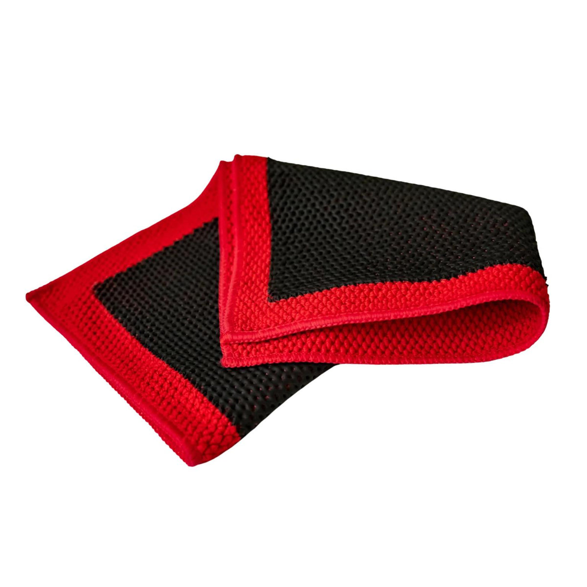

Hey all, I'm after some advice. I think the answer is that I need to give the car a good clay bar treatment (not done this myself before)
Recently bought an s2000. After a wash, I noticed the surface of the paint isn't very smooth. Just feels a bit.. dusty? Hard to explain. Just a slight roughness to it.
I did notice this seems to just apply to the top surface of the car, the sides feel smooth enough. So Im assuming it's just contamination/debris settling on the top over time.
Any tips on what I should do and what product to use?
If it is a clay bar, are they a one and done thing or can they be reused?
Thanks!

after a wash
use over and over and over , saves you buying clay that gets thrown away
or , what i use is a clay blok from chemical guys with their clay lube
you've probably got stuff you can use as clay lube, do not use water its not slick
you can also do iron remover at the same time

I didn't realise you could get it in towel form, useful!
I do have the Autoglym Magma stuff but never actually used it, I thought it was for the wheels for some reason
Magma helps separate iron contaminants - it can be used on wheels or paintwork.
Do a normal clean, then spray generously over paint while it’s still wet. Wait 2 ish mins for the colour to change and then go over the paint with your wash mitt.
The last stage in important - iron contaminants bond pretty well to the paint so you’ll need some mechanical action to remove it fully :)

If the paint feels rough, it needs claying
After you clay it, the paintwork feels lovely and smooth, you will want to protector it afterwards

If the paint is rough, it could be general contaminants.
If you clay, you’re almost certainly going to need to polish it after - you’ll get marring (micro scratches) on the paint from clay.
Recently watched a video from my local detailer (fresh layers) and they use baby shampoo with water as a lubricant, rather than purchasing a “clay bar lubricant”.
I’ve been using dish soap but did find baby shampoo more slick and it’s considerably more mild.

I've ended up going for a Mitt and spray, but do feel a proper old school bar may have been better for the first time as it could be quite heavy contamination. We shall see! Annoyingly only washed last night so when it arrives I'll have to give it a quick once over again before claying
I really hope this solves it!
Read horror stories that you can scratch the paint when claying by dragging all the contaminants around so will go careful.
So is this the process..
-Normal wash/dry
-Clay fun, spray, clay, spray clay.
-dry as you go? Or rinse car at the end, then dry?
-then finish off with something like the ceramic spray stuff or a wax of some sort?
