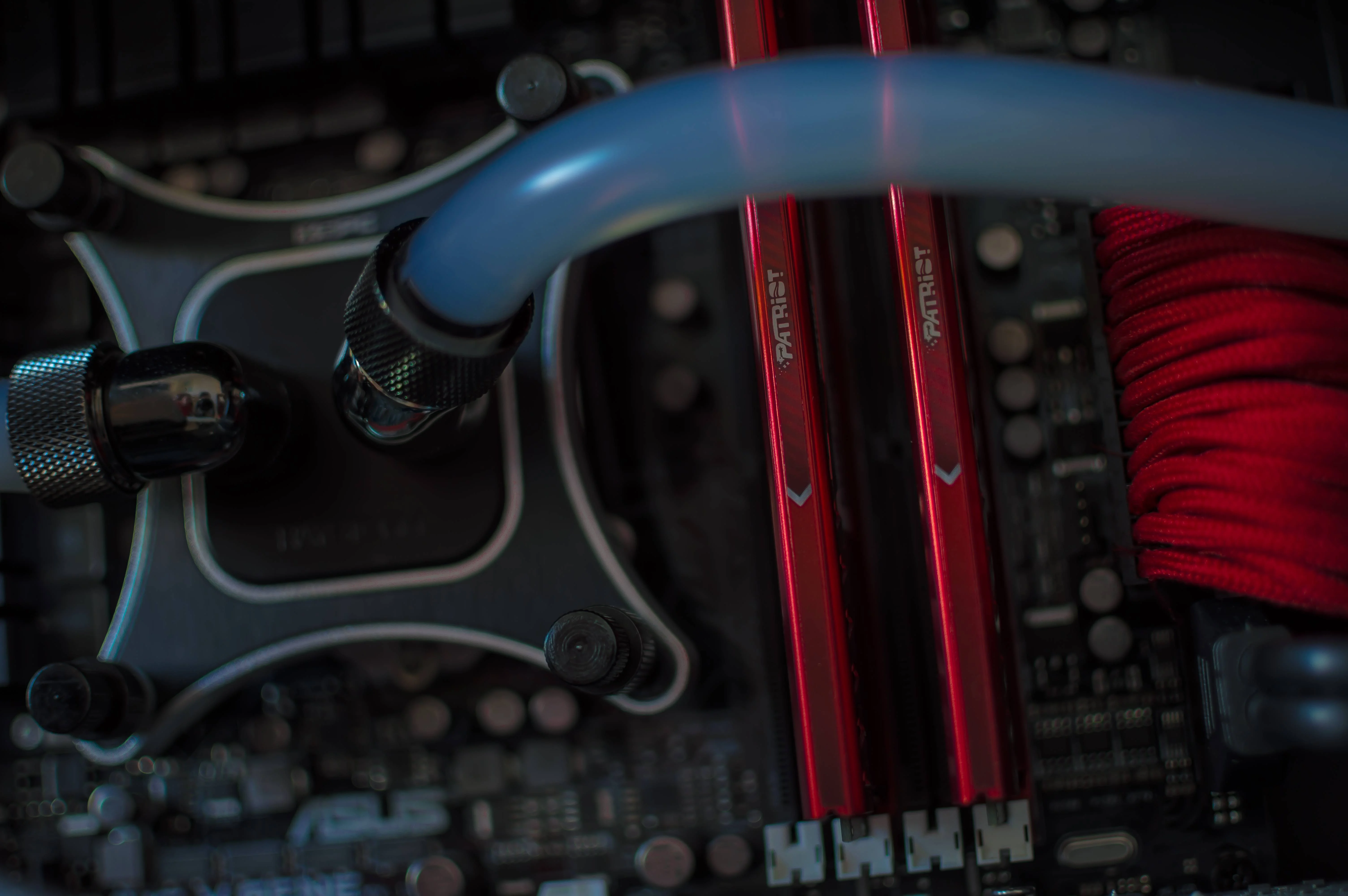

Mayhems pastel Ice white, Not as white as I thought, has an almost blue tinge to it but Its still very nice

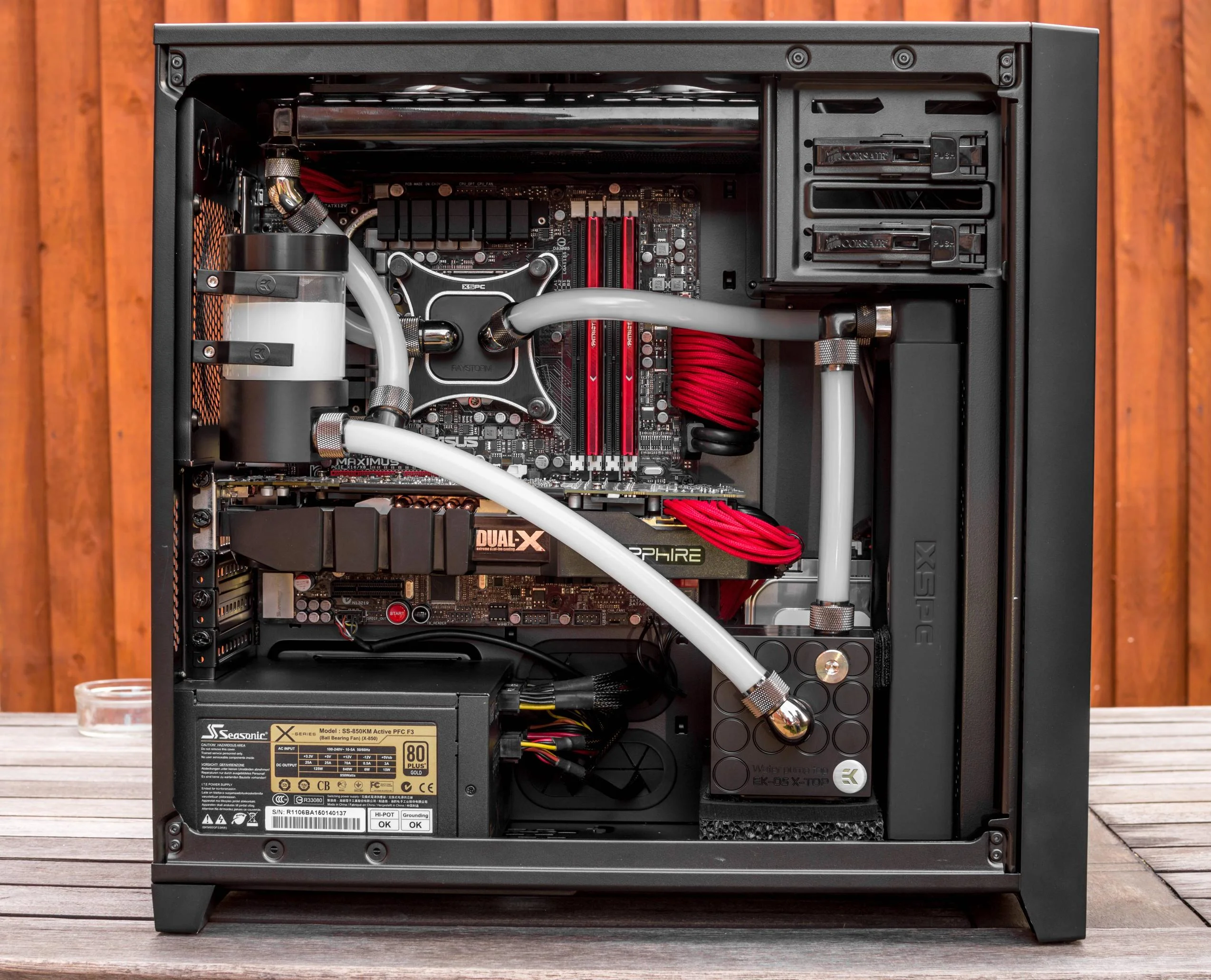

ok leak tested for 4 hours and no leaks so i powered it on and ran it through some temperature testing to try and expose leaks, none were found during the hour run of prime. Max temps reached were 55c on the hottest core

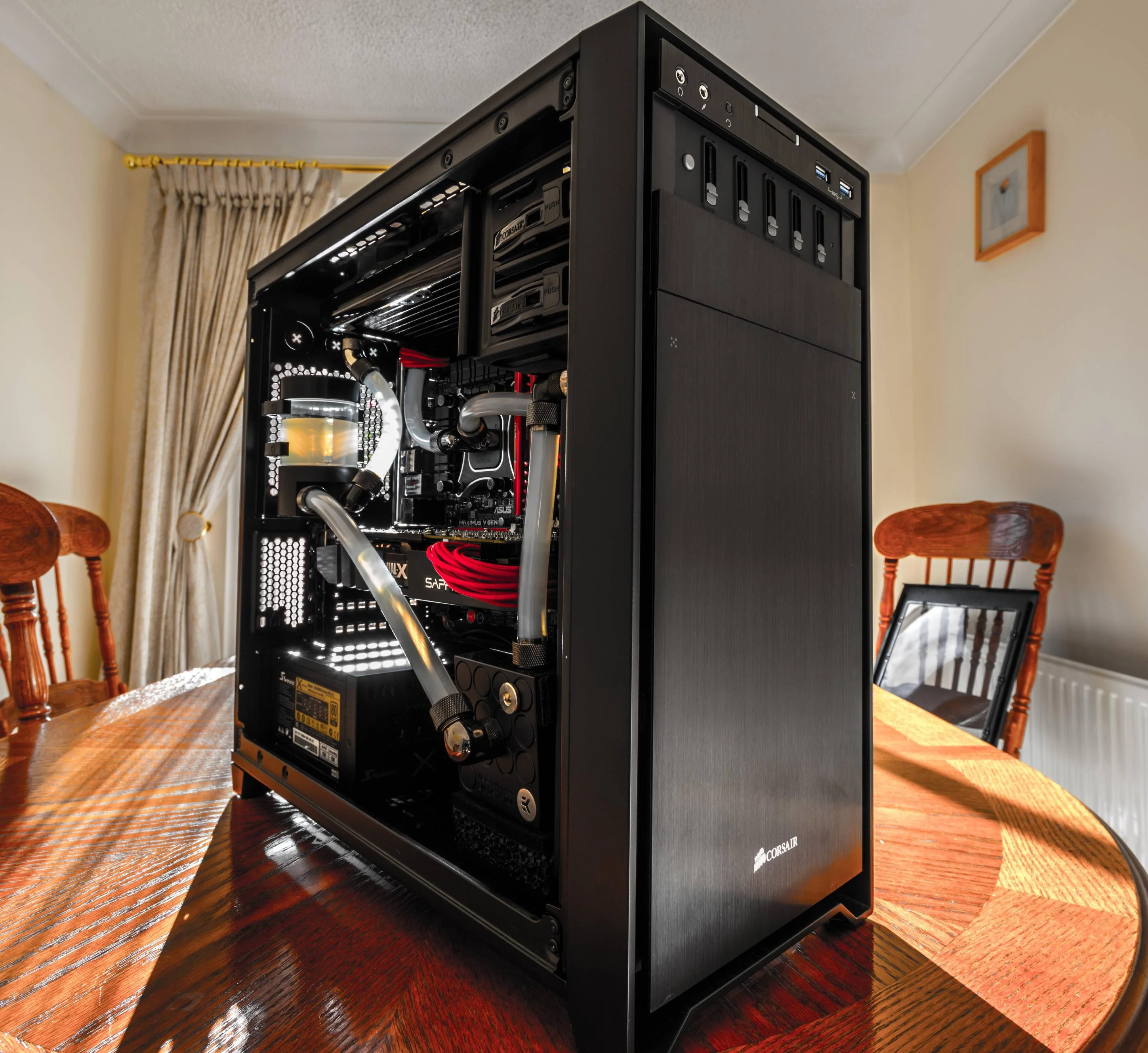

All finished.
Ill get some better pictures eventually with the slr also need some case lighting as i cant see it at night now I have no led fans. but thats a later job.
Res-->Pump-->240rad front-->cpu-->240rad roof-->res
The loop order was chosen as it was the neatest to install.
Oh and before anyone asks, There isn't a compatible waterblock for the card which is why I didnt put it in the loop. Id want a full cover and not a core only.

Just a small update. Havent got round to overclocking the cpu back up yet however I have been testing the passive cooling of the loop while browsing the net and other simple tasks like word documents and playing music.
passive cooling doing these tasks results in the cpu reaching max of 37c and absolutely dead silence. muting the sound and turning the monitor off once the HDD switches off after idling for a few mins you cannot heard a thing, its like its not even on :D:D:D
