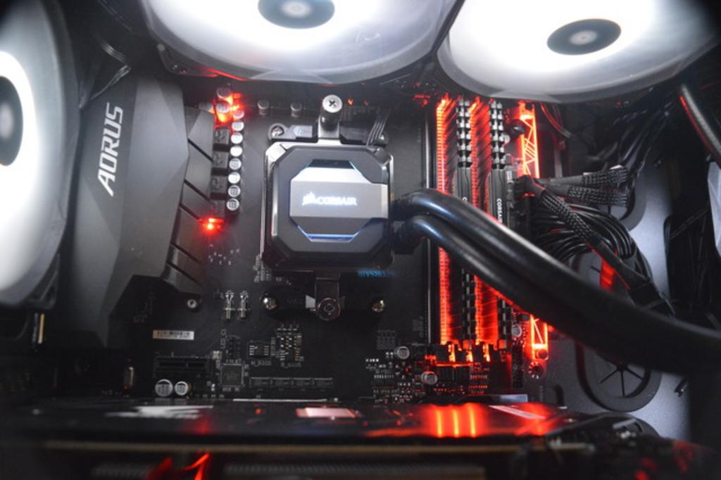

http://[URL=http://~imgbox~/bHjlNDh9][IMG]https://images2.~imgbox~/12/60/bHjlNDh9_o.jpeg[/URL] https://images2.~imgbox~/de/b8/qTrr2uHs_o.jpeg https://images2.~imgbox~/1e/60/0WUPsygQ_o.jpeg https://images2.~imgbox~/f4/be/SH6j2VEH_o.jpeg https://images2.~imgbox~/a6/52/bRgYNWXk_o.jpeg https://images2.~imgbox~/dd/99/donjynd4_o.jpeg https://images2.~imgbox~/74/9d/fdvjNRxN_o.jpeg https://images2.~imgbox~/69/a4/3ijJyzgf_o.jpeg[/IMG] hi guys we’ll i was hoping to re use my old case but I’ve had to go for a complete new re build
Following specs
Phanteks p400s Gun Metal Case
Ryzen 5 1600 @ 3.2ghz currently
Aorus AX370 Gaming 5
Dark pro edition 2 x 8 gb 3200 ram
Masterliquid lite 240 cooler
EVGA 500w psu
Crucial m2 275gb SSD nano
Samsung EVO 850 256gb SSD
2 x Corsair sp120 led top fans
More to follow
Had to order a extension for atx power tonight

I’ve had to mount the AIO Cooler at the front as due to size of b350 board it won’t mount at top of system, that’s why I have done intake at the top.
I did make a phone call to overclockers just to check on this as air rises I know and they said should be fine.
I think it’s the radiator on coolermaster masterliquid 240 lite is thicker than some too.

Cheap external DVD drive. Learnt the hard way ! Worth getting usb 3 if you can , plug straight to the back IO ports :)
Also you might find you have to install Mobo CD as Ethernet port not not work , nor wifi
I see, can't remember if the too mesh acted as a dust filters . Bit with enough pressure , should be ok. Might be worth getting the rear to intake as well, that way the left top fan won't lose out and will push GPU heat to the front as well
Heads up, older builds of windows on Ryzen is a pain !!!! If your able to install windows and WiFi or port works without installing the Mobo CD, get straight to downloading installing windows updates !!!!!!
The get the Mobo stuff sorted. DDU and then install fresh GPU driver
Yeah I have, I’ll have a look so have 3 intakes and cooler have has exhaust ?
I’ll have to have a look for cheap external then and delay starting up for few days
Yes I’ve learned hard way sir, hopefully shall be ordering a gigabyte, which one did you recommend please mate
Gaming 3 most common spec'd for budget , but Aorus 5 on sale, does have better VRMs along with more VRM for power delivery and to keep the temps down . Normally to expensive but worth a mention on sale. Don't sell the Aorus K5 here which is a shame

To be honest gaming 5 sale price matches it . Get the 5
K5 black out look is nice but 5 did have the more advanced bios at launch - k5 may have opened features but VRM count is increased on the White 5
