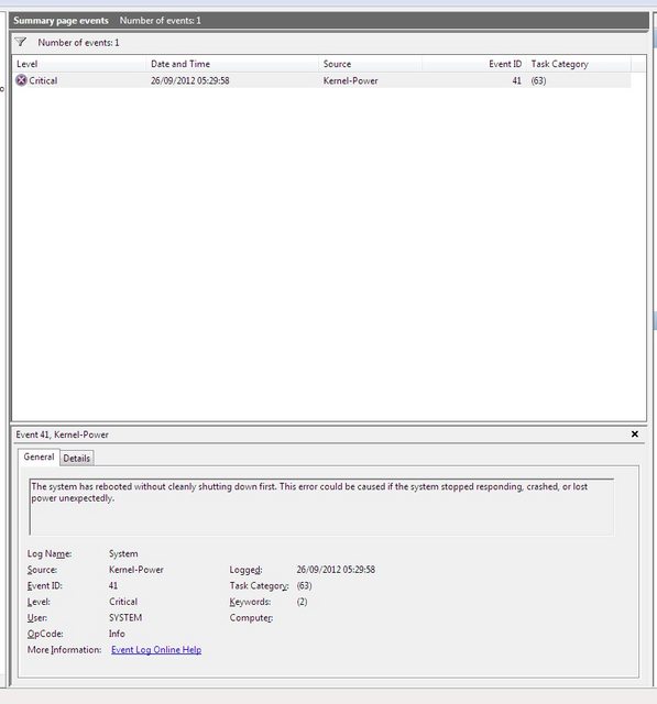

So I installed 7 and I was installing IE and then it just rebooted randomly. Went into event viewer and got this (ignore the time, think the BIOS battery needs changing):
Does it seem like a PSU error? And are you guys saying it would be okay to put that 250W PSU (Dragon Technologies LC250 ATX) from the old PC into this one? This one in the broken PC is 300W so don't want to overload it.

That is a cheap psu, kernel power event 41, a new psu solved that for me.
I'm thinking PSU is the issue too but don't want to spend money on a new one if it doesn't solve the problem.
By the way that Dragon Tech one isn't in this PC, I was just saying that is the only spare I have, but I think the one in this PC is a random branded one too.
Could it be RMA'd for a refund if it doesn't solve the problem? Or with RMA does it have to be unused or faulty?
