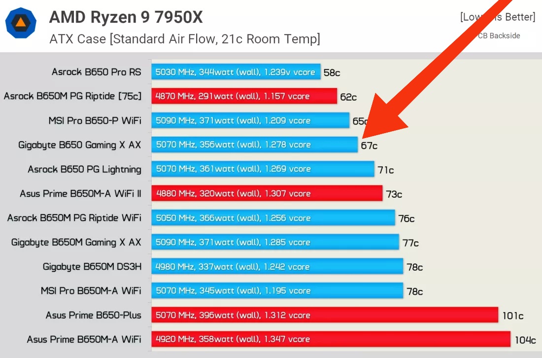

I don't understand why you think the vrm isn't good when the following shows it's very good ,
From review
For the stress test we're using the Ryzen 9 7950X and Cinebench R23 which was looped for an hour
And unlikely you'll be putting the same amount of stress that's worst case in this test even if you do it passes with flying colours

i resolved problem .... with X870E Nova form Asrock has 50C
now VRM has 35C my cpu idle now go 38C... its much better
50c to 67c isnt even that much difference when it's being stressed with cinebench for over a hour which you'll unlikely gonna do
The CPU temp improved because of cooler not motherboard, but it's your money
