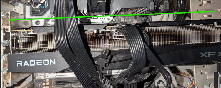

CPU Cooler Clearance Issues
Somethings just not making sense... If the OPs cooler fouls the GPU, then it would foul every GPU in in every build, and they wouldn't get very good reviews*
Yeah I know they are arguably overpriced, but still, if it litereally didn't fit properly they wouldn't get very far.
Is the Nvidia card out of spec? as in, does it sit higher up than it is supposed to?

Yeah there must be some confusion around the mounting hardware and the additional offset bracket.. That's all I can think of...
I mean if noctua were selling CPU coolers that fouled GPUs there would be a massive **** storm about it...

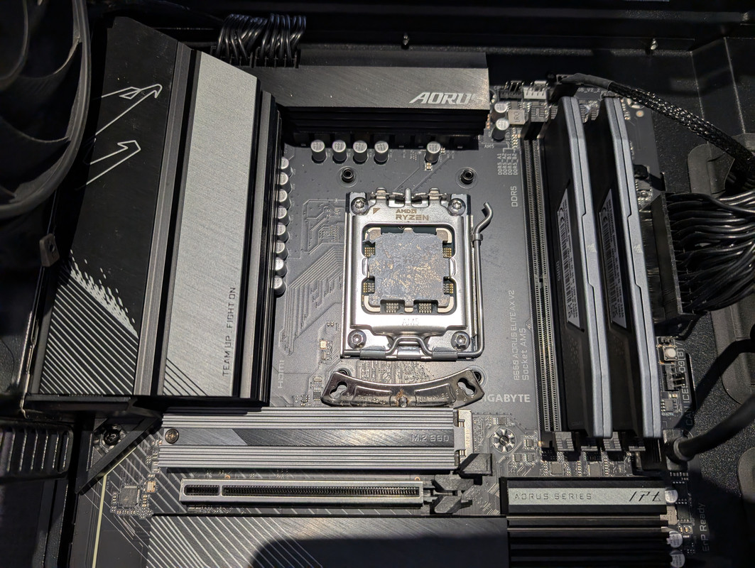

Sorry for the delayed reply, the joy of newborns! I have taken as many pictures as possible of the mounting, how I had it with the normal bracket and some additional pictures with the offset ones. From the looks of things they can only go in one orientation?

Try dry mounting it without paste, without the optional bracket, and see if you can mount the heat sink 180 degree's, upsidedown as it were, then do the same with the bracket - that way you don't waste paste, and will find out if there's a solution, then can use the paste once you've figured it out :)

Funnily enough I had the same thought and reached out to them yesterday, this was their response.
"If you would like to increase the distance between the CPU cooler and the GPU we would recommend adjusting the mounting configuration to not use the offset mounting option. However, we would not see a cause for concern as the pictures seem to indicate that the two components are not touching and therefore not interfering with each other."

So did you try it without the offset mounting, like I suggested? That should solve your problem :)
