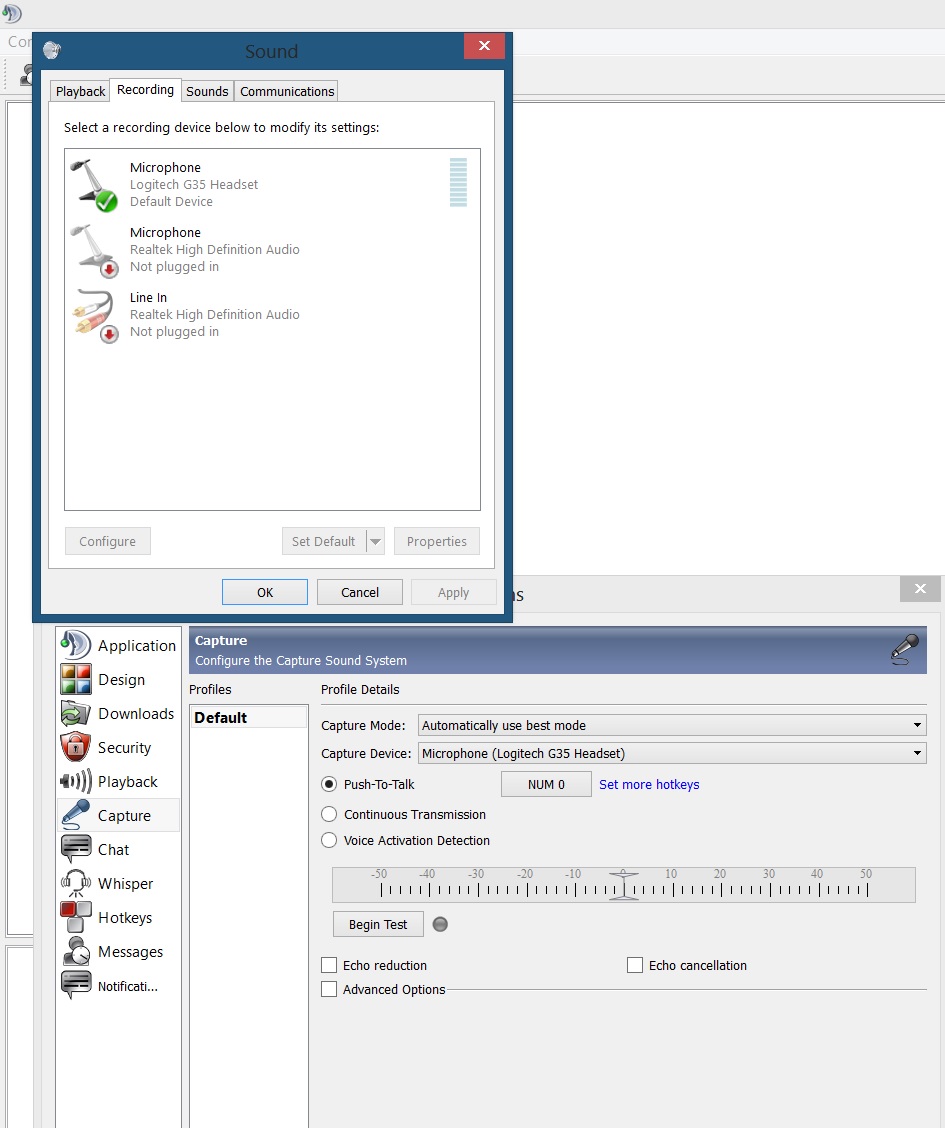

Its in Teamspeak and skype lol just cuts off. going to try reinstalling headset drivers
Worth a shot. I had to roll back to an earlier version of Logitech Gaming Software as the latest version kept causing my g35's game volume to change when alt tabbing or when a scene would change in a game. Going back to an older version fixed it.
Make sure you have your mic properly set in windows and TS as the default capture device. It has been known to change itself on occasion.
Something with Crossfire :( I have disabled that and everything is good. Enable it and mic and audio cuts off USB headset.

Ok sound issue I think was down to Driver 13.6 beta 2. Installed driver 13.4 and its worked fine so far.

Game runs horrible, switch it to single GPU and everything just works including mic and audio.
Why would Crossfire mess up my audio and mic switching them off?

I suspect the audio drivers are somehow messing with your mic in windows. Try doing a driver sweep as per the AMD thread. Reinstall the drivers but choose custom install and untick the HDMI drivers so they don't install. Use 13.6 beta 2 with cap 13.5.
