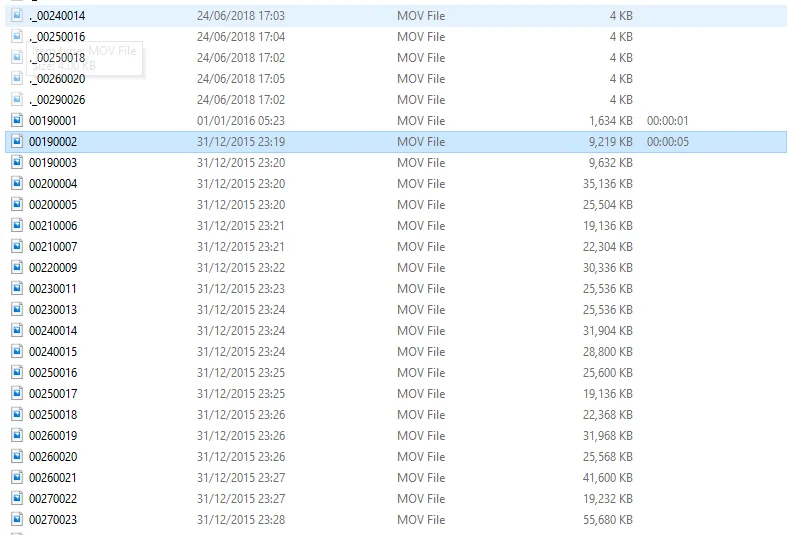

This is what I get using Windows media player on windows 10
The below is all I see, appears 2 of the files play for XX amount of seconds but the other fail
That just looks wrong. Why are all your files no longer than a minute in length? ( yeah I know you can set the interval, but 1min seems odd) Plus even though they all look like they are a minute or less, the files sizes are all over the place. My little VioFo uses MP4 file format, set to 3 minute time slices and all the files are the same size, give or take 1-2KB. Advice that came with camera was to format the card before use and to format it at intervals after that. (or are the files from 2015! the ones that work?)

That screen shot is from my windows laptop, and I formatted the SD card whilst it was in the device itself but good call

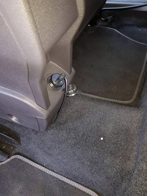

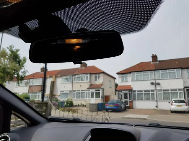

Picked up a Yi Mini Dashcam, the cable was perfect for running inside the A pillar, behind the glovebox and tucked in to the centre console so I could make use of the rear 12v socket. Handy as it'll start recording as soon as I unlock the car and the socket stays powered 15 mins after the car is locked. Can't even see if from the driver's seat. Overall, satisfied for £40.

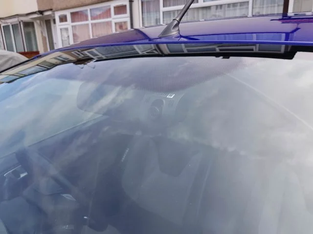

Quality is fine, I can pull numberplates from stills which is all you want really. It's pointed down as much as possible but still has a lot of sky, I've emailed them asking if they're making a mount with an angle which will point it down more for cars with raked screens.
