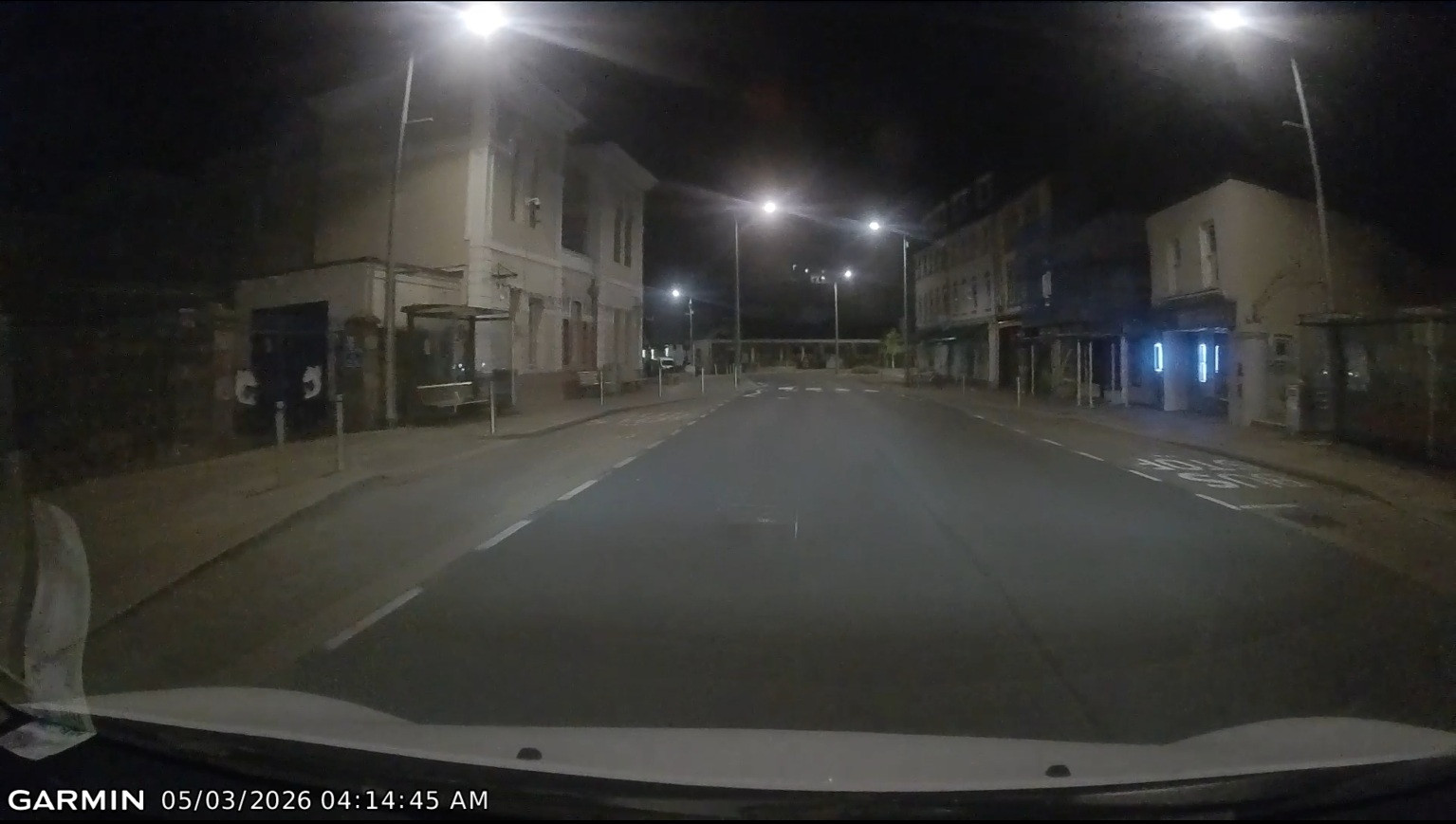

I've noticed with mine that the date and time were wrong when I made the recording above. According to Garmin support you need to charge the camera overnight at least once per month to maintain the supercapacitors clock...

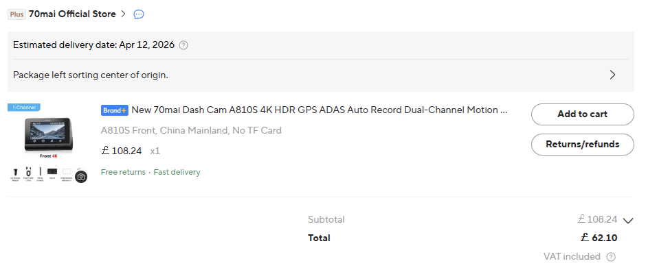

ok so i ordered the 70mai A810S
£62 squids delivered from china...pretty cheap considering. also got an aftermarket CPL filter for a fiver or so.

What do you think of the angle of my camera? Am I showing too much bonnet or just about right?
looks fine to me, if you did raise the height to reduce bonnet visibility you dont gain that much - only increased skyline.
I think having bonnet visible shows if anything actually hits etc, gives more of a depth guage - in my opinion anyway.
its perfect
if you raise it up, there be too much "light" hitting the lens, and camera will over compensate
also having more bonnet is better for depth perception and i think if someone was to ho hit your car, having that much bonnet is better than none at all
