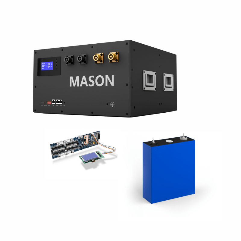

I wish to use a battery kit like this:
Which should give me over a 15kwh battery for about £1500.
I believe that I will then need a 5Kw Hybrid inverter, which I am shopping for currently. (I am budgeting as close to £1000 for the inverter+parts+sparky final connection/sign-off)
So, all in costs for the initial system would be around £2500, and the closest systems I can find online are all upwards for £7000 for similar systems without solar. So, pay-back would be much sooner!

That inverter and the pack you've linked aren't compatible (your pack is 48v and the inverter wants 80v - 480v), also it seems limited to 40 amps on the battery connection so to achieve 5kW charge/discharge from battery you'd need a pack around 125v. (Someone with more knowledge might find other things with the spec though, i'm not that knowledgable having only started looking into it recently)
I'm assuming you need full whack on importing to battery given your usage is around 25kWh a day, and you've speced a 14kWh pack. So it'll be emptied everyday and to fill it at night on the cheapest rates you'd need a good 3 hours at full pelt.

You'll want a hybrid inverter that's 48v nominal, which is roughly 42v to 56v. You also need to consider how flexible you want it to be, how easy it is to program to charge at certain times, to force discharge etc. Over the winter I earned £200 from saving sessions, last year my gas & electric bill was minus £400, this year it currently stands at £71 in total for gas, electric and standing charges. Rates are lower now so I won't be as profitable as last year. Oh, I also have a load of solar.
Another thing to consider, especially for a battery only system is how quick you can charge the batteries, I have 29kWh of storage and 8 kW inverter, so in the 3 hour flux window can only charge 24 kWh of energy or there about.
PS. I thoroughly recommend Victron, but you'll need a bigger budget.
@Malt_Vinegar make sure you check the DOD as well. The useable will be lower than the pack capacity, not sure if you know this, don't think I saw you mention it.
These batteries can be 100%, but its not worth it, there is so little stored energy at the upper and lower limits its just not worth stressing the cells for it. But its up to the user to set the limits in the inverter and the BMS. Cell voltages can range between a minimum of 2.5v up to a maximum of 3.65v, which for a 16 cell pack gives 40v to 58.4v operating range.
I have mine set to stop using the battery at 10% SOC unless there is a grid failure, but the hard limit is when the battery reaches 46v, which is 2.87v per cell, and I charge to 56.25v, which is 3.51563v per cell.
I'm not sure what my useable capacity is, never bothered testing it, but its lots :D
