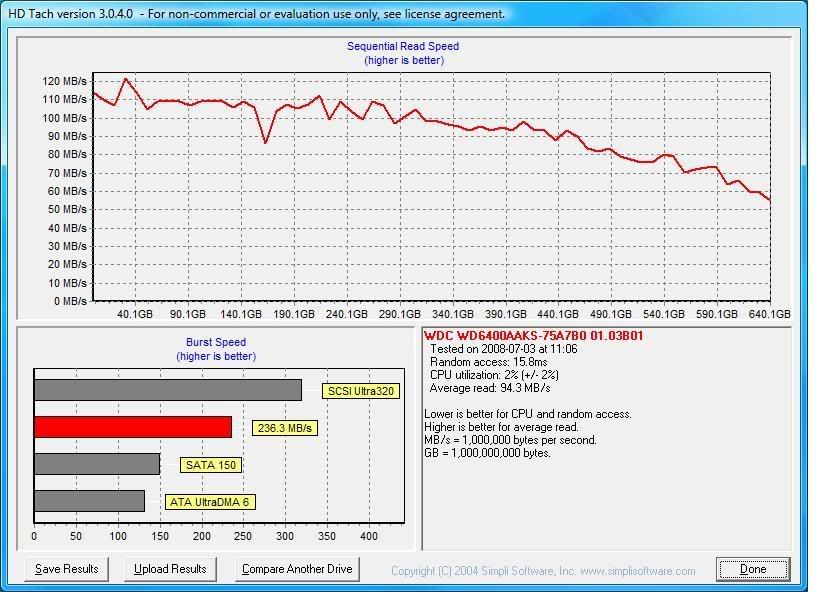

Just tested my HDD with AAM disabled using HDTach, and the seek time is still 15.8ms :confused:, bit slow is it not?
here is the long test: :confused:
