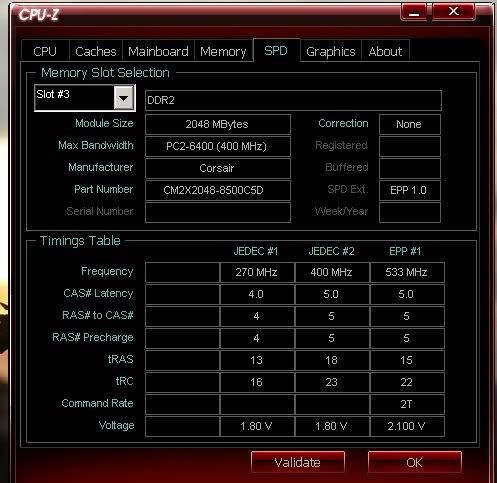

CPU-Z reports the following.
PART # --> CM2X2048 - 8500C5D -
there are 2 of these - one in slot 1 the other in slot 3.
TIMINGS--->
400MHz
5:6 FSB
5.0 CL
5 tRCD
5 tRP
18 tRAS
23 tRC
2T CR
Thank you for the help

The voltages for both are 2.0/2.1v (from googling) - but what does it say in the SPD tab?.
spd tab says...
edit --> validation link http://valid.canardpc.com/show_oc.php?id=1874339
Yep - the Kingston HyperX should be fine - identical spec.
No guarantee that they'll work of course (but they should) - if you run into problems trying to get all 4 sticks stable post back.

And according to your CPU-Z validation you're only running your existing RAM at 800MHz.
As above regarding OS.
I missed the frequency setting in your list - you are indeed runnig under spec.
You need to go into the BIOS and manually set your frequency, timings and voltage.

You need to set the frequency to 1066, the timings to 5 5 5 15 and the voltage to 2.1V (max) - you may be able to lower this setting later after testing.
