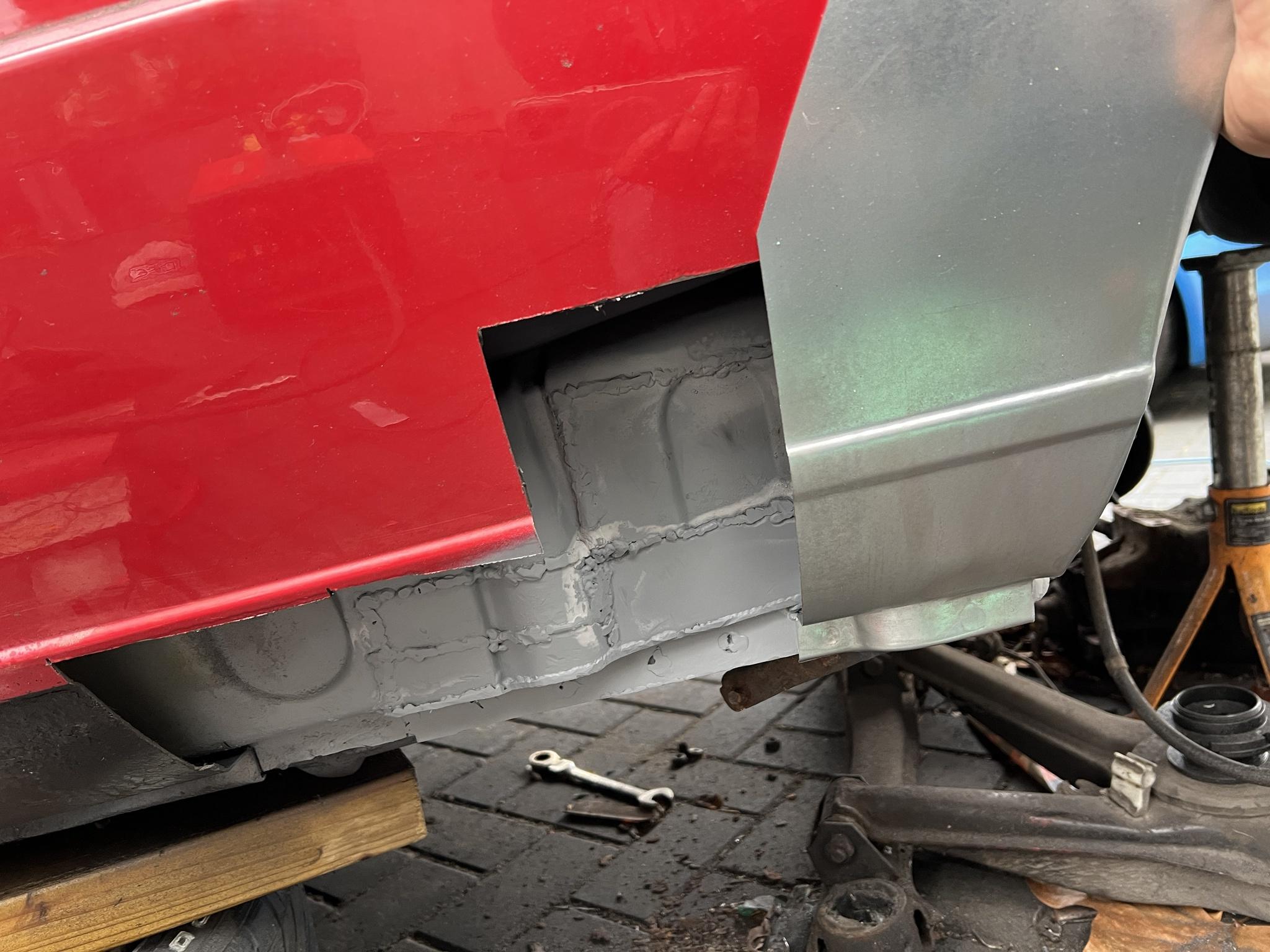

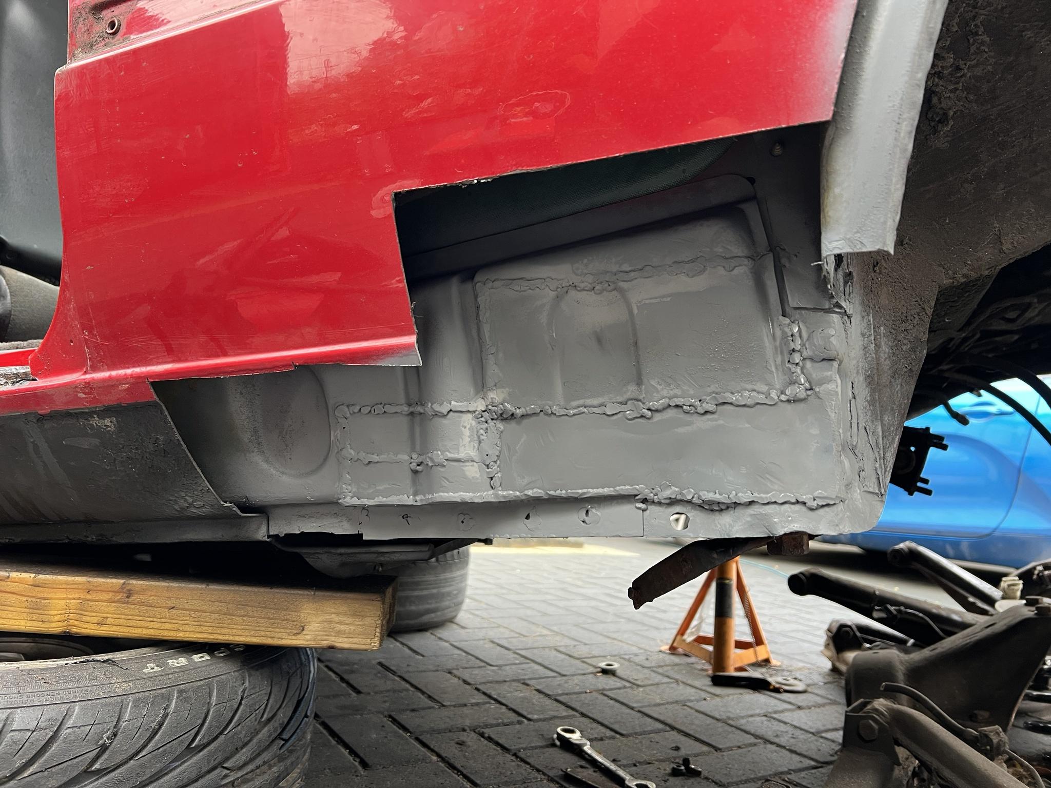

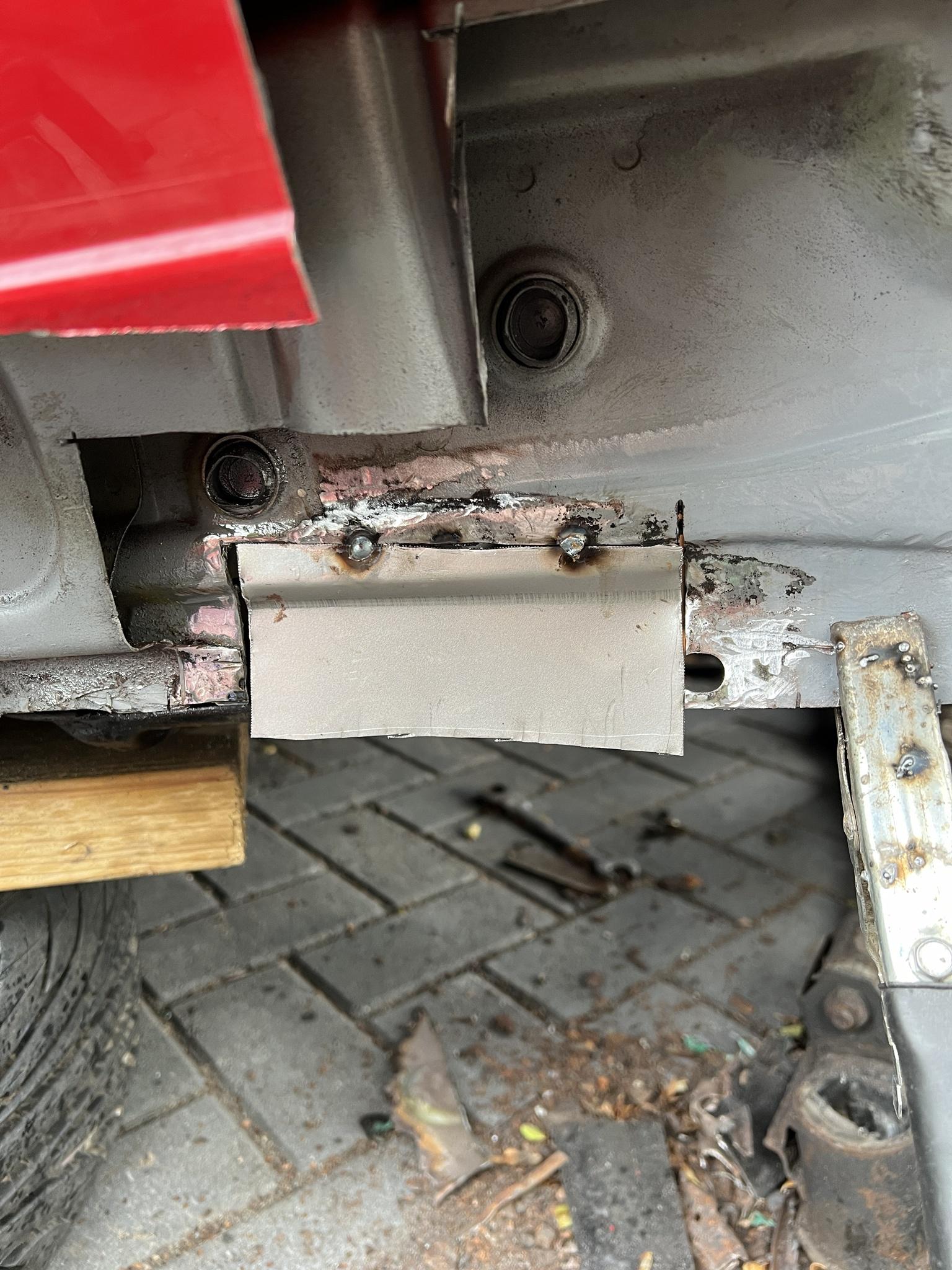

Finally got round to spending some proper time on the rear sills and made some progress. Not pretty given it’s all getting covered up but should be functional with a decently strong jacking point.
It’s three sheets of metal so had to build up bit by bit, a few too many individual bits where I was using what I could have the original panels. Possibly should have just made all new but prefer to keep my fabrication to a minimum where possible.

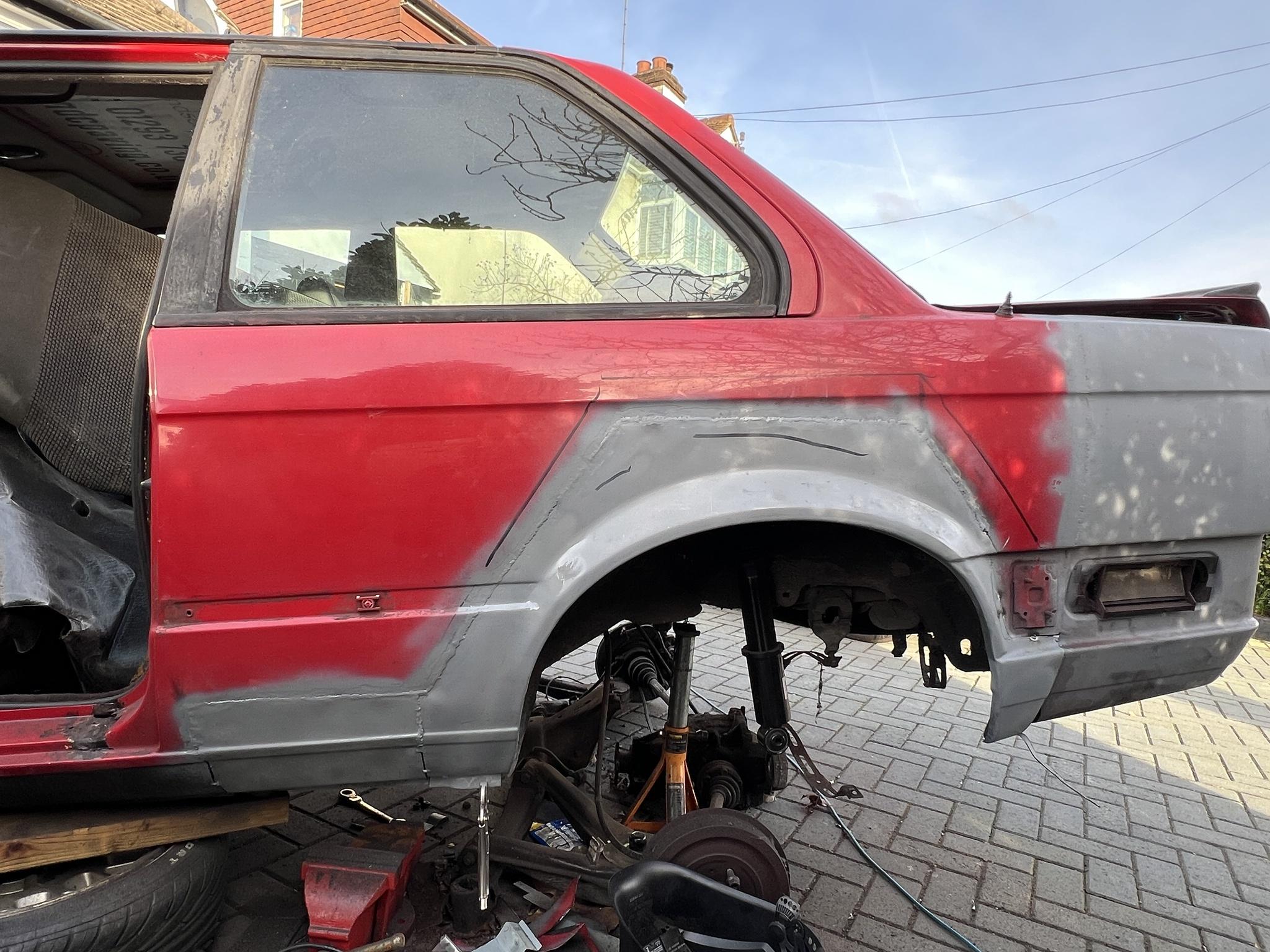

Mocked up at the bottom with the new arch. Just need to find the remaining panel gaps now.
good stuff, just slazz some sealer over it all and cavity wax the sill and she'll be good.

Once that was done concentrated on finishing of the passenger rear which included the boot pocket, got a new panel to weld in which required quite a bit of adjustement to fit properly, but got there in the end:
Once that was done it's all been seam sealed up and on to fibre glass filling all the panel welds:
Just need to do more work smoothing it off and then on to body filler, but quite pleased it's starting to come together and is back on the ground and mobile, even starting to consider MOT albeit a lot of bodywork to do first and not entirely sure whether to try and paint myself or send to a body shop.
