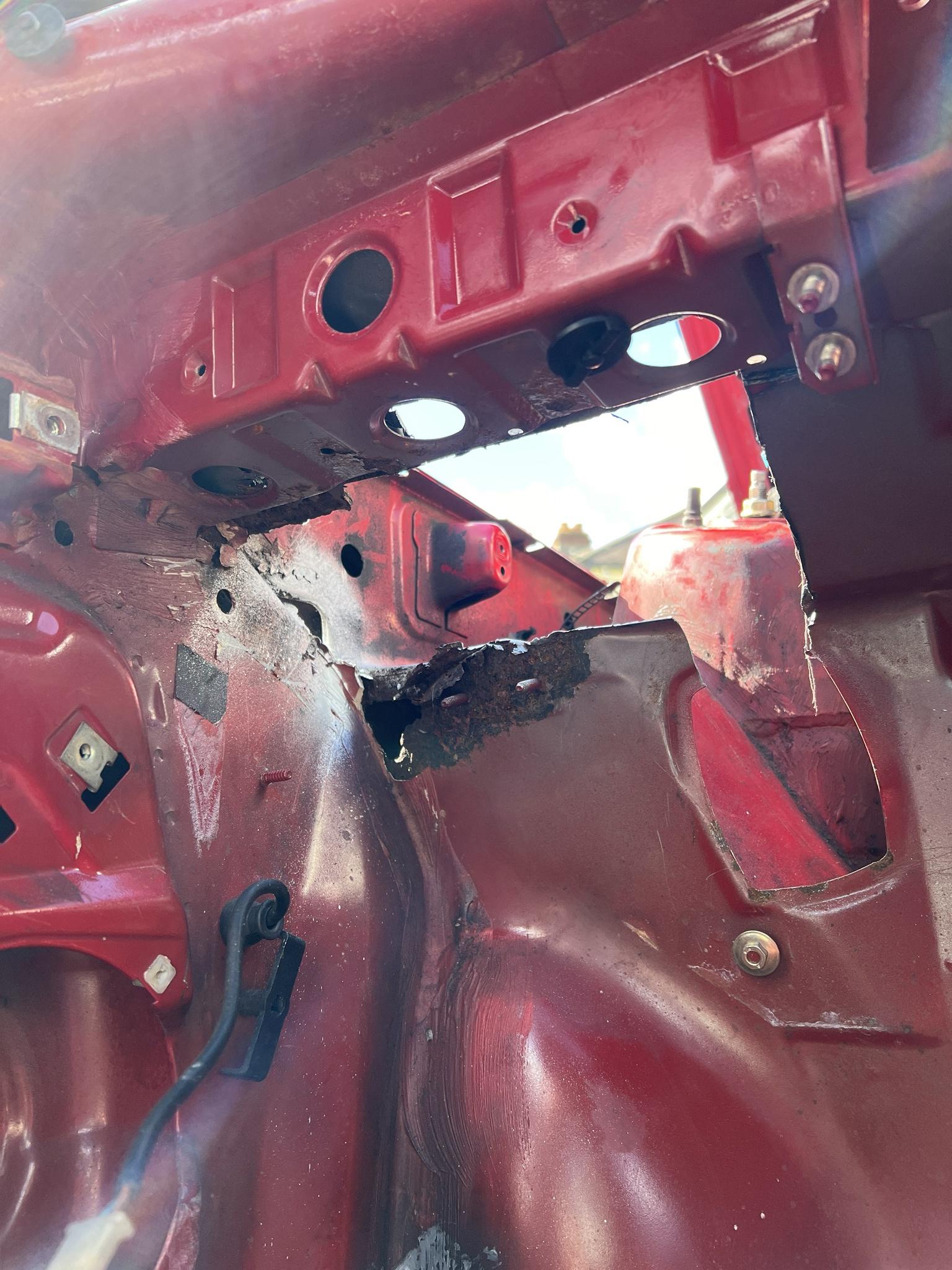

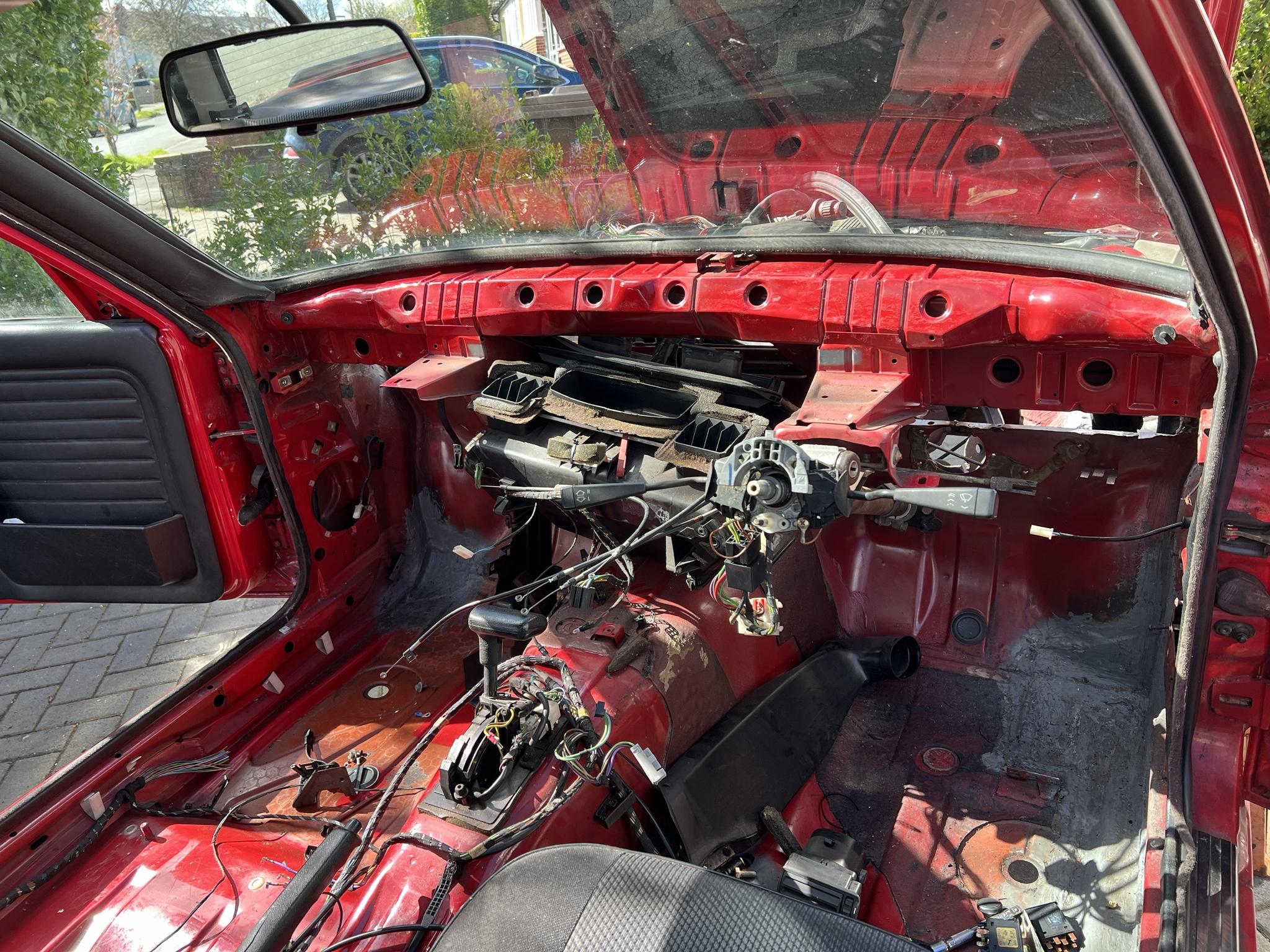

Well as ever things have escalated, Fuse box and battery tray have been completely cut out and ended up taking the dash and heater matrix out so I could get to all of it.
I also bought a complete battery tray replacement panel which is now welded in
And started replacing the metal on the other side.
