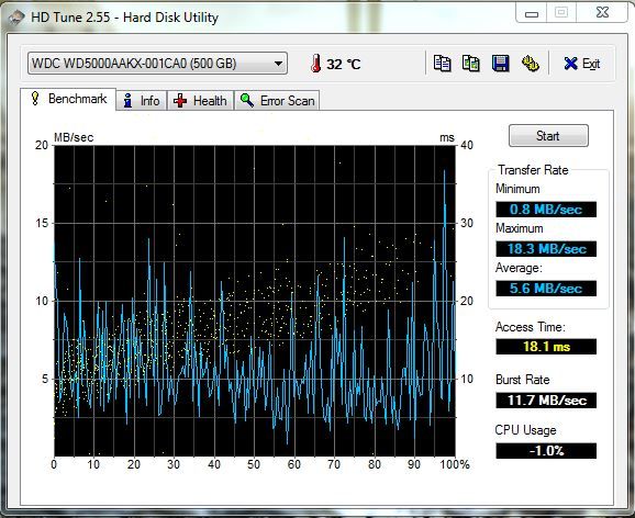

I just put my WD Blue 500GB HDD into an external dock (Icy Box IB-112StUS2-B) and used a PCI slot eSATA-SATA connected to the same SATA port on the mobo that the HDD used when connected internally and got ridiculously slow speeds.

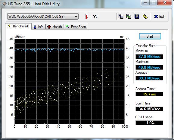

I then tried it via USB2 and load times are acceptable, but still noticeably a little slower than a direct sata-mobo connection.
Here are the HD Tune results for each:
eSATA:
USB2:
Any idea why it's this bad? I've tried two different esata cables and no change.

That is strange then. Check if there's anything accessing the disk when it's connected by eSATA (various sysinternals tools do this), though to be honst even if that's the case the average throughput would be higher.
Have you tried a different port and removing the controller in device manager then rebooting?
There might be an issue with your motherboard BIOS, it might be worth flashing to the latest BIOS and or updating the drivers for your boards controller.

Tbh, usb2 may not be the greatest connection in the world, but it's doing fine with games and media.
