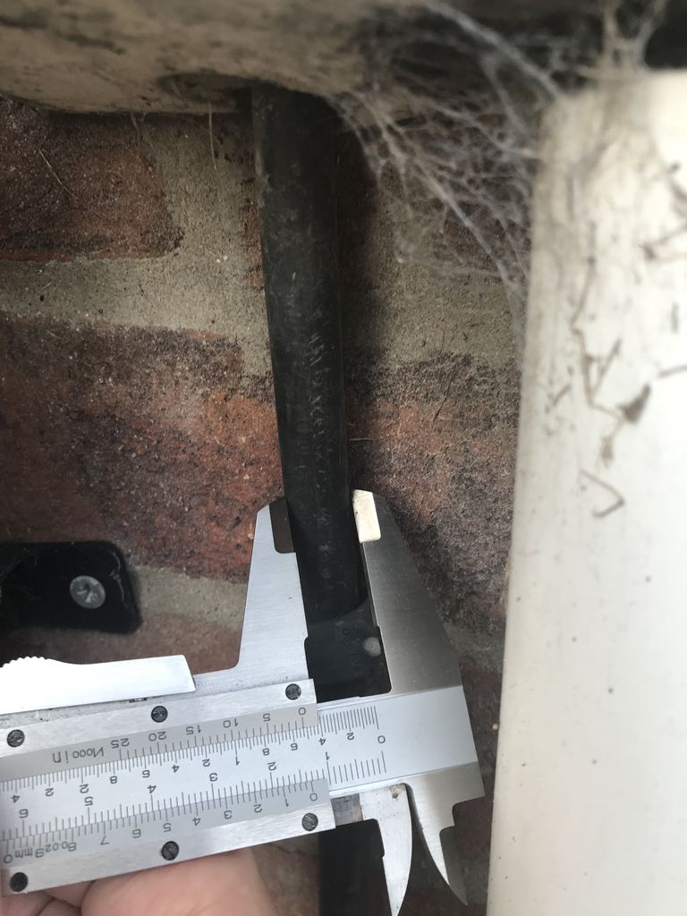

We've also have electric gates to the front of the house attached to its right hand side as you look at the front, which is why I'd prefer a charger around the back as I'll be keeping the car there, but I doubt if the feed would be suitable either as the cable looks thinner.
yes so (surprisingly - born) mine too was a 20A breaker on the main consumer unit and cable marked 2.5mm2 @ 13.2mm dia. (crummy iphone)
which also looking at screwfix site matches their cable dia.
