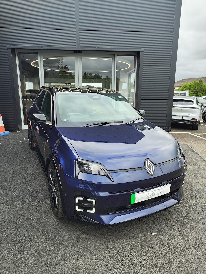

Ooh la la:
I wasn't expecting it until well into next month at least, but got the call on Tuesday to say it had just arrived and would be ready to collect today. Really happy with how the blue and gold combo turned out, and sort of compliments the yellow on the seats too. I think I know what I'll be doing this weekend. :D
It’s been almost 2 weeks. Still loving it? I can’t stop thinking about these damn things and I haven’t even drive one.
