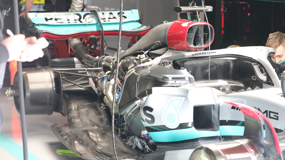

Given all the rumours I’m very interested to see the merc that turns up to testing. Sounds like they’ll have almost no sidepods. That’ll gain a huge amount of time. With talk about their radical new engine layout and side impact tests, it certainly fits the rumour.
A bit slow today Captain? ;)
I'm not so sure. From what I've seen it people have seen Scarb's tongue in cheek sketch of the Alpine with no real sidepods and combined it with the real Mercedes (which already has tiny sidepods). It's seems there's been a lot of confusion and leg pulling which has somehow converged in rumours that Mercedes are going to unveil a car that sounds like it breaks the laws of physics.
From the picture above it's hard to see how they could make the sidepods any more compact. Unless there's a gaping hole underneath where the PU ought to be, it's hard to see them being able to make it any slimmer. I'd love to believe it from a technical point of view, but I just can't see how it can be much smaller than it is already.
There's a reason why Williams and McLaren formed a similar shape to the Mercedes (if not quite as extreme), while Aston Martin obviously chose to make a bulkier-looking car for aero purposes (somewhat worryingly for them as while there are other bulky cars, none are like the Aston - with talk from the launch of them readying a 'B' car).

I'm not so sure. From what I've seen it people have seen Scarb's tongue in cheek sketch of the Alpine with no real sidepods and combined it with the real Mercedes (which already has tiny sidepods). It's seems there's been a lot of confusion and leg pulling which has somehow converged in rumours.
