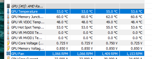

It's zero rpm below 50c, but during desktop usage it seems to be getting up and around that often enough to turn on.

Not installed the Aorus engine ..? I just use that instead of MSI as it works for Aorus/Gigabyte cards .
Is odd your card is reaching above 60c for light loads. What was setting in Adrenalin?

For light loads it was between 48-55c which meant the fans kick in and those are more audible than my low RPM Noctuas and pump.
I think the threshold is 55c for the fans, but it doesn't shut off immediately, so in a lot of cases it will go to 55c and turn the fans on for a minute, even if it drops back to 53c.
Replying to a message on WhatsApp desktop and fans kick in.
Could probably fix this by increasing front fan speed but that isn't something I would want to do in a quiet system when doing desktop duties.
