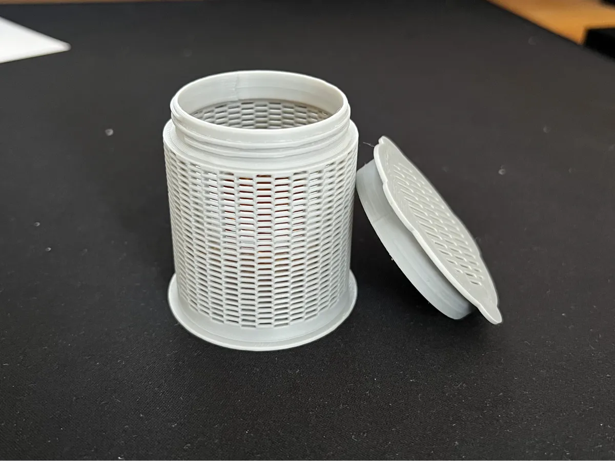

I'm using the cereal boxes as well, with silica beads in these
https://images2.~imgbox~/ae/b5/Q2Yv6XW1_o.png
