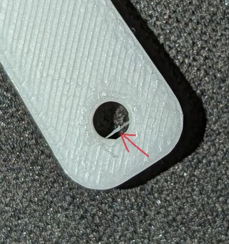

I just use the Bambu PLA basic profile, I have not noticed any more stringing than usual. If it's light cobweb strings I just to a very short burst with a mini blow torch (the small kind they use for desserts).

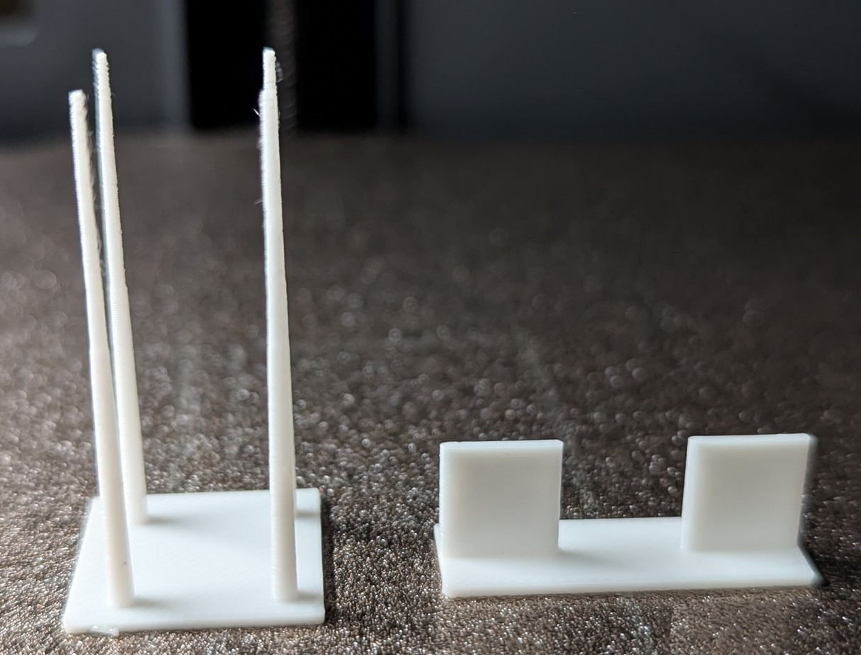

I ran this retraction/stringing test and I realise now that the photo isn't the best, but you can still see it stringing at the top.
I'm gonna stick the filament in a dryer and see if that helps.
