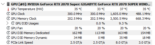

So this is after a fairly typical session of gaming. I've been fiddling and tinkering with all manner of stuff and it's behaving itself now, I'm just waiting for it to catch fire or brick itself or something. Cheers for all the help folks!

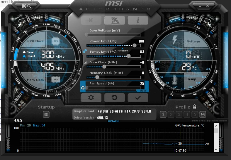

Ok this is seriously doing my head in now. This morning the fans ramped up again, so I rebooted the PC. As soon as Windows fires up, back on to full speed. Tried changing the fan speed in Afterburner, completely unresponsive. Temps are low, load is low, yet these fans are going nuts.

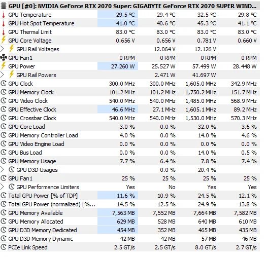

Current status, I don't think Afterburner's fan speeds are displaying correctly:

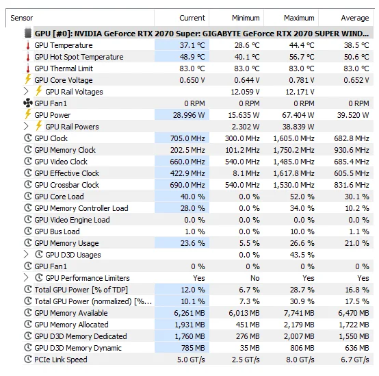

And according to HWInfo, the fans are also at 25%:
I've confirmed it's not the CPU fan that's making the noise, and I've also confirmed that all three fans on the GPU are running.

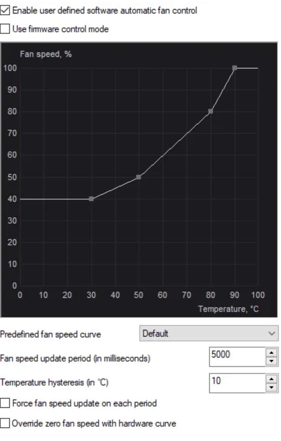

Are you actually setting an override fan curve on afterburner? Go into the settings and check. That slider is not the setting you’re after.
You want to be tweaking it here:
Also, although I doubt this is the problem, do double check that you’re not closing MSI afterburner - it should be showing in the system tray.
