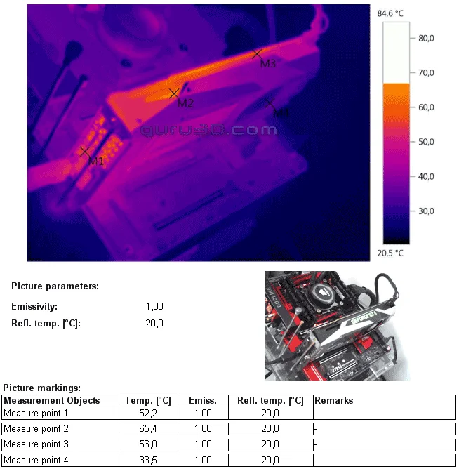

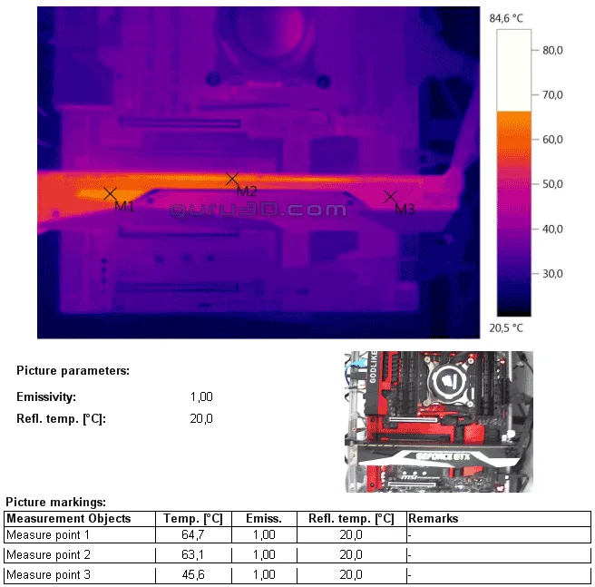

Just checked Asus, Gigabyte, EVGA and MSI comparisons for VRM of the 1070's and the Gigabyte runs the coldest out of all of them.
In order of best cooling overall, including the VRMs.
1. Gigabyte GeForce GTX 1070 G1 GAMING >> http://www.guru3d.com/articles_pages/gigabyte_geforce_gtx_1070_g1_gaming_review,10.html
2. ASUS GeForce GTX 1070 STRIX Gaming >> http://www.guru3d.com/articles_pages/asus_geforce_gtx_1070_strix_gaming_review,10.html
3. MSI GeForce GTX 1070 Gaming Z >> http://www.guru3d.com/articles_pages/msi_geforce_gtx_1070_gaming_z_review,9.html
4. EVGA GeForce GTX 1070 SC Gaming >> http://www.guru3d.com/articles_pages/evga_geforce_gtx_1070_sc_superclocked_gaming_review,10.html
