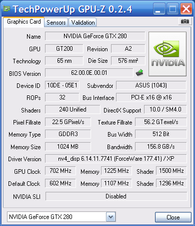

Not a bad oc,havent pushed it any further yet.
Idle temps are 50c and seen it go as high as 83c under load.
Running a Q9450 at 3.4GHz under Vista64 with the Physx drivers installed:
