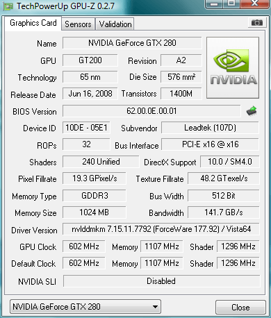

Have you done some bios tinkering as them default clocks looks different to what's stated on the link...
I know. Got the OC version of the card today. Bought what I thought was the card in the link but ended up with the OC version, which was nice. The whole batch must be like it.

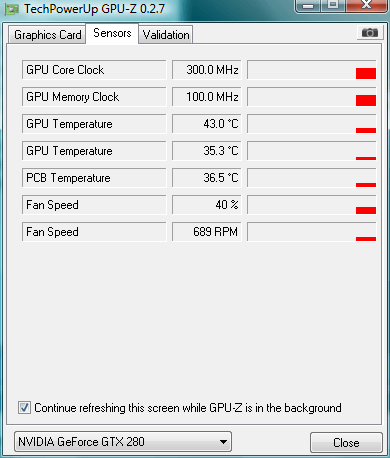

Just got a 280, wonder if someone can shed light on the core and memory clock values under the sensor part. Is that a bug within GPUz?
The card has three clocks, idle, low 3d and full. Those are the idle clocks, run a game and fire back to GPUz and it will (should) show the increase to the 3d clocks.
