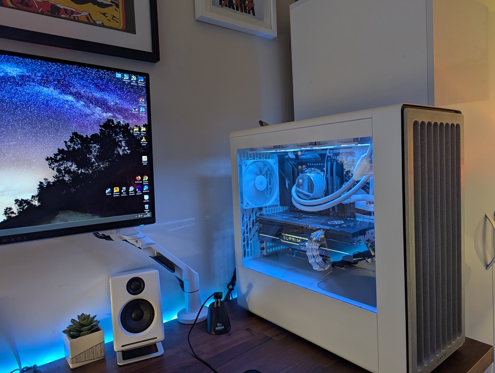

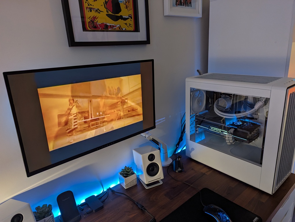

Well, i've just finished transferring my Lancool 2 PC into the new HAVN 360 flow case. It actually took about four hours, including tea and lunch breaks. Anyone who knows me knows that I have quite bad autism and various physical problems, so I don't think I did too bad.
I did decide to not use my Arctic fans on the Thermalright AIO and instead use the original Thermalright RGB fans, which didn't go well. I thought I wired them all up correctly and connected them to the 5v on the motherboard, but when I switched on the PSU I head electrical crackling for a second so immediately switched it back off. As the RBG connection to the motherboard was the only thing 'new' I disconnected this and with fingers crossed switched the PSU back on and pressed the power button on the case. It thankfully booted, and I went into the bios to check temps and adjust fan speeds. The Thermalright fans are quieter than the previous Arctic fans that I used on the Thermalright AIO and the HAVN fans have noticebly very effective airflow and are reasonably quiet as well. I can now, though, hear the Thermalright AIO pump which I didn't before and find it to be a bit of an annoying tone/noise.
Although I found the cable channels useful, I would have liked a few holes spread about for zip tying awkward SATA and fan cables etc. I really don't like the pull tab thingy at the top of the case for assisting removing the top panel - not necessary and looks a bit stupid imo.
Overall, I think it is a very well-made case with good QC and design. The front fans are very effective and sensibly quiet. I'm not sure if it is worth the £169.99 price tag, but it does include the three fans, so maybe it's priced about right in the current market.
I've managed to sort the rgb fans on the AIO finally (I say RGB but i've actually just set them to white). It sets off the case nicely imo.

Looks great @malccy! I keep meaning to post pictures of mine. What monitor arm is that you are using? :)
I wish I could answer that, but I bought it years ago from Ebay, and it was in a plain brown box with no name. It's not hydraulic but simply a swing arm affair.
