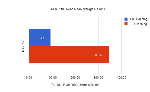

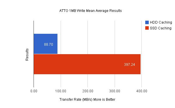

The next test was carried out using the ATTO benchmark, I would run a 1MB read and write test and compare the mean average MB/s transfer speeds with and without SSD caching.

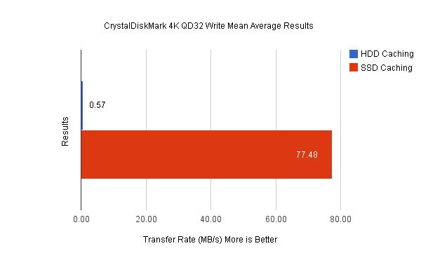

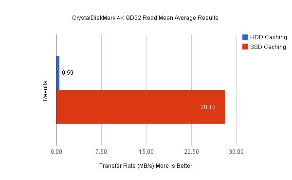

Finally I would carry out a 4K QD32 read and write test using CrystalDiskMark and compare the average MB/s transfer rates, again both with and without SSD caching. At the end of all this testing I would have a good idea of the performance gains the OCZ Synapse Caching SSD was giving me.

After a lot of typing its finally time to reveal the results, so I’ll let the graphs do the talking:

ATTO Benchmarking Read/Write 1MB Test
CrystalDiskMark Read/Write 4K QD32 Test

As you can see from my results above adding the OCZ Synapse Caching SSD to your system will utterly destroy a HDD in terms of transfer speed. Windows boot up time is also greatly improved, with the Synapse enabled I managed to shave 11.68 seconds off my boot times. The ATTO benchmark was the most telling however, with SSD Caching my average 1MB write transfer rate increased by 308.54MB/s that is mind blowing! I expected the Synapse to give me a performance boost, but not to that degree.
So it looks as though OCZ's SSD caching solution is a pretty awesome option for people who don't have access to SRT. It greatly improves both read and write transfer speeds, opens programs noticeable faster and doesn't cost the earth. Interestingly I have also experience the aforementioned long wait after my system blue screened, however I was forced to wait about 15 minutes while the Synapse rebuilt its cache as opposed to the 8 hours some people reported. I'm not sure if that was a issue with the older versions of the Dataplex software but I'm running build 1.1.0.9 and as I said I didn't have to wait too long.
