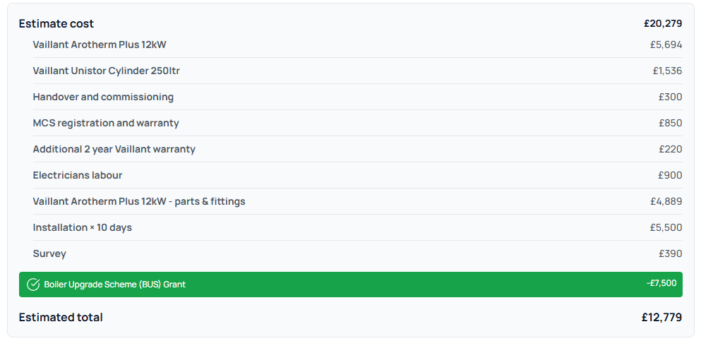

So I got a quote for my 4 bed semi (126sqm). Came in at £7500. Seems a bit on the expensive side considering they are saying as little as £500. Sure that is probably for a relatively new build smaller house, but still.
Epc shows we need around 20,000 kWh per year for heating.
Only insulation is in the loft which was done about 10 years ago or something, but is not 200mm I don't think. Walls are solid brick, no cavity.
At that price I feel it is best to stick with gas for a while longer.
I suspect you will require a relatively large HP, large HWC and almost all of your rads will be changed plus more to be able to get the energy in the house. This quickly adds to the install costs.
That's quite a high quote from Octopus, effectively a £15k install pre-grant. That said I will not pretend to know what they take in to account, their pricing seems to have an air of randomness to it sometimes. But as others have said, 20,000kwh/year on the EPC is large.

do they show you a break out - with hardware and labour to appraise it's accuracy ... like , are they replacing a hwt, radiators, their piping, how much the geography of the house and location of the components (long runs) impact the cost ?
No they have not seen the house, the quote is an estimate pending survey.
They usually stick to their quoted price but the price only covers fitting the heat pump, cylinder, pipework to and from the HP/cylinder, radiator swaps and electrics. Anything else needed on top of that is extra (e.g. structural surveys if required).
They don't break down the quote anyway even if you wanted it. When I priced up the main pieces of equipment, it came to half the bill and they had 5 people working on the job for a week - there is no way they made money on the job.
