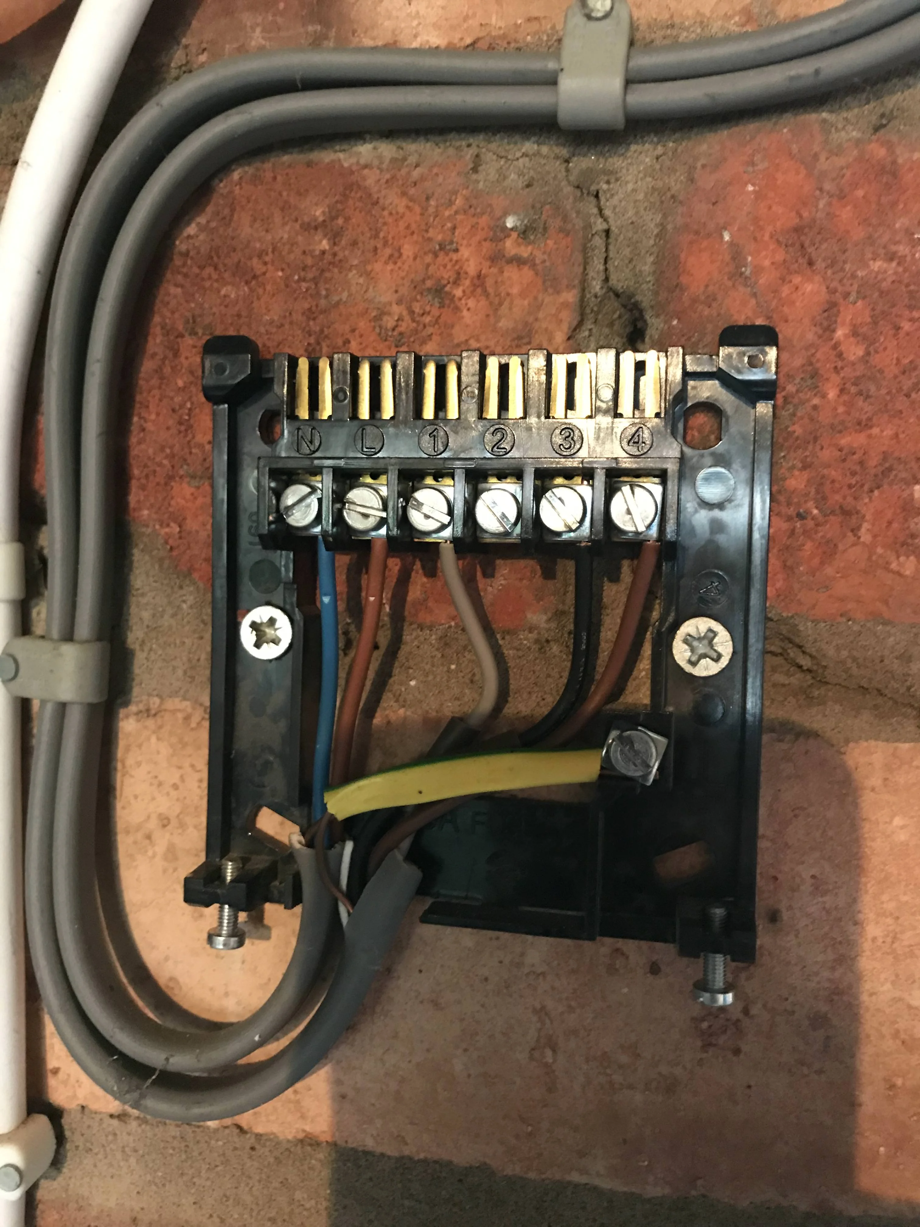

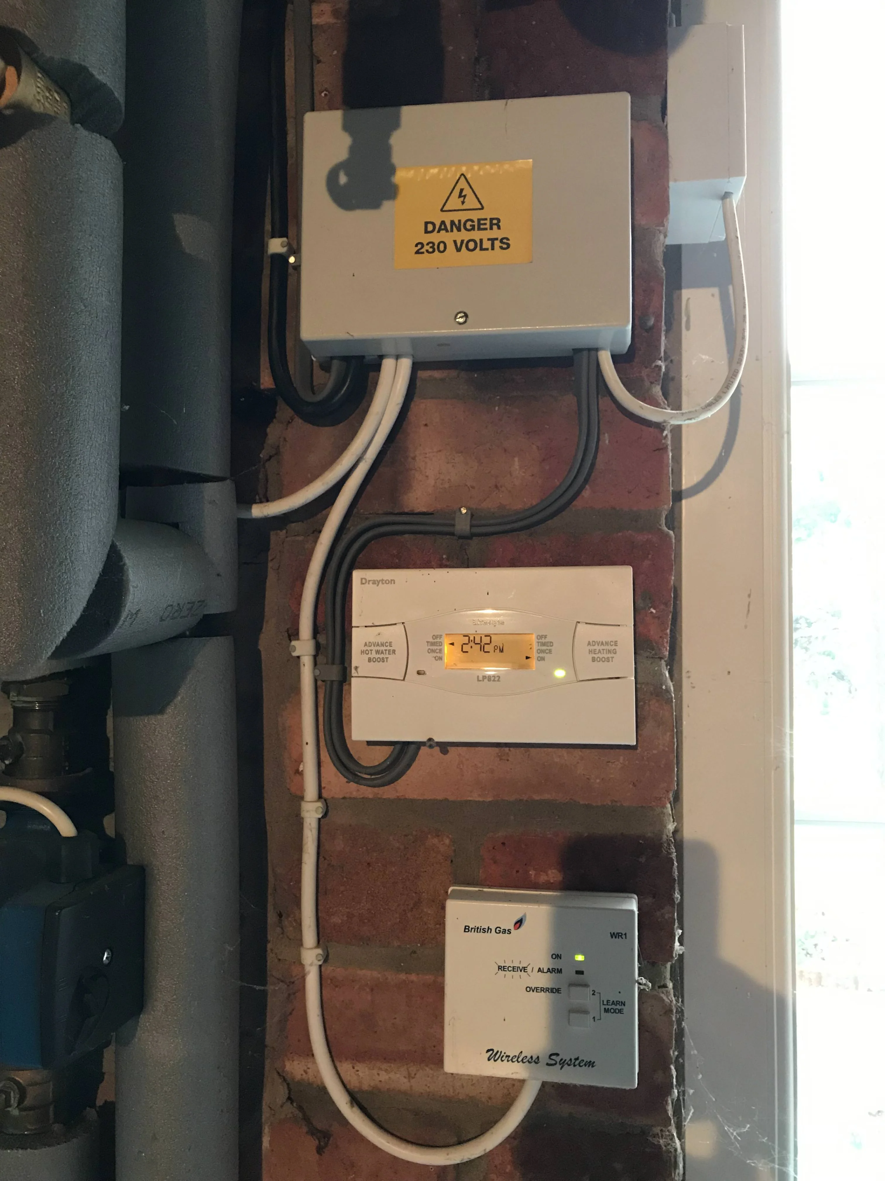

I understand the dual channel receiver is a straight swap for the Drayton LP822, I know I need to remove the wiring for the WR1 from junction box but I don't know if I need to make any other changes within the junction box for it to work.

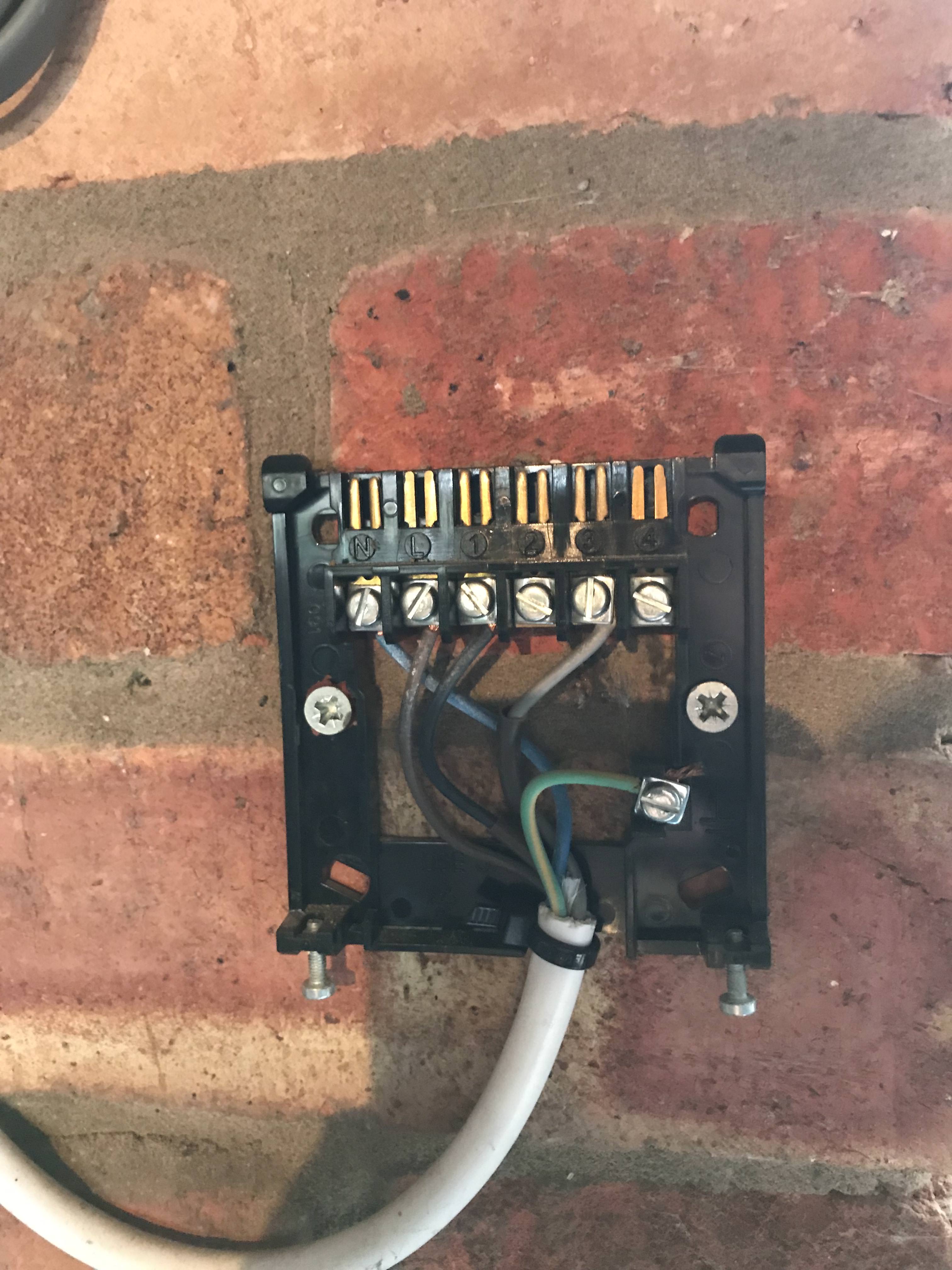

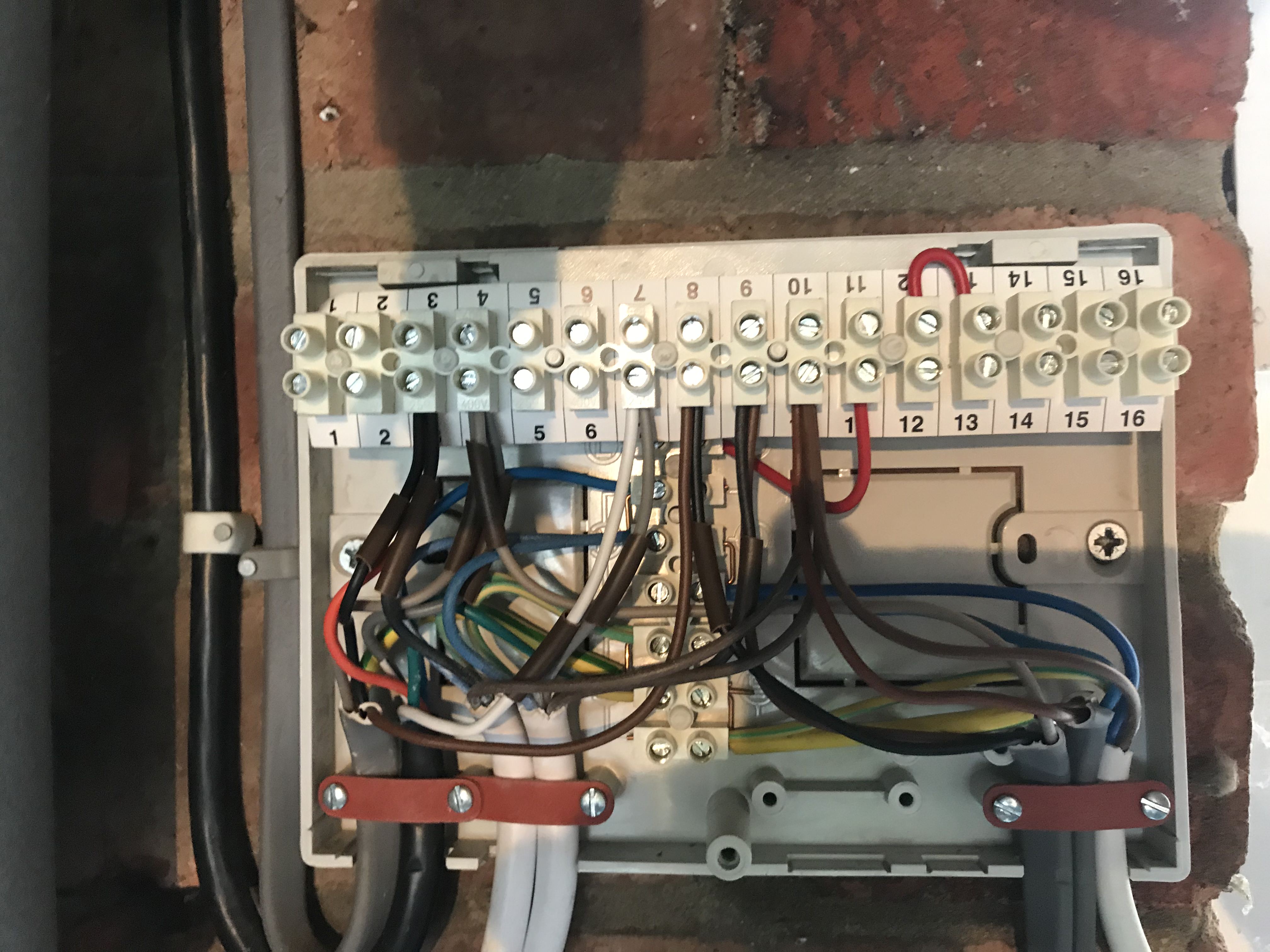

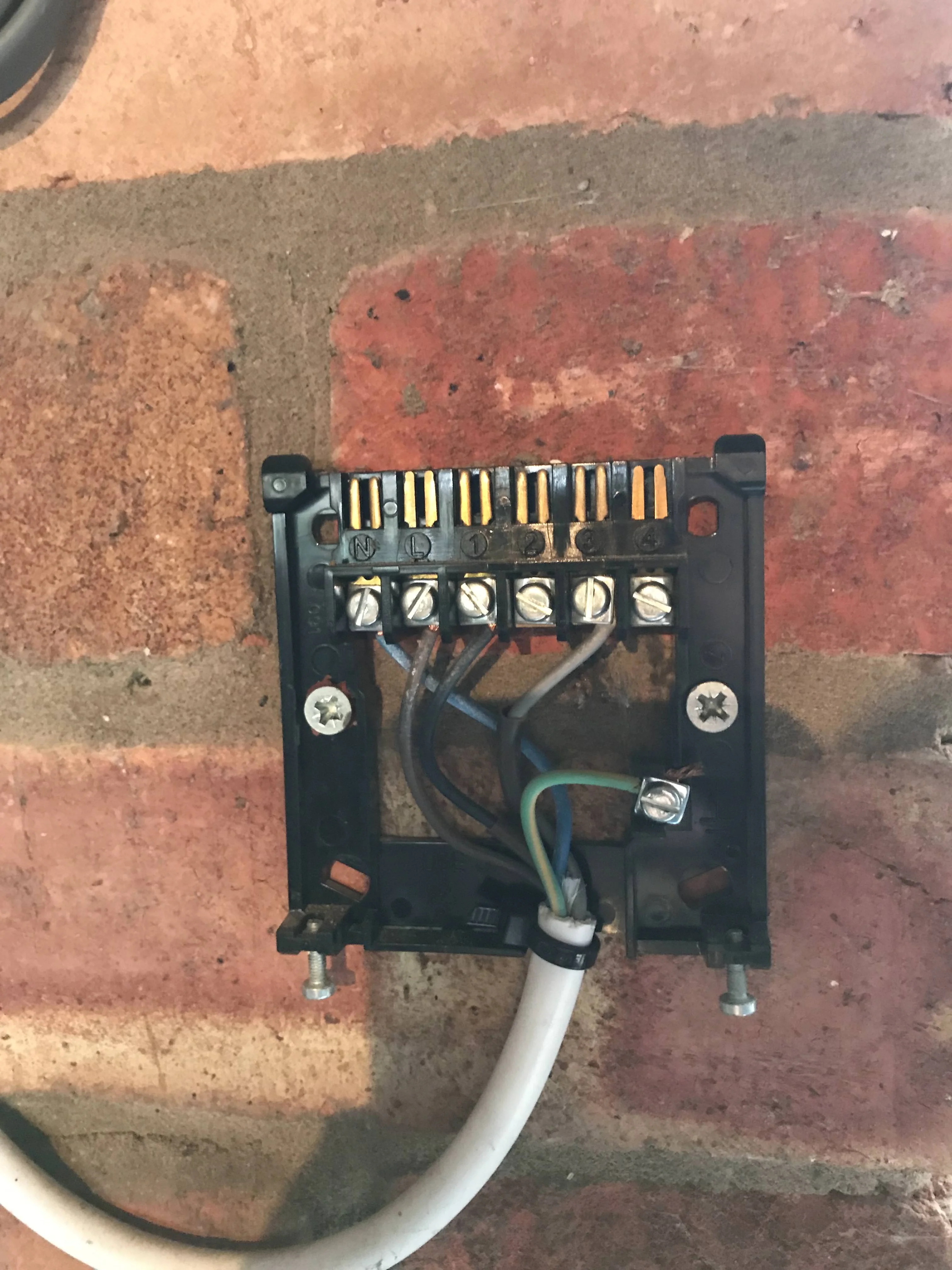

Hello I am new on here so apologies if I have jumped in or breached any etiquette. I am wanting to installa hive thermostat I currently have a wired Siemens receiver which works off a wireless thermostat I am hoping it would be a straight swop. The current system has a live neutral and a switch wire back to the boiler, with the common linked from the live feed inside the receiver.. my question is could I do a straight swop without any additional wiring or having to alter the wiring at the boiler end... thanks
i had the same receiver and it was a straight swap - very easy
is that your thermostat 5cm from the receiver???
Was this in reply to my pictures?
If it was then no, there's the programmer and receiver one above the other.
Which the Hive receiver replaces the programmer and the old receiver needs removing. Just not sure if it will work just by removing the receiver cabling.
yes
bin the porgrammer
replace the wiring wall plate with the hive one - wiring should be the very similar if not the same from memory and job done

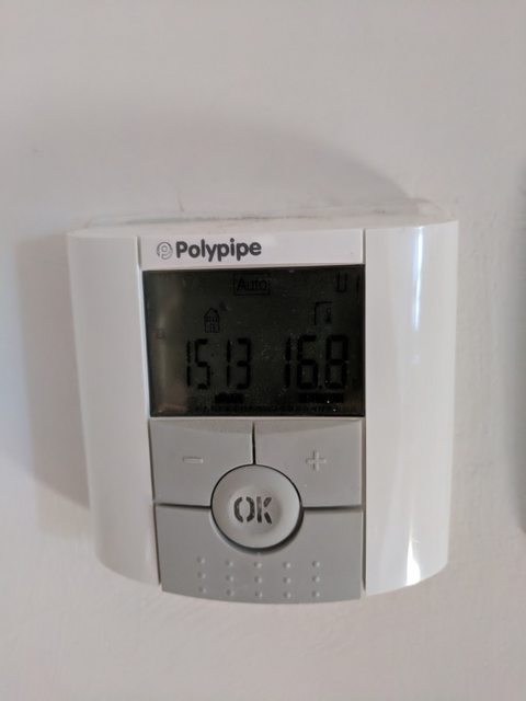

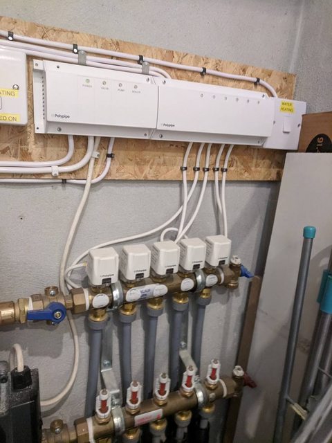

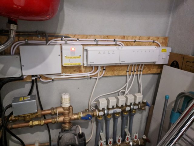

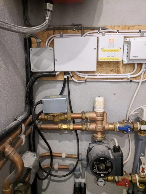

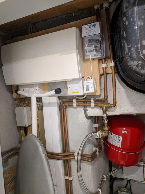

Hi guys,
I've been reading this thread and it's started to sink in how little I understand my hot water/underfloor heating setup. So what I've done is take photos in the vain hope you kind people will let me know if I can or cant enjoy something slightly more intelligent than the god awful thermostats I currently look at but cannot get to work.....
any and all help and assistance is very much appreciated in advance:
