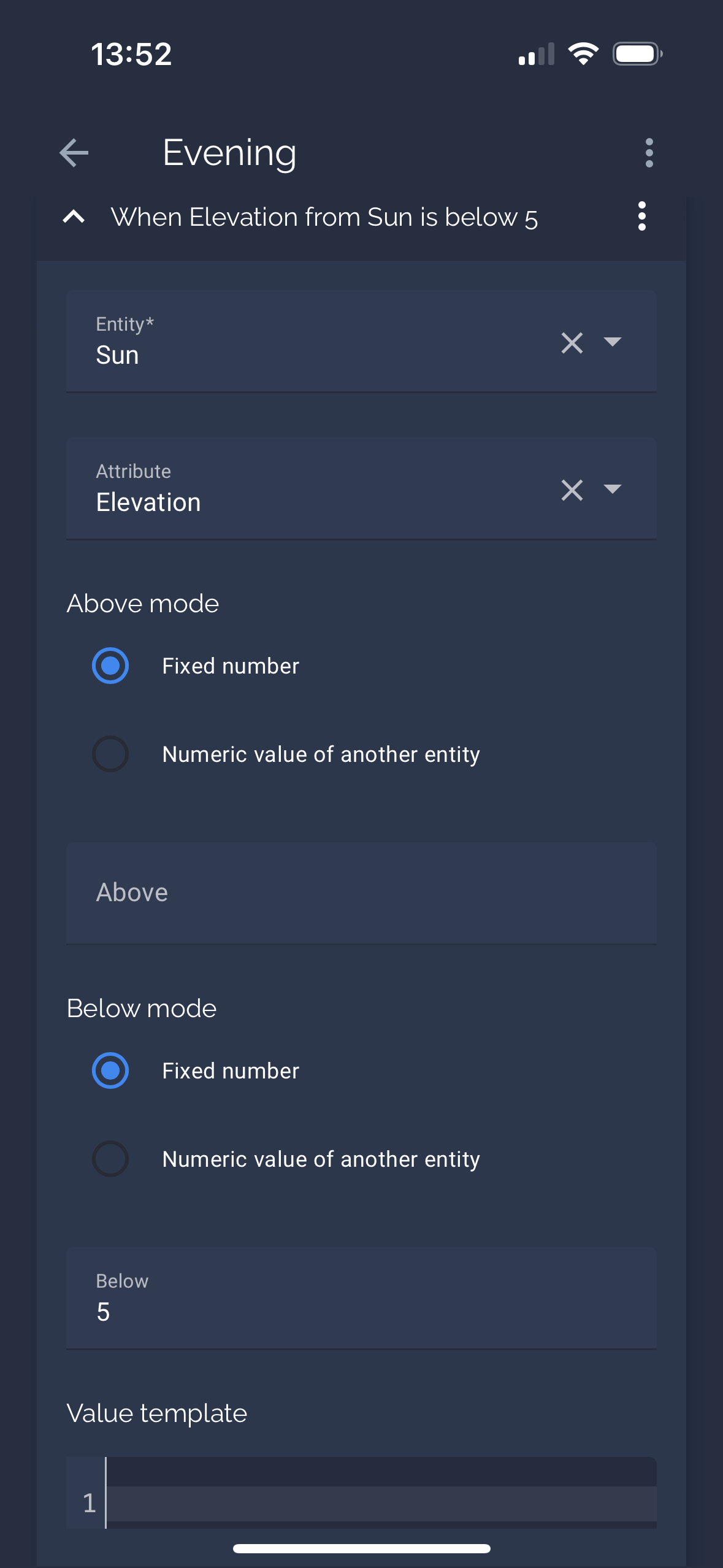

hi looking for some help with lighting automations, coming from HK and i moved everything to HA, set up a zigbee network and the only thing i am stuck at is sunset/sunrise dimmable lighting with motion sensors, as a work around i am using timed rather than sun, but would like to have it on at sunset and off at sunrise ?
I use sun elevation for mine. 5 degrees triggers it a little before sunset.
