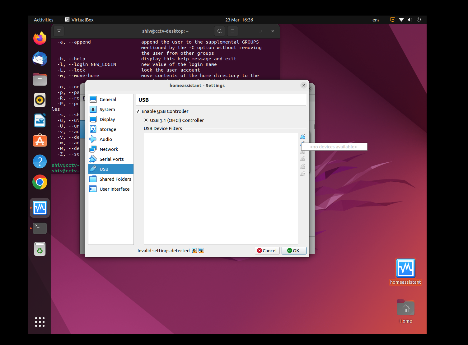

I'm using a NUC with ubuntu for this virtualbox VM, but I can't seem to detect any USB devices (looking for the zigbee stick)
Any ideas?
Is the zigbee stick detected by Ubuntu?
Yeah, all sorted now I think....

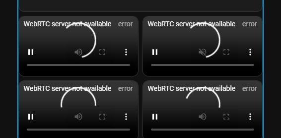

Next issue is the WebRTC server app - RTSP stream no longer working on the virtual machine, it was working fine on the Rasp Pi to access my hikvision cameras. It says "WebRTC server not available"
HA very odd sometimes, did a load of uninstalling restarting and it's back to business..
Now the NUC can't handle showing HA dashboard with 4 rtsp streams and running HA (system just locks up) so hopefully some more ram will sort it :/
