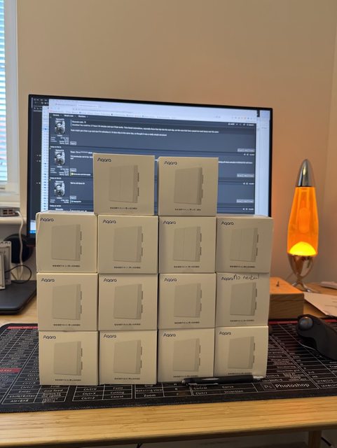

I bought a few(!) Aqara light switches from AliExpress.
I fitted a two single switches ok and then hit the problems.
Tried to fit a single switch that was one of a two way pair (bottom switch for the landing light).
Despite me trying all the wiring combinations I could think of, I couldn’t get it to work properly, either the light only worked on one switch or neither worked.
Doesn’t look like the switches work in a 2 way setup, so might have to change one of them to a purely wireless one, which will control the one that’s wired in.
Then went to fit the 3 way one in the kitchen, but it’s a shallow back box and the switch doesn’t fit :(
I’ve got an electrician coming on Monday to do some other work, will have to pick his brains.
