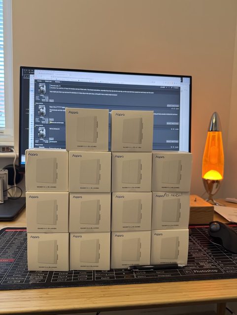

I bought a few(!) Aqara light switches from AliExpress.
