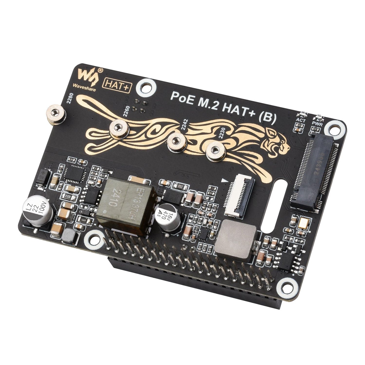

PI5 4gb and POE HAT £72 plus a cheap case. Thats all i would need i think. I want it separate from my server or id install it on my NUC but thats running Plex on Windows.
It’s cheaper than the dedicated Green hardware. I just dont want something thats only just fast enough for it and leaves me no upgrade path.
That spec will be more than enough for HA. I’d add a cheap SSD and enclosure to that shopping list as the SD card WILL fail given time. HA records a lot of data, making constant writes to the SD card.
That’s precisely my point regarding a PI though, by the time you have added an SSD and enclosure or an NVME hat, because home assistant will eventually burn out an SD card, you are basically at mini PC levels of cost.
Don’t get me wrong the PI will do a fine job, they just aren’t cheap like they used to be and you can get a lot more hardware for your money elsewhere.
Those N100/N150 mini PCs run at like 6w at idle so power consumption is decent also.
So maybe this one would be better, Poe and m.2?
Yes, definitely IMO. Even if you don’t get an SSD right away, you will eventually because a standard SD card will die.
A high endurance card will last a bit longer but the constant small writes trash them pretty quickly still.
Edit: The SSD doesn’t need to be fast or fancy, I think a PI is only PCIE gen 2 with a single lane so almost any good quality SSD will do.
