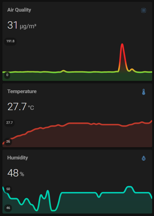

Thought i'd update as a couple of projects i've been working on have finished.
Ikea recently released a "dumb" low powered air quality monitoring device. Someone decided it would be great to capture the data and import into HA. This is done through a esp8266 (esp32 can probably be used as well, but is typically on a bigger board than the esp8266 and there's not huge amounts of space inside the enclosure.
I also added a DHT11 sensor to provide temperature and humidity readings, as these are tiny.
Graphed data:
