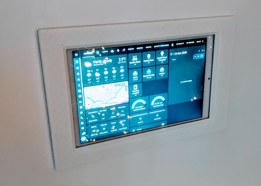

Yes of course, quick photo below.
This one has an Amazon Fire 10 inside. Made a wall mount that sits flush with the wall and has 5mm magnets in 8 or so places that clip the front frame to it really neatly (means I can easily pull out the tablet if I needed to). Reckon the cost of filament / printing was around £2-3 vs your Vidabox mount..... ;)
Happy to print one for you if you were doing it again...! Although for £100 a pop you could get yourself a decent 3d printer for a few of those!
I've kept the sensor on the right uncovered as I use that to display a screensaver of family photos by default and then when it detects someone moving in front of it, it flips to wall panel mode.
Is this just a cover or does it also have power when 'docked'?

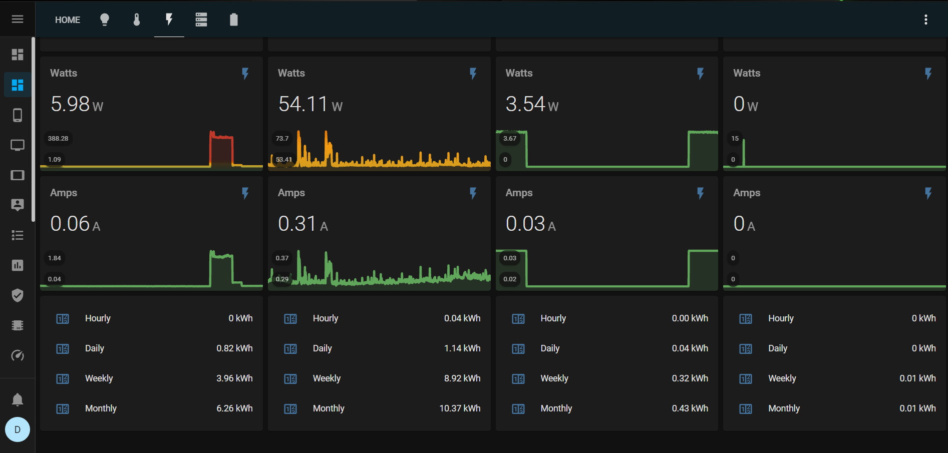

Nice, do we know what sort of price? I could do with some cheap basic ones, as i've just bought some gosunds that i need to flash, they have energy monitoring and i'm going to steal @no idea what 's idea for putting a binary sensor on the dishwasher and washing machine to notify me once they have finished.
Using the latest firmware as far as I am aware.
Using a sensor template for the current usage (I found on the internet):
And a binary sensor for the status:

That current power is right, it was in the middle of heating up for the drying process, it doesn't draw that much power the whole time :)

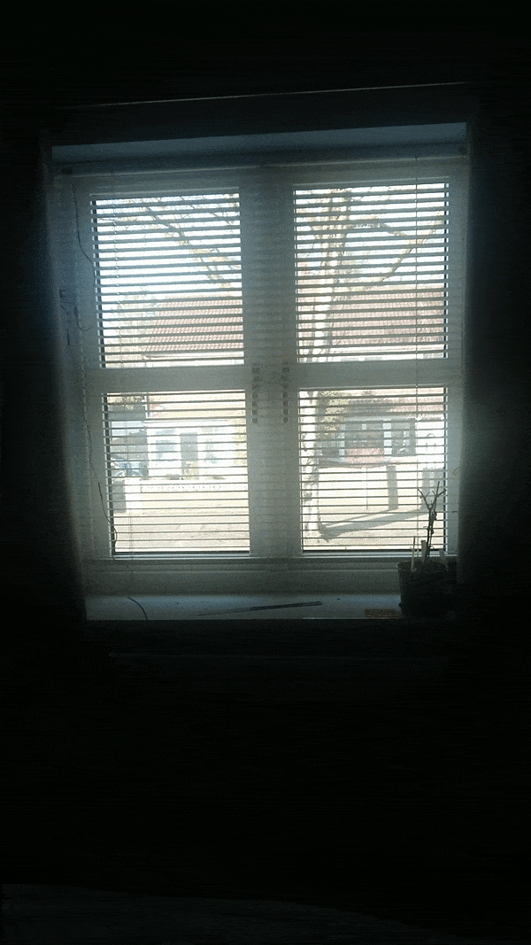

On another note, i've finally built a prototype for my smart blinds:
Excuse the wiring hanging down the side, once i'm satisfied that it's working as expected, then i can look at embedding the controller and routing the wires to somewhere much less visible.

Incredibly cheap too! Excluding power supplies and cabling (as those were cannibalised from spares) the microcontroller and servo are about £3 per blind.
Cabling's not expensive anyway, and i've got plenty of usb plugs from previous phones etc. So we're talking well under a fiver per blind. As the servo only hooks on the tilting mechanism, it also means no damage to the blind, so if i need/want to revert it back, i just put the tilt mechanism back.
Should be just as do-able on vertical blinds. Although if you want to fully open/close them (similar to horizontal raise/drop) then you'd need a bigger motor - something like a stepper motor to manage that as blinds can be quite heavy.
We most of the time just tilt the blinds rather than raising/dropping, so will leave that part to be manually controlled for now.
