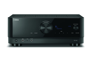

There's Yamaha as well, A4A
FYI if you don't have a sub that means full range will be sent to the mains. Those little 3010i are not capable of full range, so you could possibly damage them during heavy action sequences.
A4a is £1200. Did you get the v4a?
Is it as good?
Will the 3020is be sufficient? I have little idea about speakers, just that I have a acoustics and they look pretty good.
I might have got my models mixed up I'm sure there's one at £400
ah "R" line
I don't have a modern Yamaha AVR. 3020i do have bigger driver so have more bass output. For music in a small room it'll be fine, but I'd still be concerned in marvel type explosion movies during peaks
