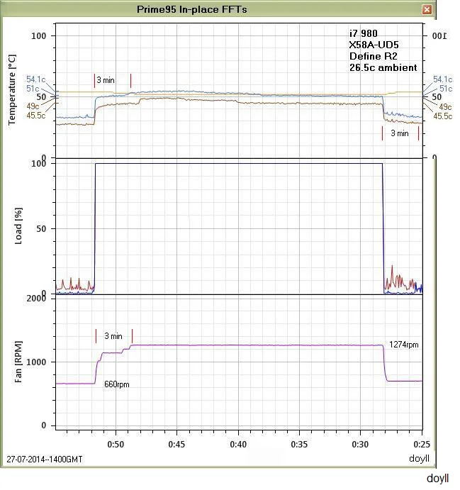

There are some hi-performance coolers like Thermalright Silver Arrow IB-E Extreme, Silver Arrow TR4 (large base) with high performance fans that cool better than most CLCs making similar high noise levels. The problem is the review sites that tested these hi-performance coolers were testing in case built systems and not increasing case airflow to match the needs of cooler fans, .. so cooler is forced to re-use it's own heated air which continues to get hotter and hotter with resulting CPU temp increasing at same rate. With air cooler every degree increase in air temp into cooler on CPU at high load results in an almost identical increase in CPU temp. So if room is 23c and air into cooler at idle is 25-26c with CPU @ 30c, and we go to full load with fans up to 2500rpm CPU goes to 75c with first air at 26c, but as air temp into cooler raises to 36c the CPU goes to 80c, and if air into cooler is 46c CPU is 85c.
Air cooling in a case with airflow setup to meet components' needs the CPU temp will rise to maximum temp and system balances out in about 3-5 minutes then stays at that temp until it goes back to idle. Below graph is an example of CPU load, temp and fan speed graphs. You can see how everything goes up in first 3 minutes then stays flat until CPU drops back to idle .. and temps drop to normal idle temps in same 3 minutes.
Water cooling take much longer for coolant to equalize and temps balance out.

well can't we agree, that it's only during extended periods of extreme loads, that high fluid temperature is really an issue? :rolleyes:
Really?? How is a tester testing air and/or CLC in a case build system using room ambient air temp be comparing one cooler against another, be it air vs air or air vs CLC? They are not!!! they are only comparing how different coolers/CLCs perform in their specific system .. often saying something like 'to create real world use testing' as an excuse for not taking the time to monitor air temp into cooler/radiator. End result is unless reader has and identical system with identical setting their results will most likely be different. Anyone with a different system will get different results from the same coolers/CLCs.
It's not 'reviewers "forgetting" to provide sufficient airflow'. It's reviewers not knowing and/or not caring to do accurate testing. It has nothing to do with users' knowledge .. but maybe does have to do with tester's knowledge.:p As a tester/reviewer I have talked to many others testers and it's either ignorance or being too lazy to care about doing accurate testing telling me they tried monitoring air temp into cooler and it varied so much it was hard to keep track of what the air temp was at any given time, so they just used room ambinent. :eek: :rolleyes:
Actually anyone with even the slightest idea of how using air to cool anything knows cool air cools better than hot air. Also in my defense, more and more review sites are now using cooler/radiator intake air temp as the base air temp rather than room as well as using open bench test stations instead of case built test systems. All of this is because of the very thing I pointed out and you replied to in above quote. Oh, and it's not '(potential high performance) case fans' unless they are using a cooler with high performance fan.
Testing review sites often publish other guides, like which GPUs are better, or what cases are better or how to overclock .. and some even publish guide to how to setup system airflow .. all to help 'average user' learn and understand how to get the most out of their systems.
Honestly not quite sure if you're mad at reviewers or me here?
Not trying to defend anyone, neither to I want to accuse people without a proper knowledge of what they do.
Reviews are, in my opinion, subjective. Mostly because you can never account for all variables in the readers situation. Thus you should never take a review as a fact, but rather as a snapshot of what a certain product can do, given certain circumstances (which I'd senserely hope that any serious reviewer would list).
Doyll. If it wasn't perfectly clear, I do not wish to speak any mumbo-jumbo here. Just, honestly, trying to give some feedback.
I hope that this gets across :)
I believe a common misconception is that the new pumps make a lot of noise. More often than not, these days, the noise the users seem to hear is not actually the pump, but rather it's a case of the fans included ramping up to full speed. Creating the "tornado sound" as MartinPrince mentioned. There's definitely still more we can do on the pump, to make it quieter, but as mentioned, it appears to be a common misconception that pump and fan noise are the same :)
I would surmise that it is uncommon as nobody I've ever known who has used a CLC has confused fan noise with pump noise. What they tend to do is isolate the pump noise by briefly disabling or turning off all the fans in the system. Once again, as in the case of getting out air bubbles, not difficult to do. ;)
