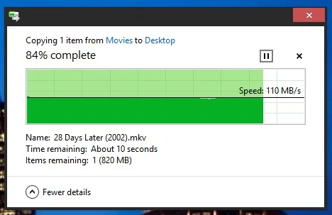

    I'm very pleased with XPEnology I've copying 40GB of files to and from the N54 and so far so good.
    It's way much faster then my old DS211j wished I'd bought one months ago.

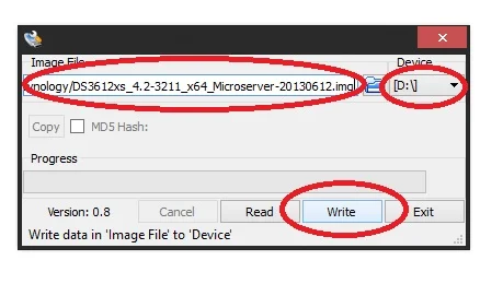

    3) SETUP THE USB STICK
    Insert a USB stick into your PC and launch the Win32DiskImager, select the .img file, select the USB drive and then click on write
    [​IMG]
    4) LOAD IT UP

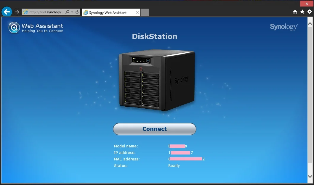

    5) SYNOLOGY ASSISTANT
    From a PC connected on the same network, launch the following site:
    http://find.synology.com/#
    (this is the sinology web assistant)
    This should find your HP microserver, when found (remove your USB stick from the microserver (yes whilst it still on), once removed - click on connect:
    [​IMG]
    (default login is ‘admin’ and no password) – of course change this as you wish
    (also keep note of the I.P. address)

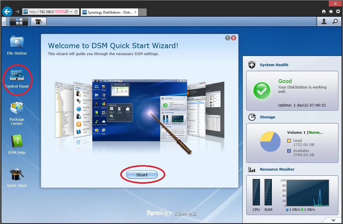

    7) RESTART & CONFIG
    Once done, you will be prompted to restart, shut down and reinsert your USB stick back in the microserver and restart the microserver, wait a couple of minutes and open your browser on the PC and in the address bar type in the IP address, enter your user / pass and login

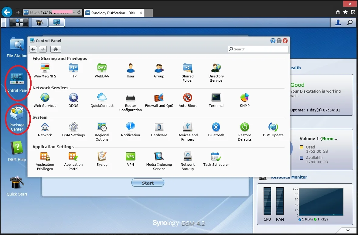

    8) CONFIGURATION / HDD HIBERNATION
    Click on Start and follow the wizard or select ‘control panel’ and manually select your config:
    [​IMG]
    under control panel / hardware / HDD hibernation / select the spindown time for your hard drives – least is 10 minutes)
    IMPORTANT, once you have saved all your settings, remove the USB stick from the microserver, this needs to be done to let the hard drives spin down, with the USB stick in the drives do no spin down (a bug)

    Speeds are fantastic using Synoology, it is 100mb+ both ways :D :
