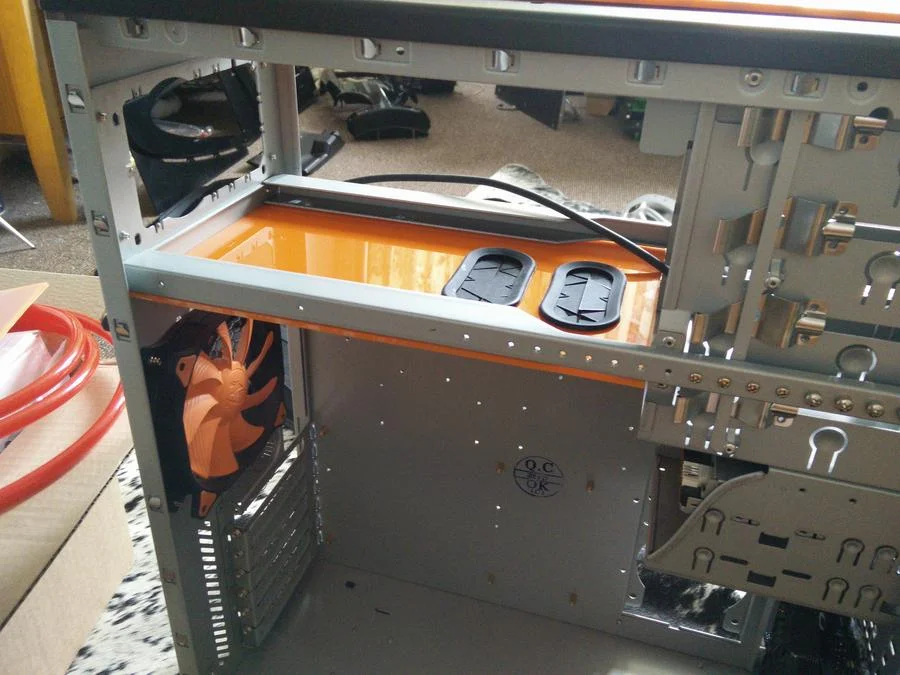

Don't be afraid to call it gaudy. If you thought that I was aiming for class and style you were wrong. I want bright, tacky and gaudy. That is how it went, from beige to luminous orange and yellow. I am modding this now, as distastefully (yet clean and tidy) as possible. That is the whole point in an old skool build right?

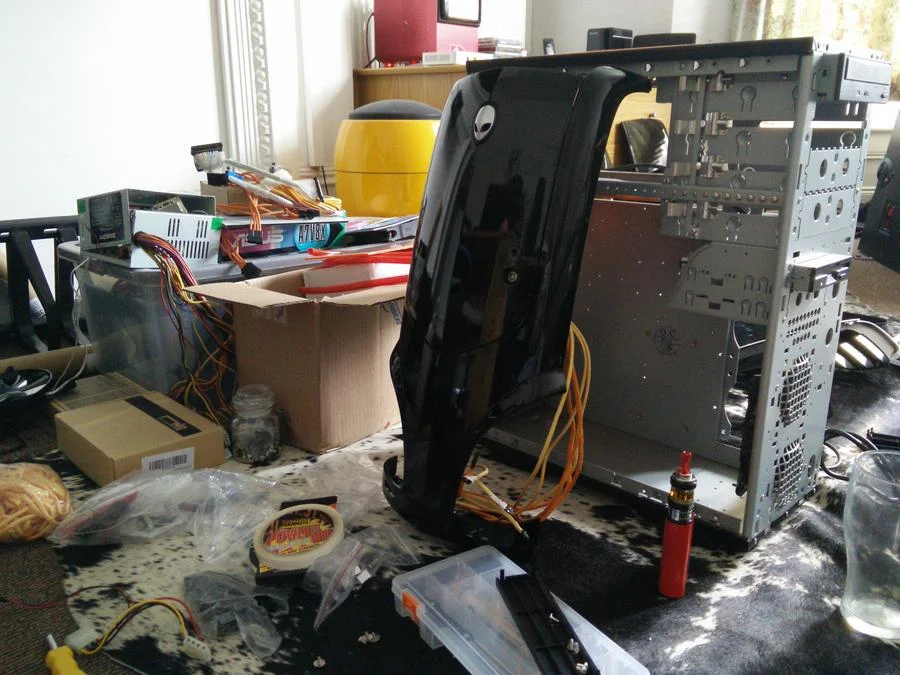

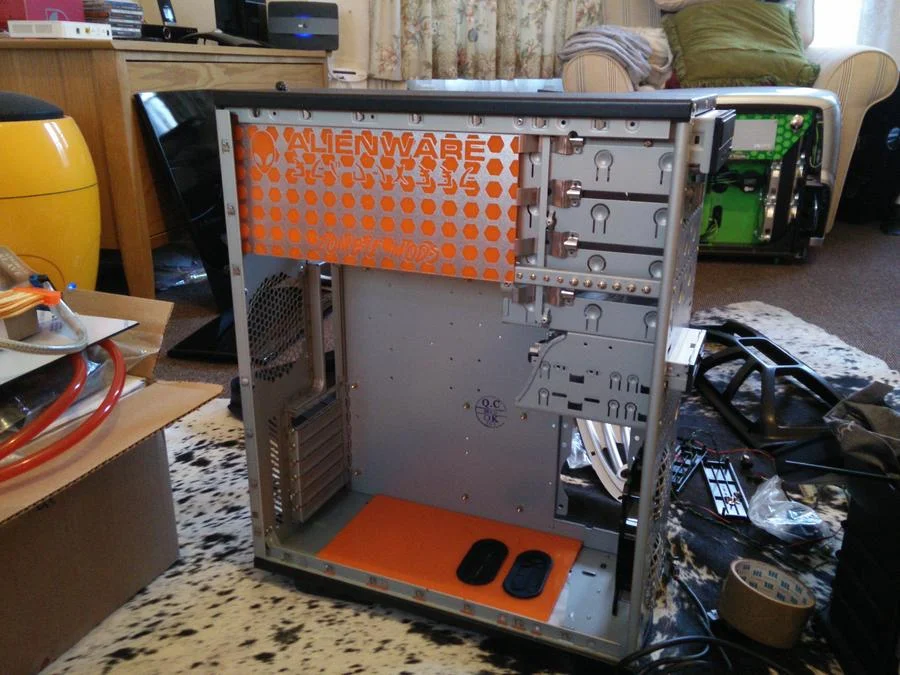

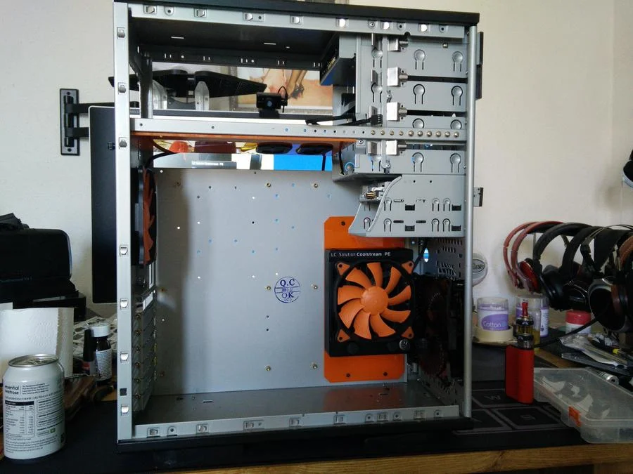

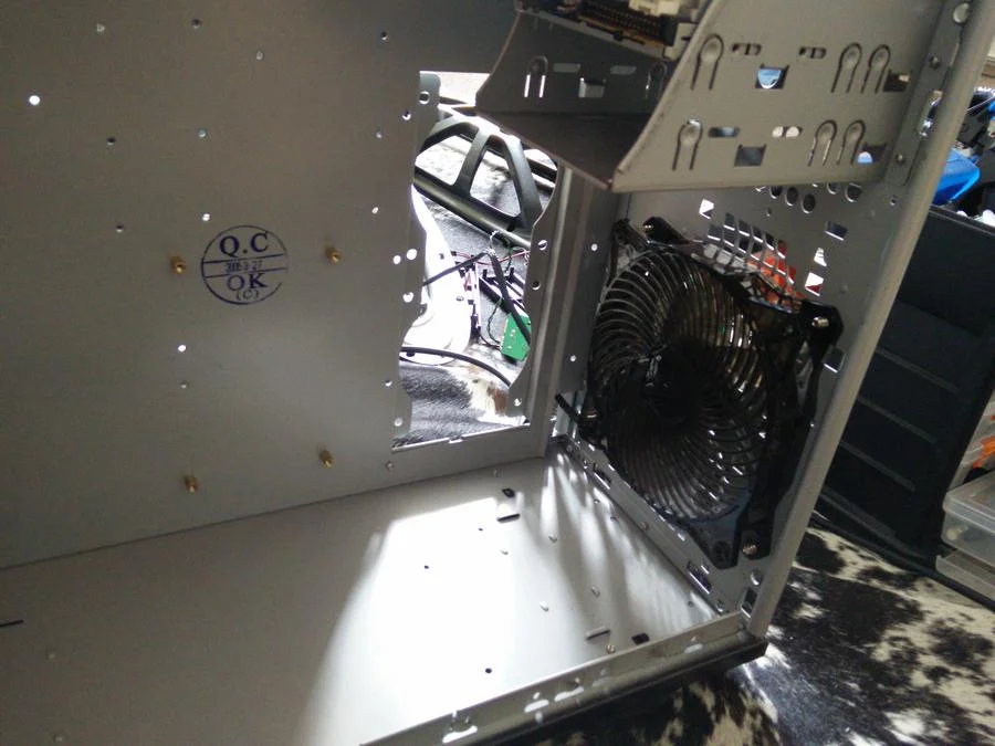

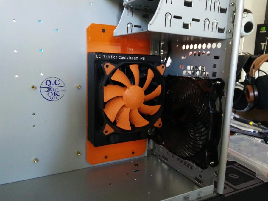

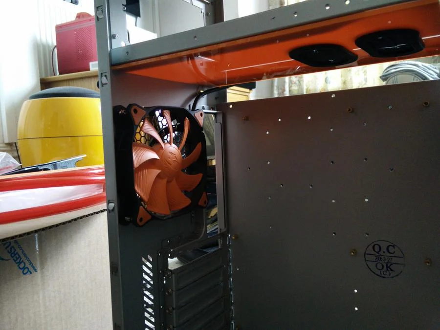

Any way, today I painted the fan wires and cut a new centre piece for the intake, that's now as tidy as you like.
I then fitted the floor with this stuff.
Seriously, it should carry a health warning. Anything it touches it sticks to and you ain't getting it off.
Try and ignore all of the light flooding in. It won't do that when everything is closed up I had the same issues with Dianoga.
Nice and tidy.

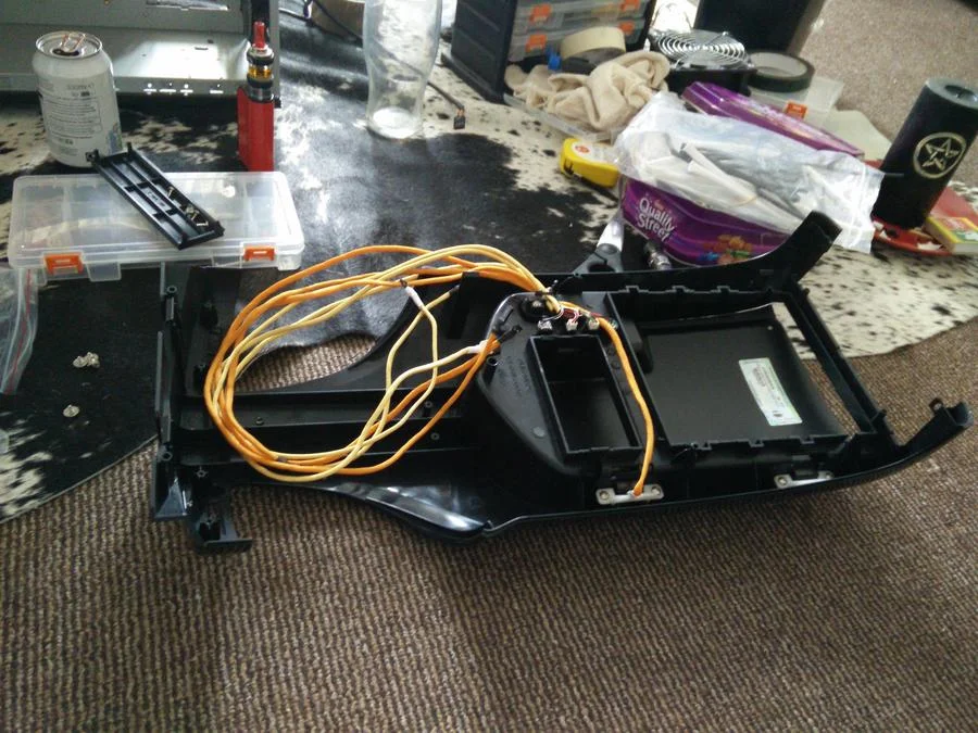

Work continues. Firstly I braided the entire FP.
Wow, now I know why my hands are covered in hard skin and cuts.

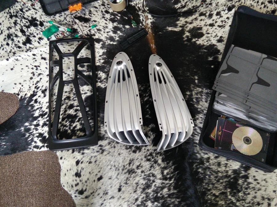

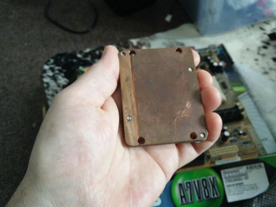

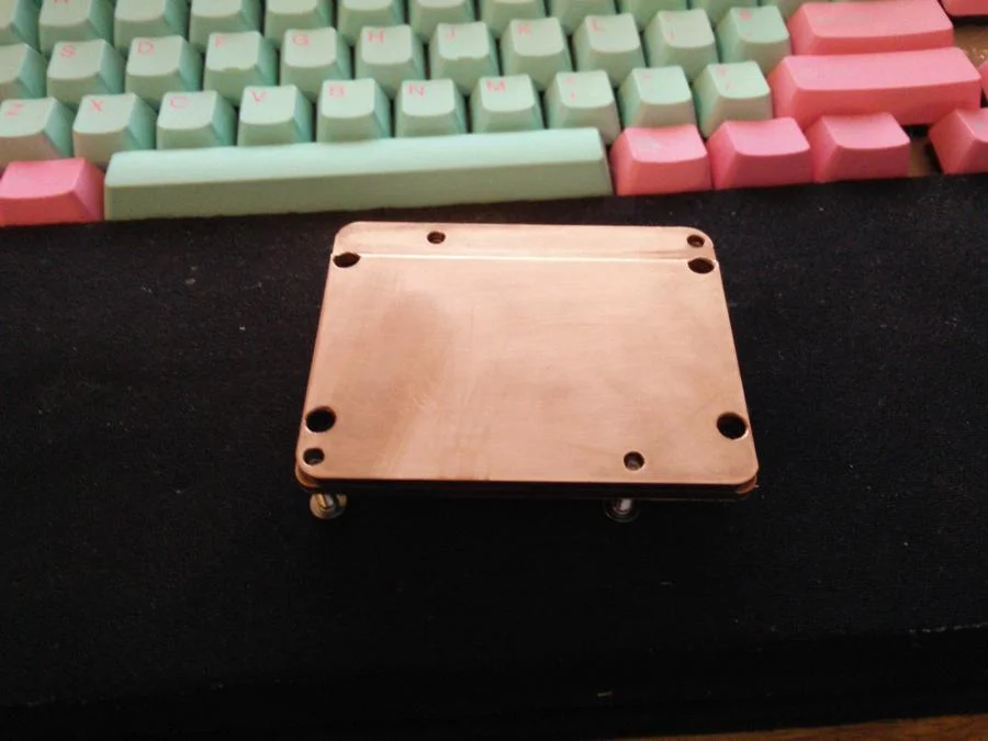

Just in case you were wondering what had happened to the gills. I spent a couple of hours cleaning and then welding them up the other night. Then reassembled.
Before.
I actually thought that the black inside part was nickle coated, but nope.
All copper ! Before.
After.
For the inside I used a Dremel wire brush and then compound on a polishing attachment. For the bottom I went P1200, P1500, P2000 and then P3000. Not a mirror but hey, it'll do :)
Looking good :)

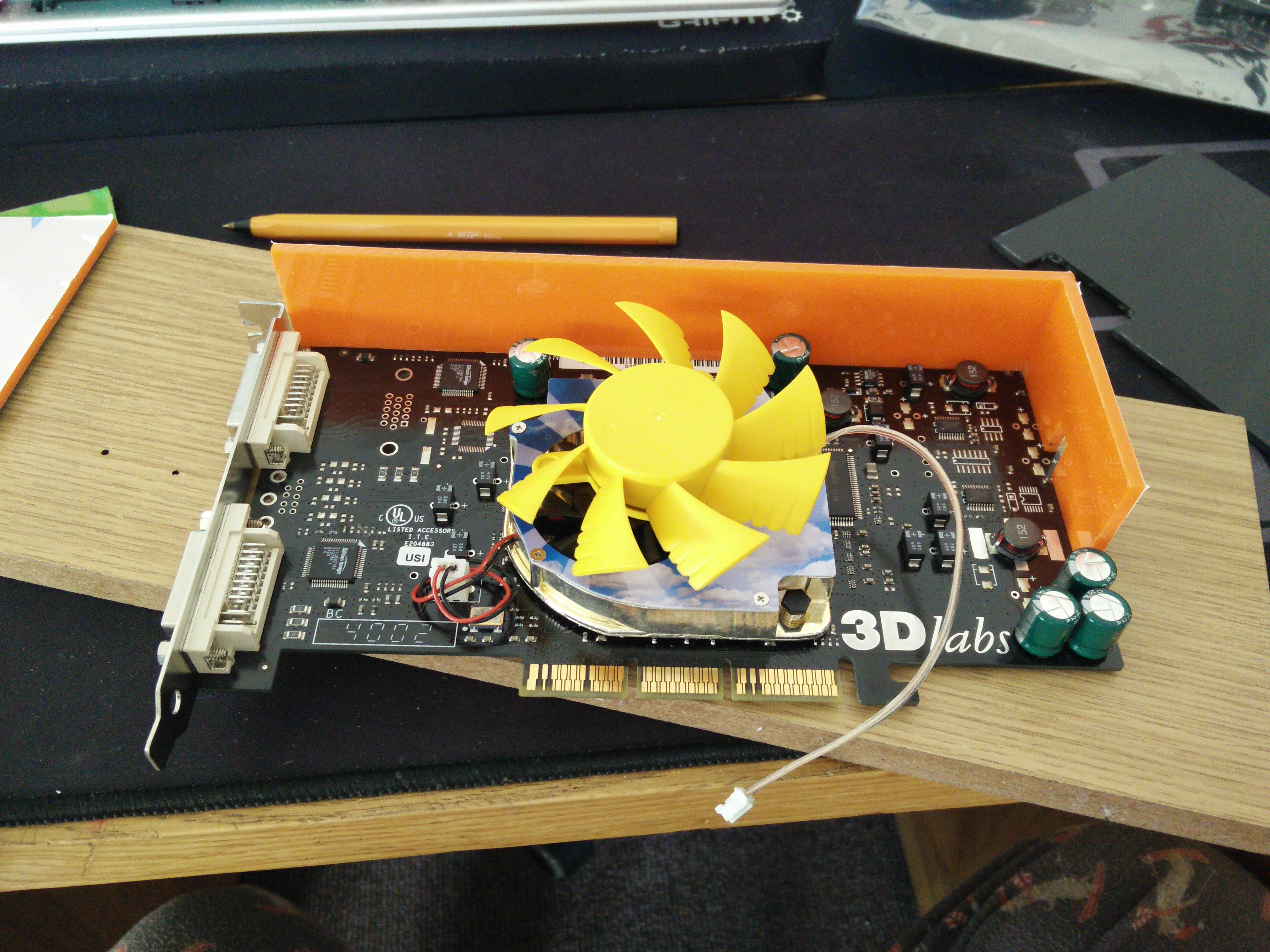

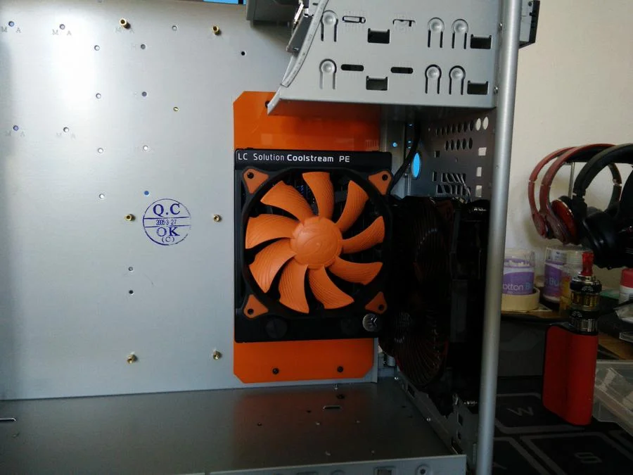

I would be cutting out a hole to match the front fan though,better throughput of air with no restriction
Looking good :)
You can't. There are mount holes for the case itself. The airflow is actually very good. The 80mm cutouts are bumped outward so there is no turbulence. Already tested the intake fan at certain voltages, 12v is fine and it brings in loads of air :) I mounted it so that the centre of the fan is dead centre with the middle of the two 80mm holes. Meaning that it's only really the flat spot that is covered.

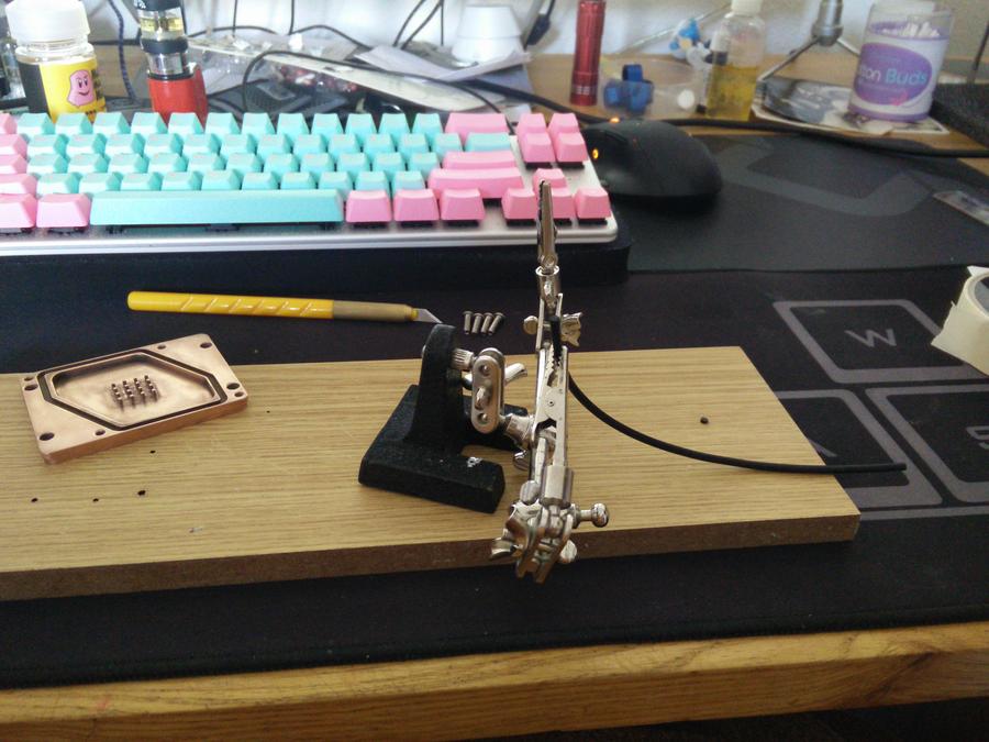

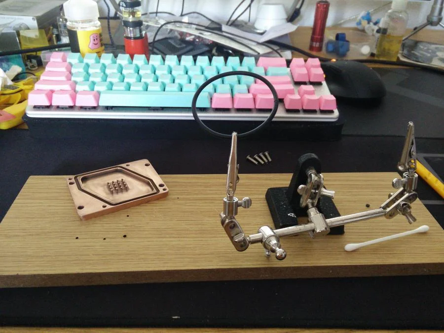

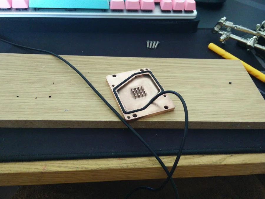

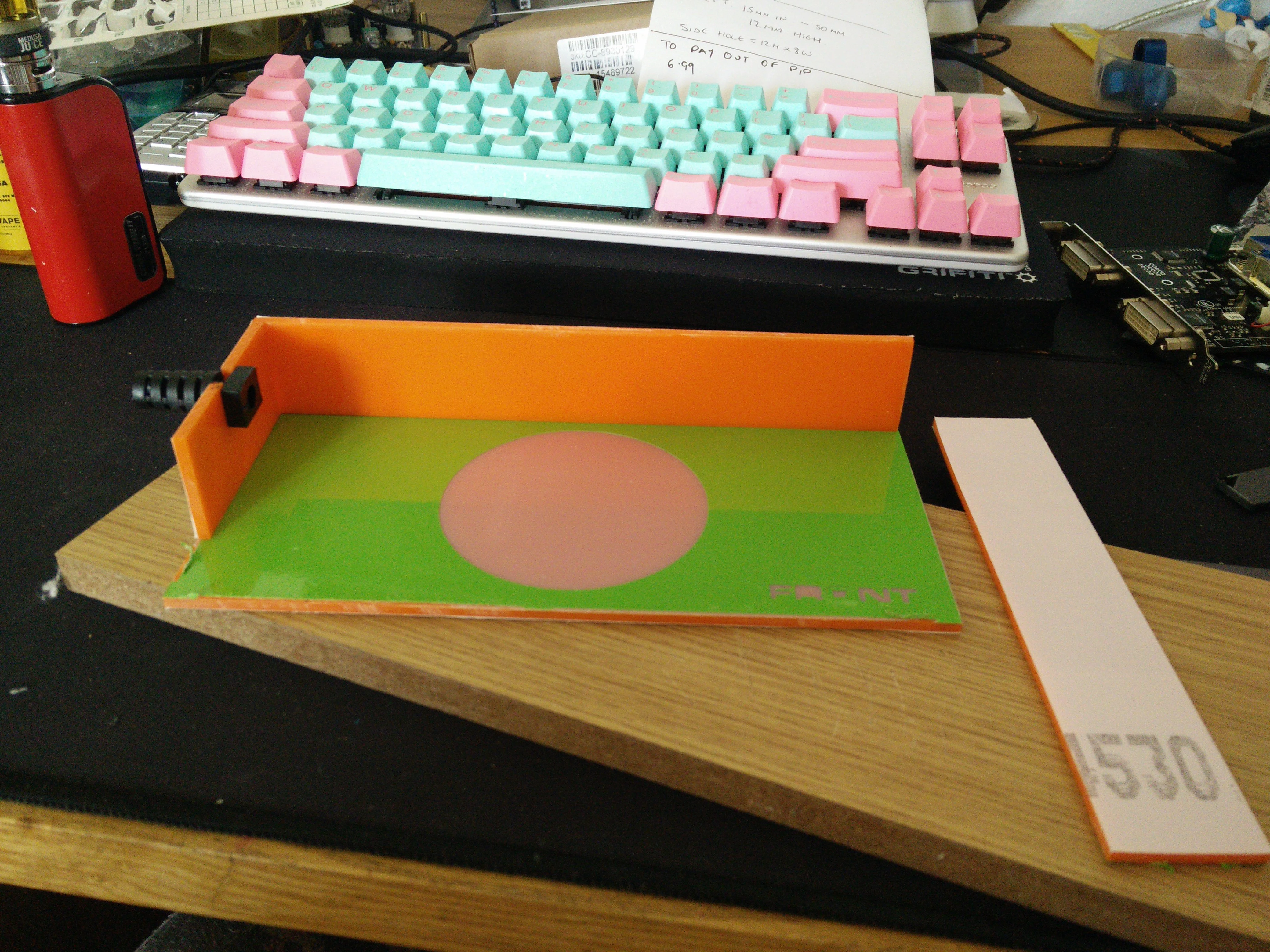

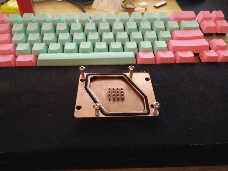

Making Orings 101. First you need a block and some nitrile rubber.
Remove old Oring and fit new.
Mark, cut (making sure the cuts are perfectly straight)
And...
OK so I admit it took me two attempts. Lessons learned from mistake... 1, you need a tiny amount of super glue. 2, you only get one shot. If you miss the glue dries and goes hard and then the Oring will not bond. So you can either shave it off and try again, or just start again like I did.

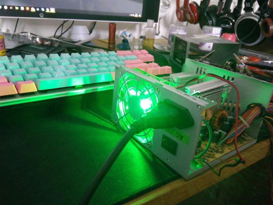

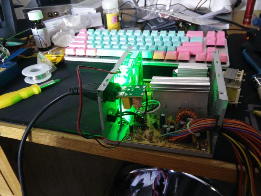

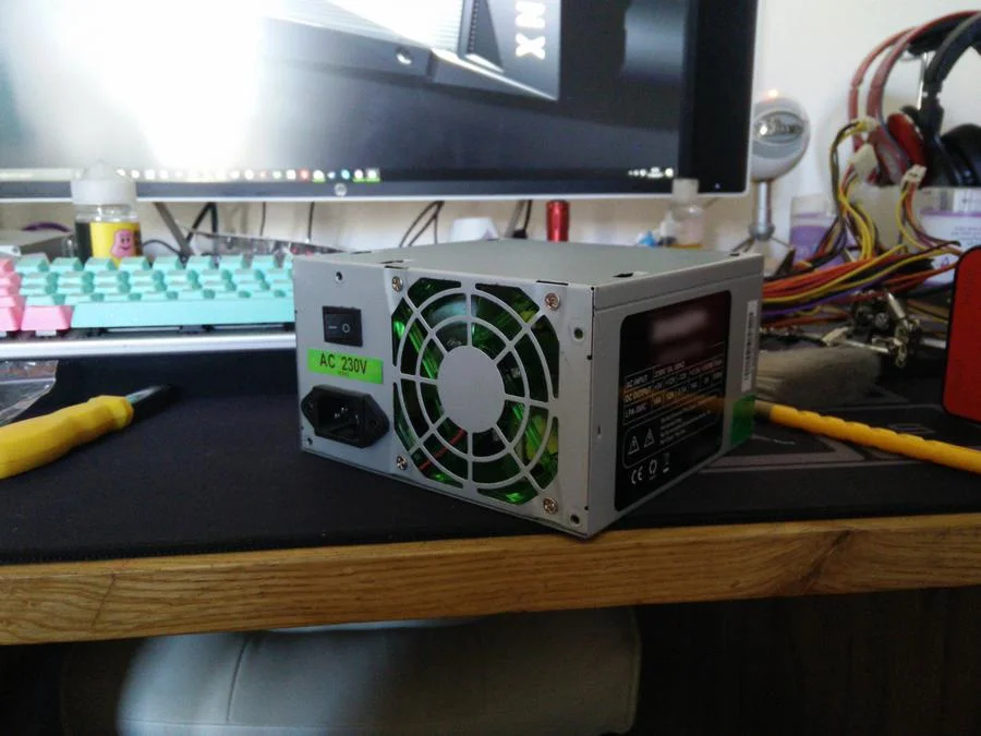

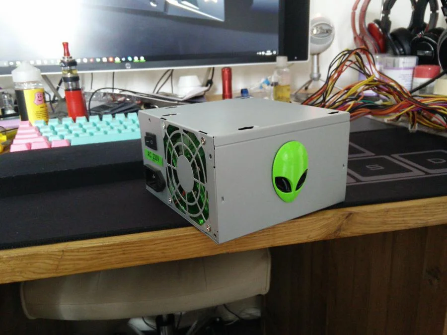

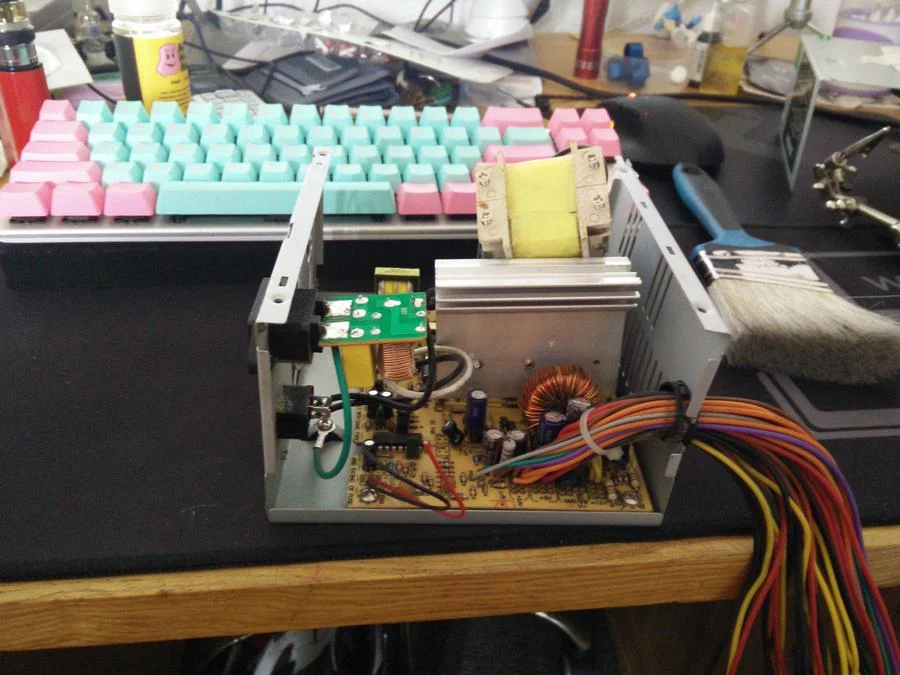

I also got out the heat gun and Isoprop and made the PSU a little more palatable.

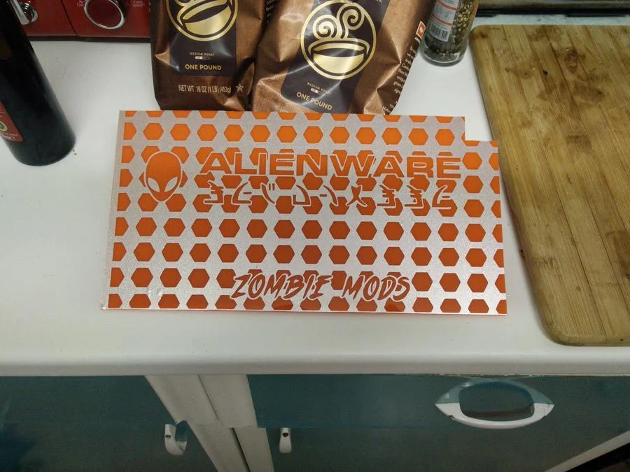

No. The outside of the case will remain 100% bone stock. Once you cut an Alienware you destroy it forever IMO. I already cut a panel on one before and it cost me £130 to replace. With the sides back on I want all of them to be bone stock.

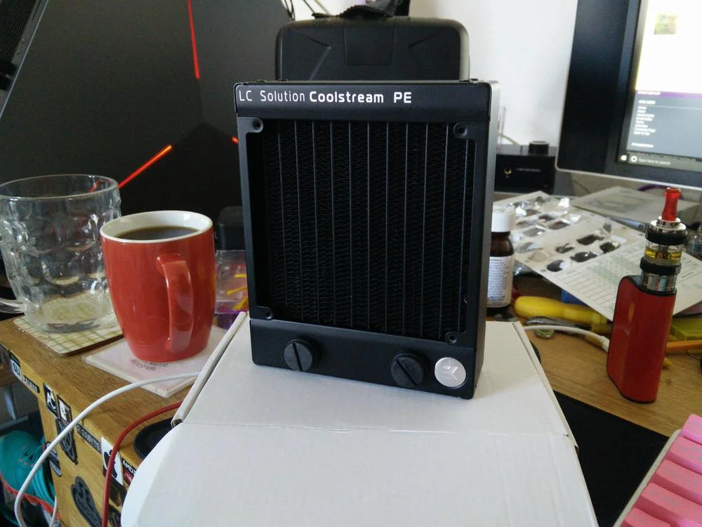

Rad - £5 in postage (swapped with a mate for a 1156 back plate for a Corsair AIO as they were trying to charge him £18)

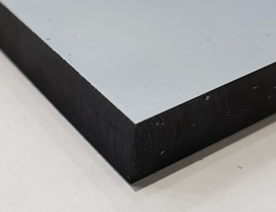

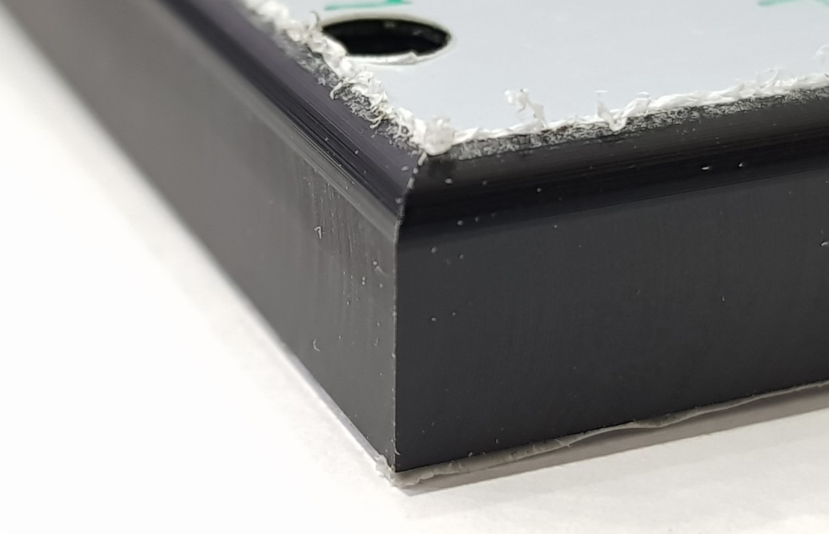

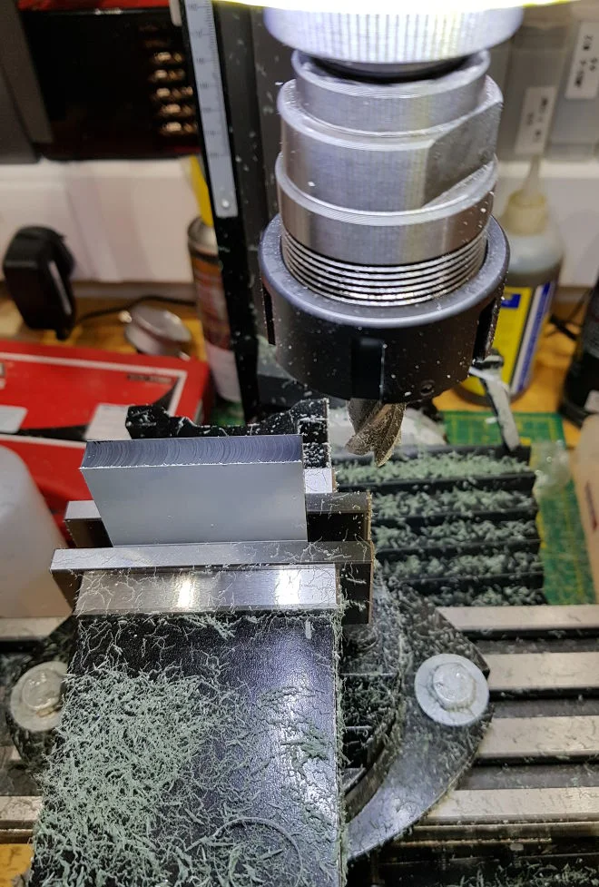

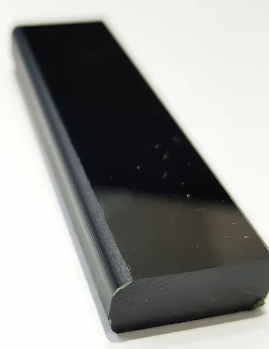

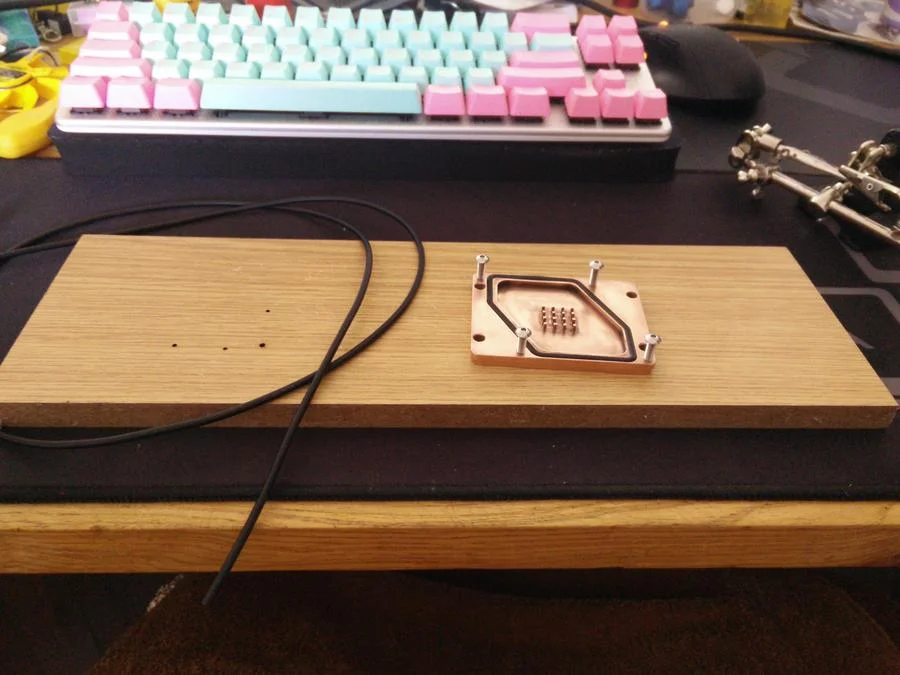

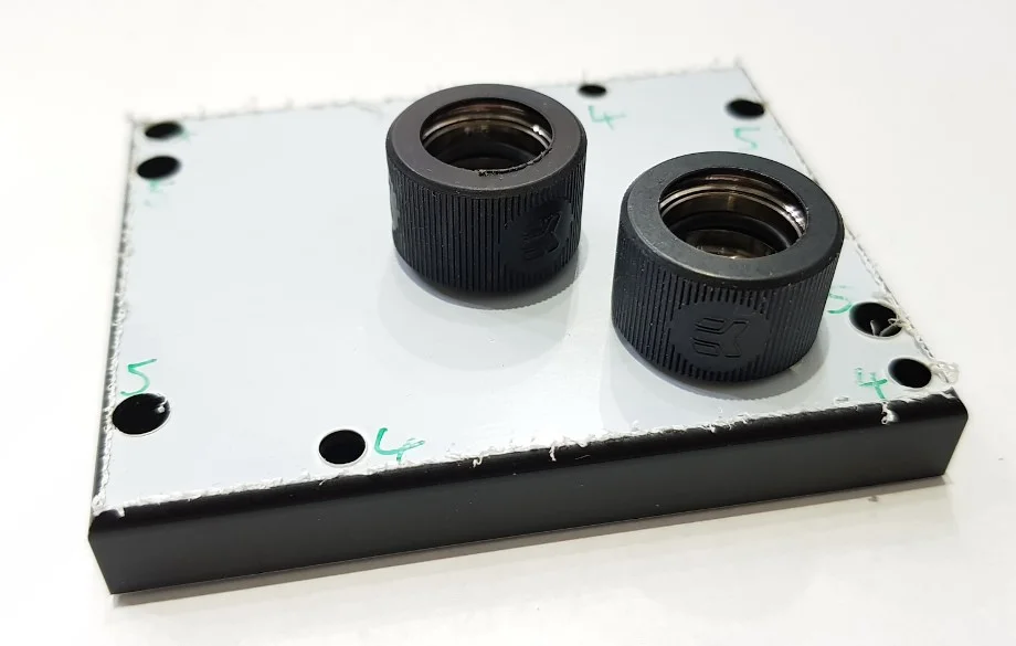

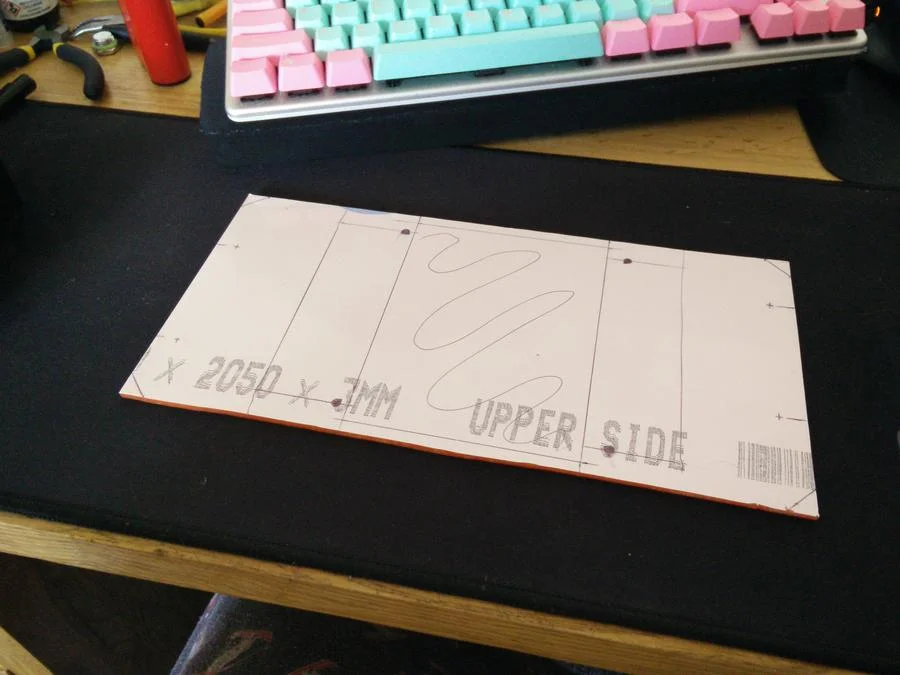

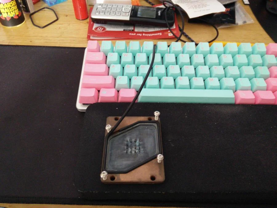

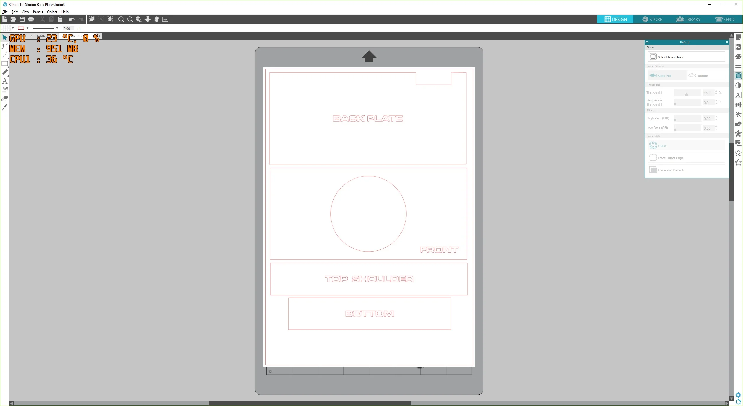

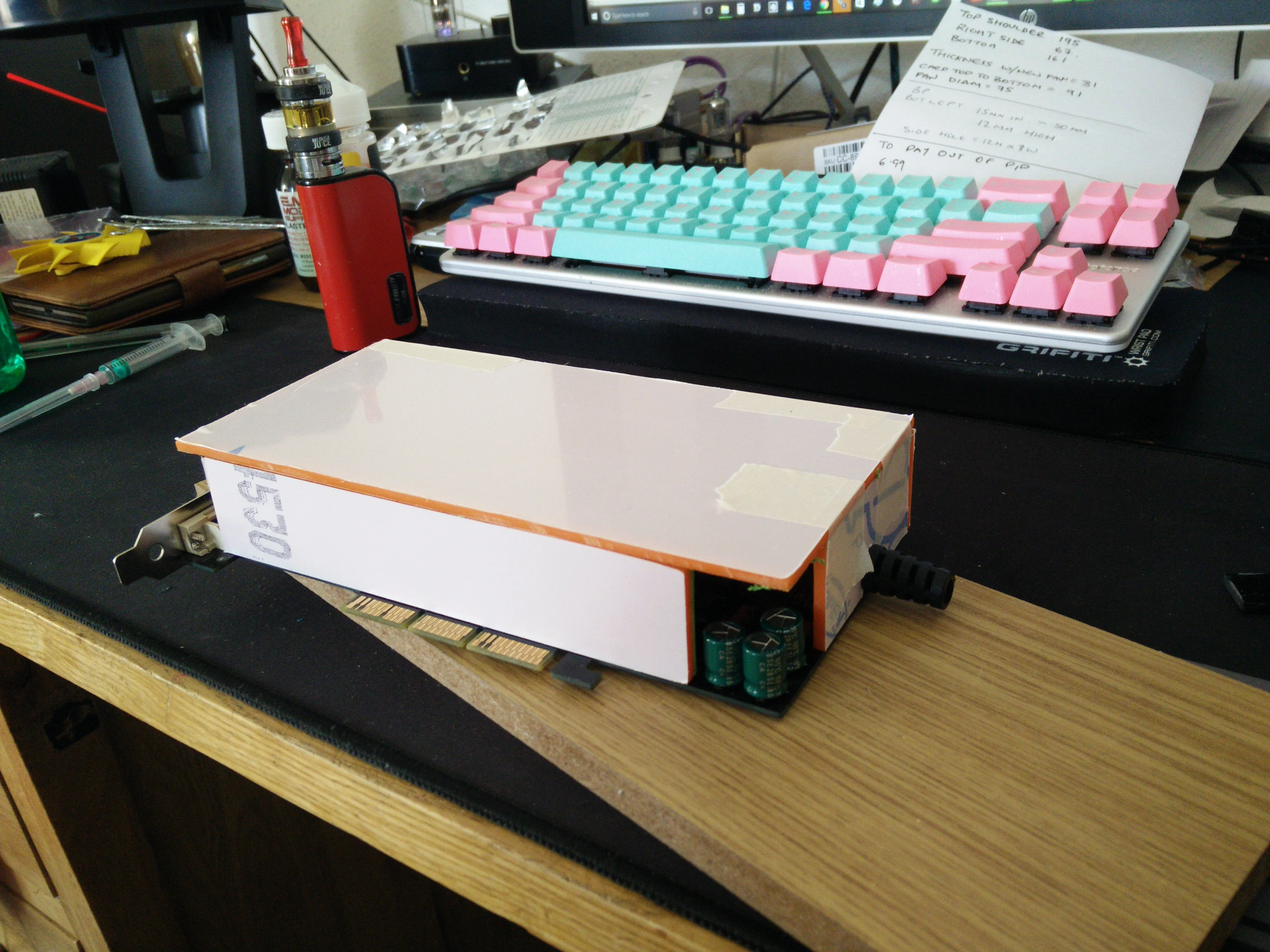

Best update yet :D The block is now being machined. Here is the block being milled.
And to size.
I had a choice of chamfered or rounded edge. I chose rounded.
And the edge finish from the mill.
I will be polishing that out myself :)
yeah dunno wont happened wouldnt show any of your images at home last night all good now, interweb constroobalism i think

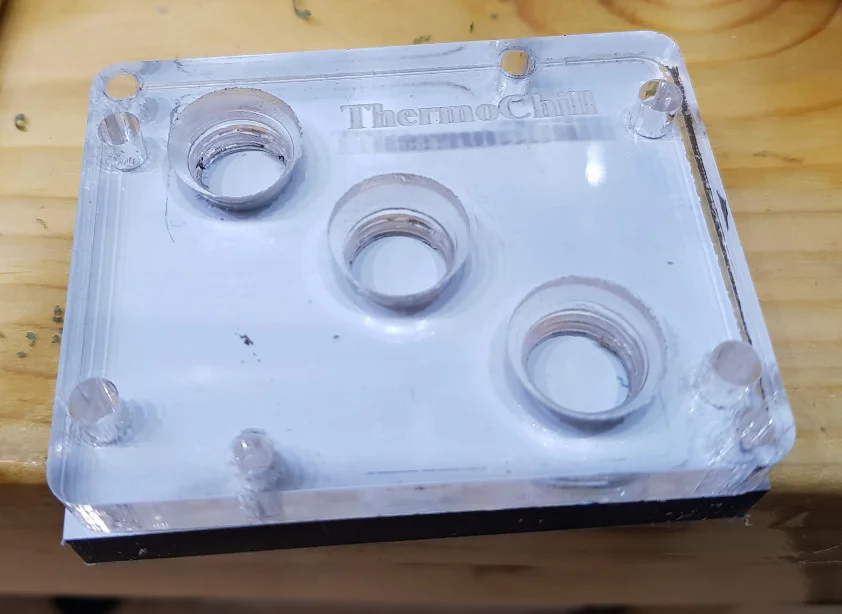

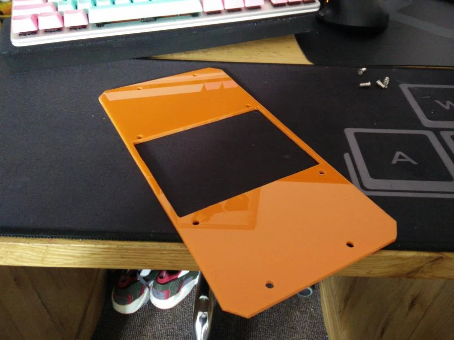

The block top is now finished :)
