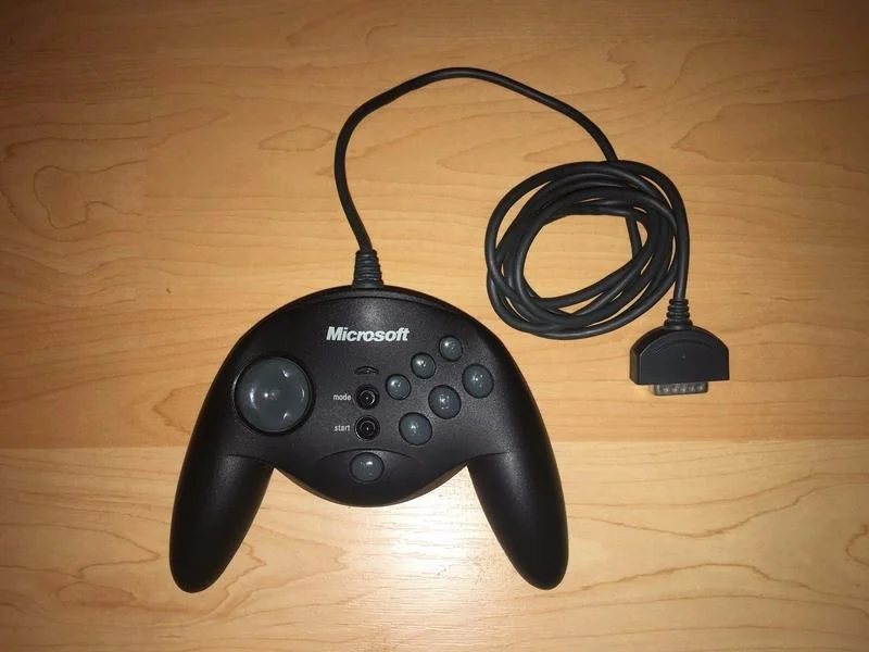

OK guys, time to trigger the old skool feelings again. Remember these?
Bought that in "As new" condition for £7. That is why I wanted the game port on the sound card :)
Blimey game port, id forgotten about them, usb killed all the fun.. serial ports, parallels ports.. I even remember the days when you had cards for all of those, and even the disk controller. I had a full length Disk controller... MFM I think was the type... I wish I was good at modding. and had the time
Awesome build.
Original Sidewinder pads were awesome, so responsive, such a shame they are incompatible with USB-Gameport converters and the USB version of the pad had a much cheaper build quality :(

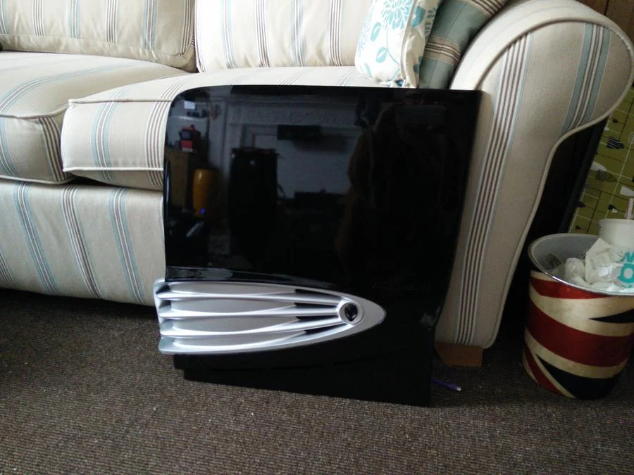

First side panel complete. I hate man flu.. Now I am sweating and feeling dizzy AF :(

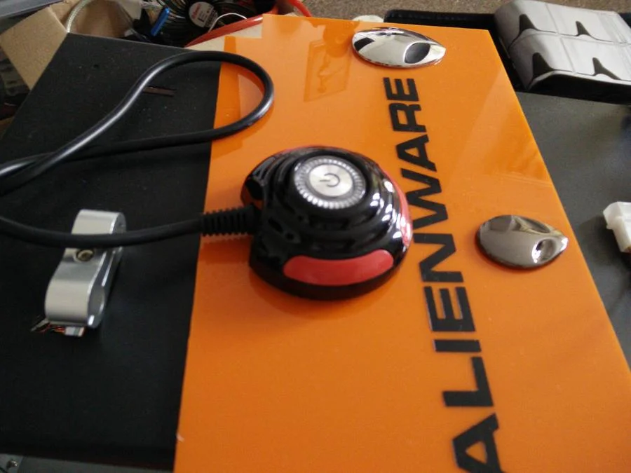

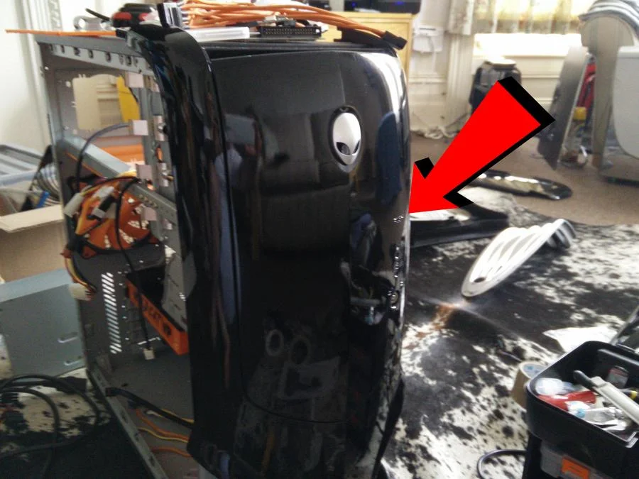

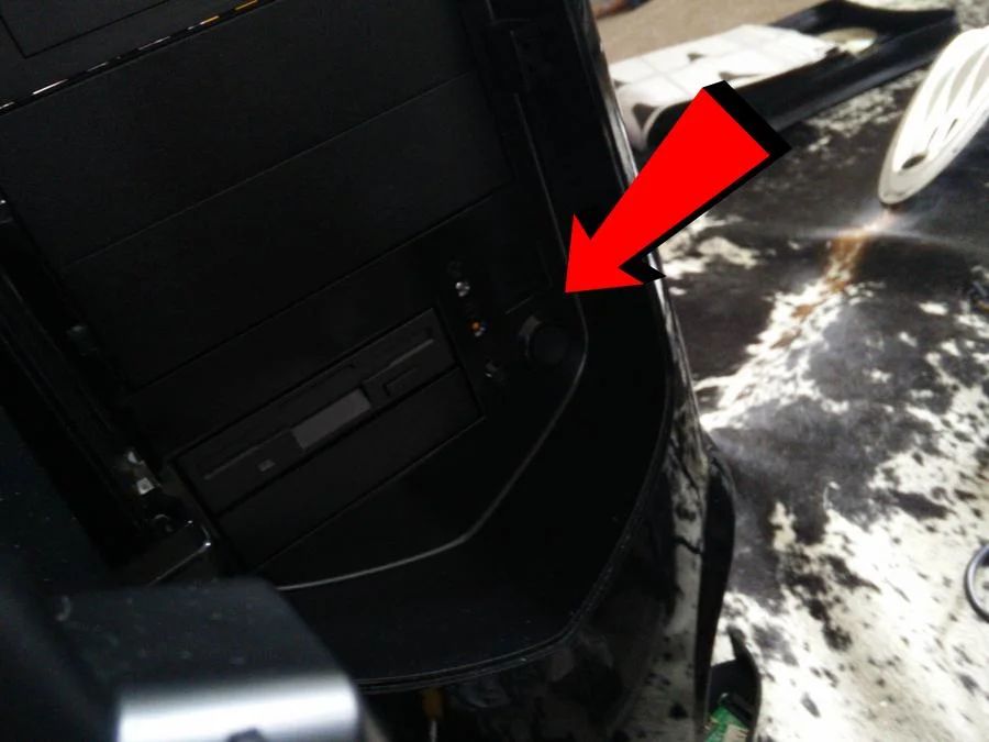

Problem - mirror like black case that you shouldn't touch. To power it on, however, you must open the door by pressing here where it says "push".

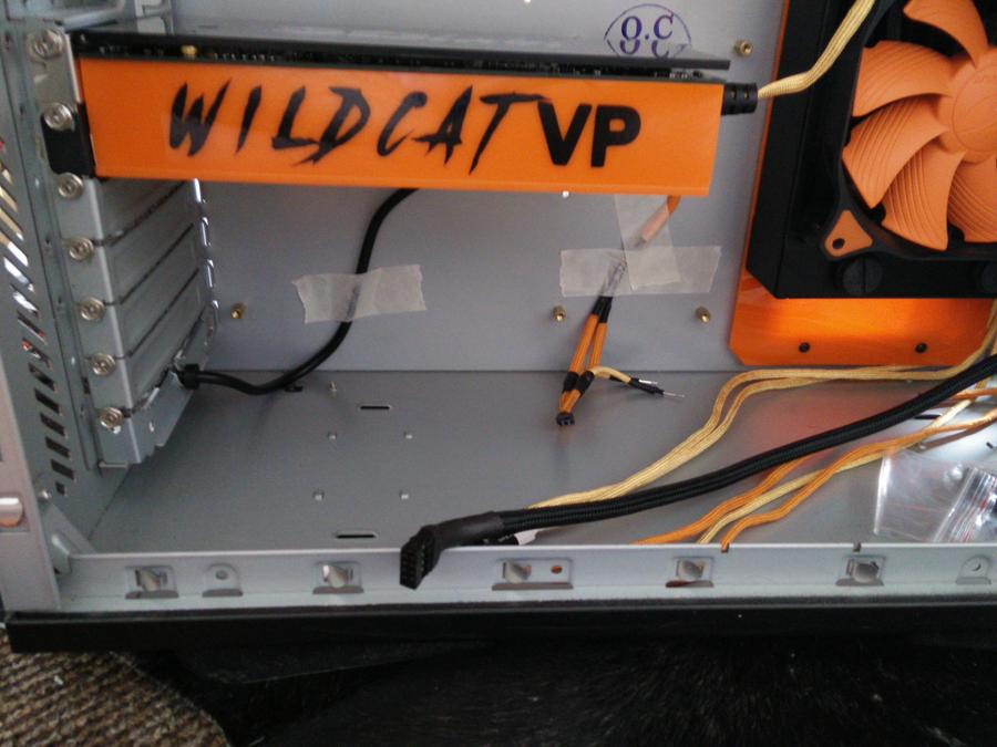

In order to access the power button hnyar.
The solution, fit an external power button I can put on the desk. Just one issue, it came with no splitters so I had to make my own.
Which then goes to hnyar.

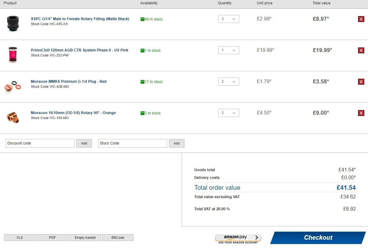

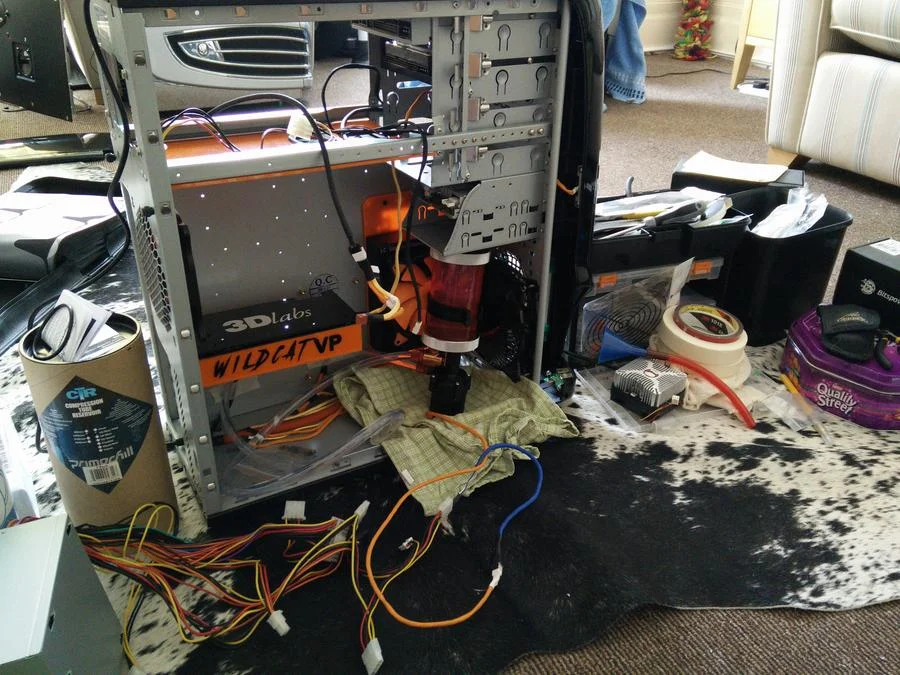

The OCUK stuff arrived and I assembled the res. Not sure I like it really as even when assembled really tight you can still pull the ends off. This means the pump will need to me propped up to stop it pulling the res apart. PITA !
Because of my mistrust I have set up a "faux loop" and am going to run it for a few hours and see if anything leaks out.

It didn't leak, amazingly. But I would not hang anything from the bottom of it at all. Probably best mounted onto the floor of the case tbh.
This res. What a piece of crap. Firstly if you pull the ends they come right off and then the brackets? sheesh, I've never seen something so bad.
Last night I figured I would spend some time playing around with the rest of it. The brackets are awful. Truly dire. Firstly the guide hole that the M4 plastic bolt is supposed to go through was tiny so the bolt would not go through it. So I took both brackets to the kitchen and dremeled the holes out so the bolt would fit through. Came back in and the bolts then aim about 2mm out of the hole (I just made them larger, not changed the position). Any way, I go to do up the first one and it gets about 2mm in and then pops and has threaded itself because it's plastic. So the whole bracket falls off. I try the other one and it does exactly the same thing. So I dig around for some M4 metal bolts and start doing one up. As soon as I can let go of the bracket mech and turn the screw a half turn more (so it actually holds the tube and doesn't slide around everywhere and I hear *SNAP*. Yup, bracket snapped in half.
So now I have no way of mounting the res. So I go off to Youtube to try and make sense of it all and the brackets I have are handily left on the table in the video whilst they use clear ones I do not have.
Probably because they are crap. Not sure what to do now, too sick to care atm (man flu).
Just looked for more videos on Youtube, no one is using the stock brackets. So that is me screwed then.

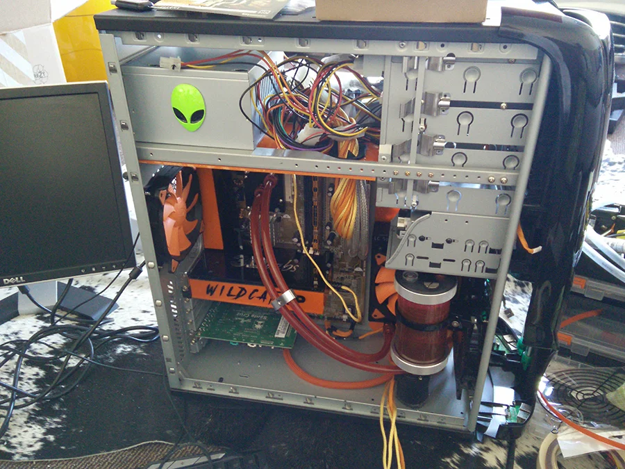

Well with some good luck, and having to settle on it sticking out ever so slightly I have it fitted and connected to the rad.
When I feel better I will tackle the mobo and get it looped.

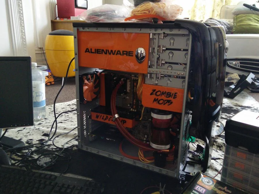

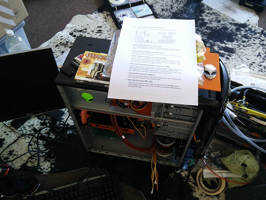

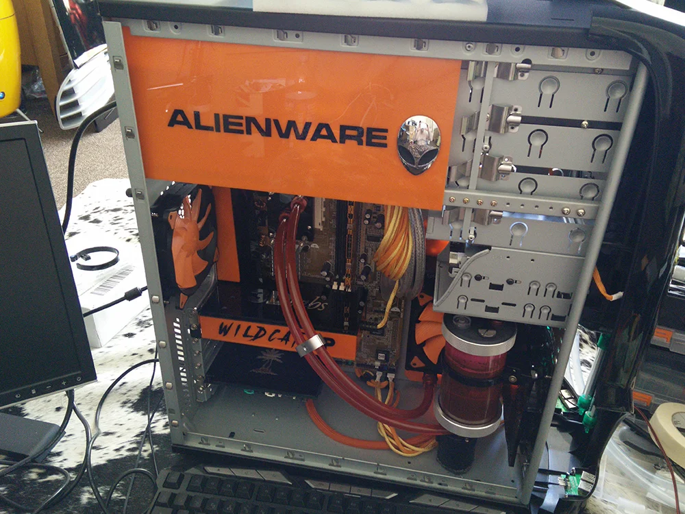

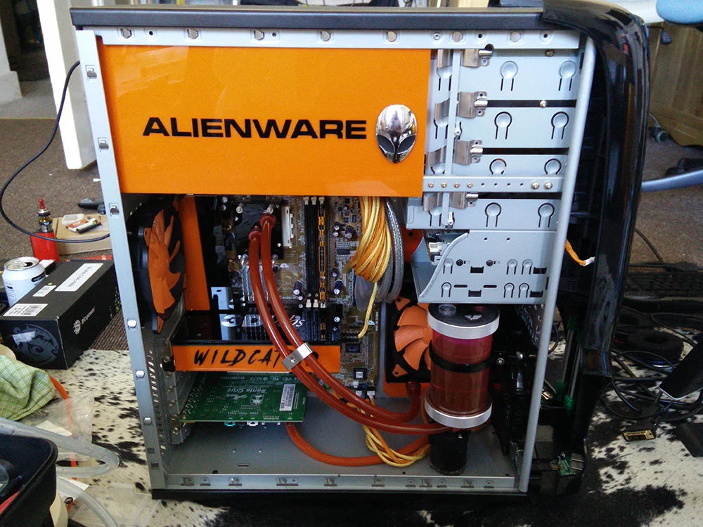

Current state of affairs. As you can see, the next job on the list is wiring the FP. This is why I have printed out the page.
Which reminds me, I installed and played Gunman last night and it was as smooth as butter. Still makes me laugh how it comes up as Half Life in running apps :D OK so here is how the inside is looking right now.
I am hoping very much that the Grid+ arrives today so I can hook up all of the fans etc. Lith, this is where your badge lives now mate :)
Still left to do.

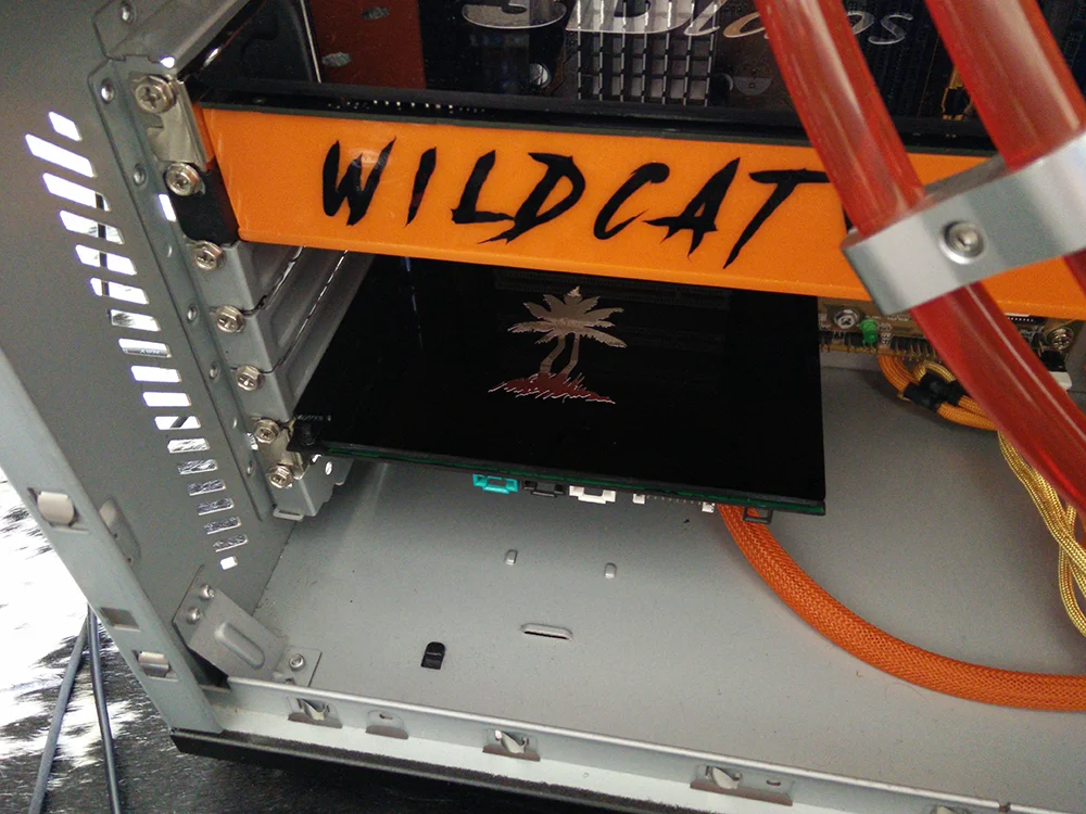

Make a BP for the sound card.
Design and make two more acrylic panels.
Fit top panel.
Fit Grid+ and then use my Win 10 PC as a mothership to set up all of the fans using CAM, which will then make them remember :)
Dang it missed a post. First I did this.
Then I made a back plate for the sound card.
Need to paint the top edge black.
