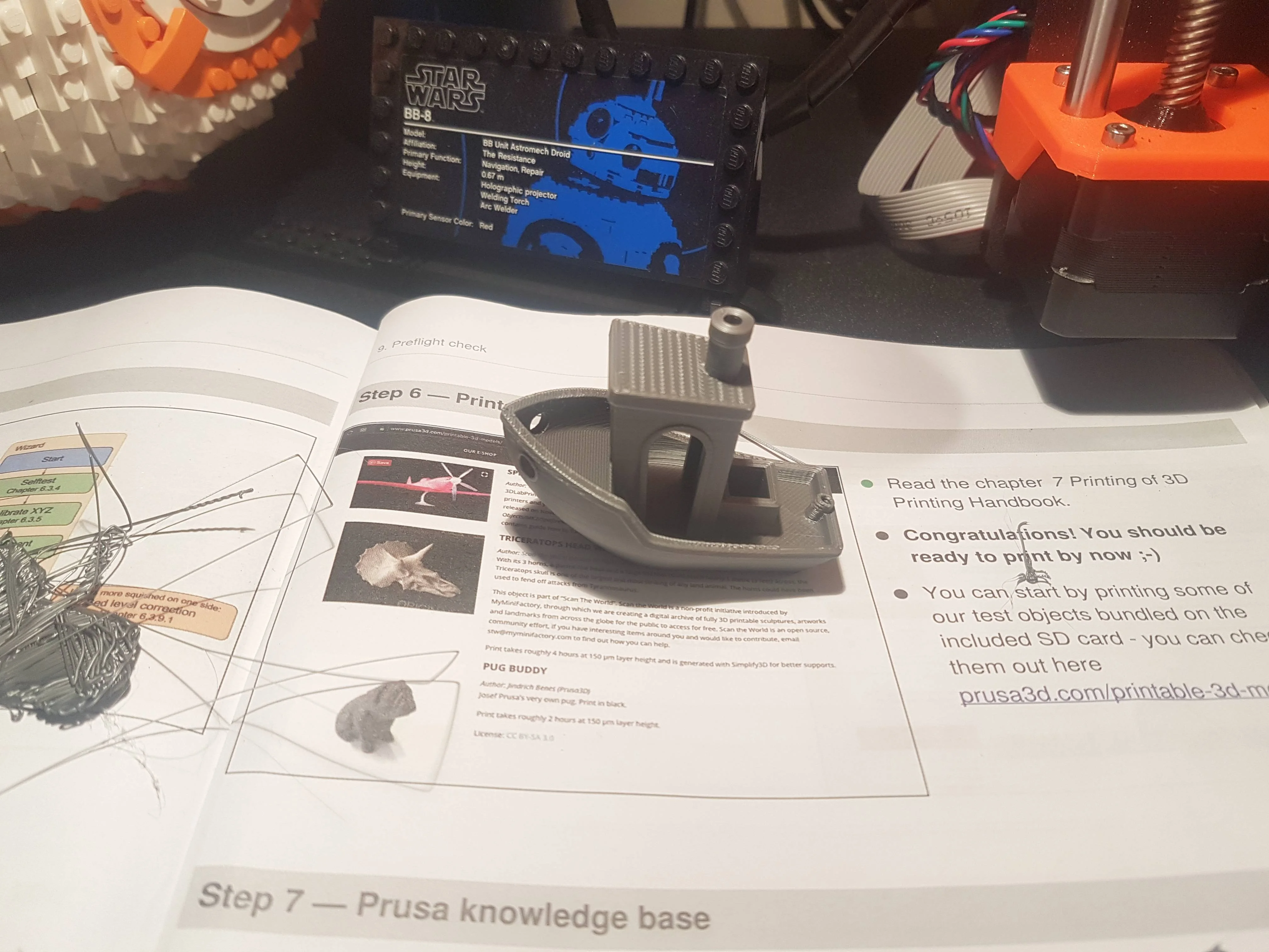

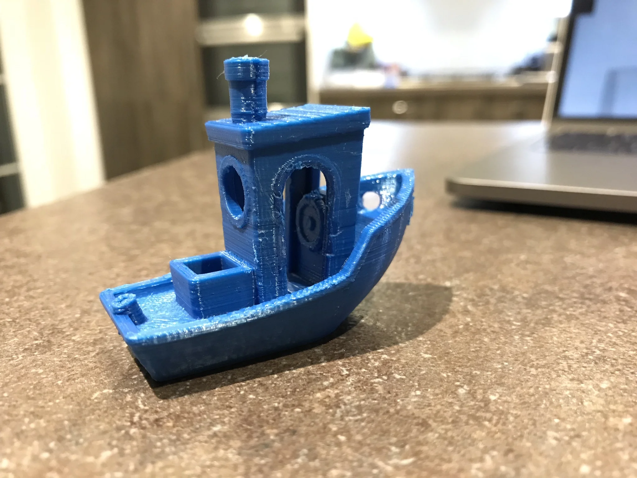

Here's my Benchy that I printed with supports....ooops. It's taken a bit of a battering pulling them all out but still not too horrendous. Size was spot on though.

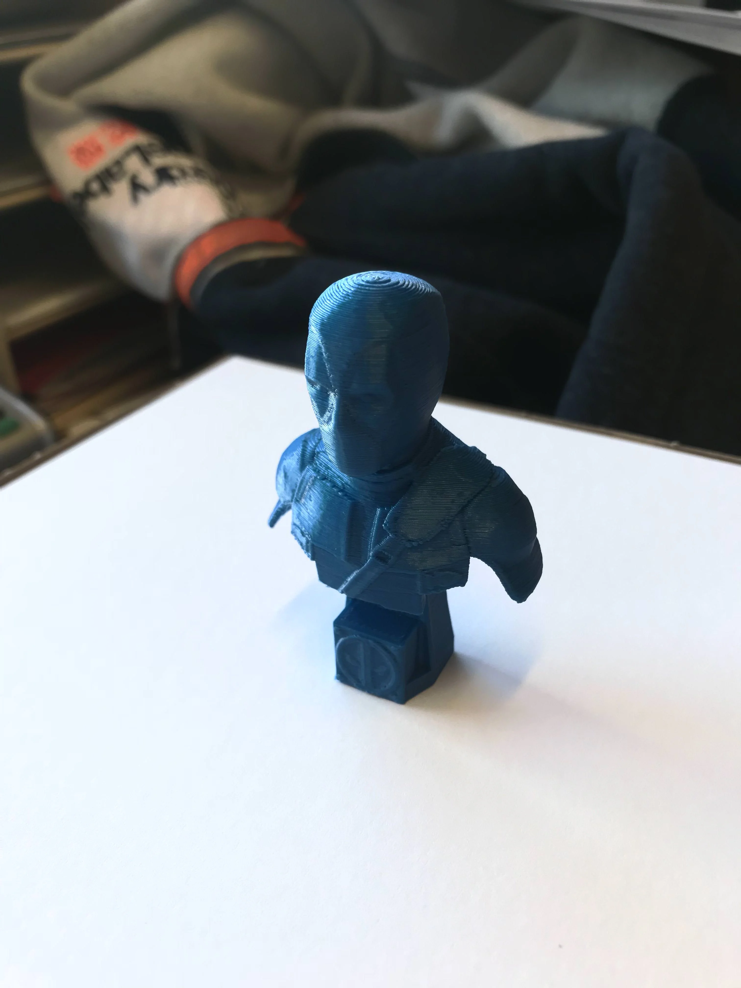

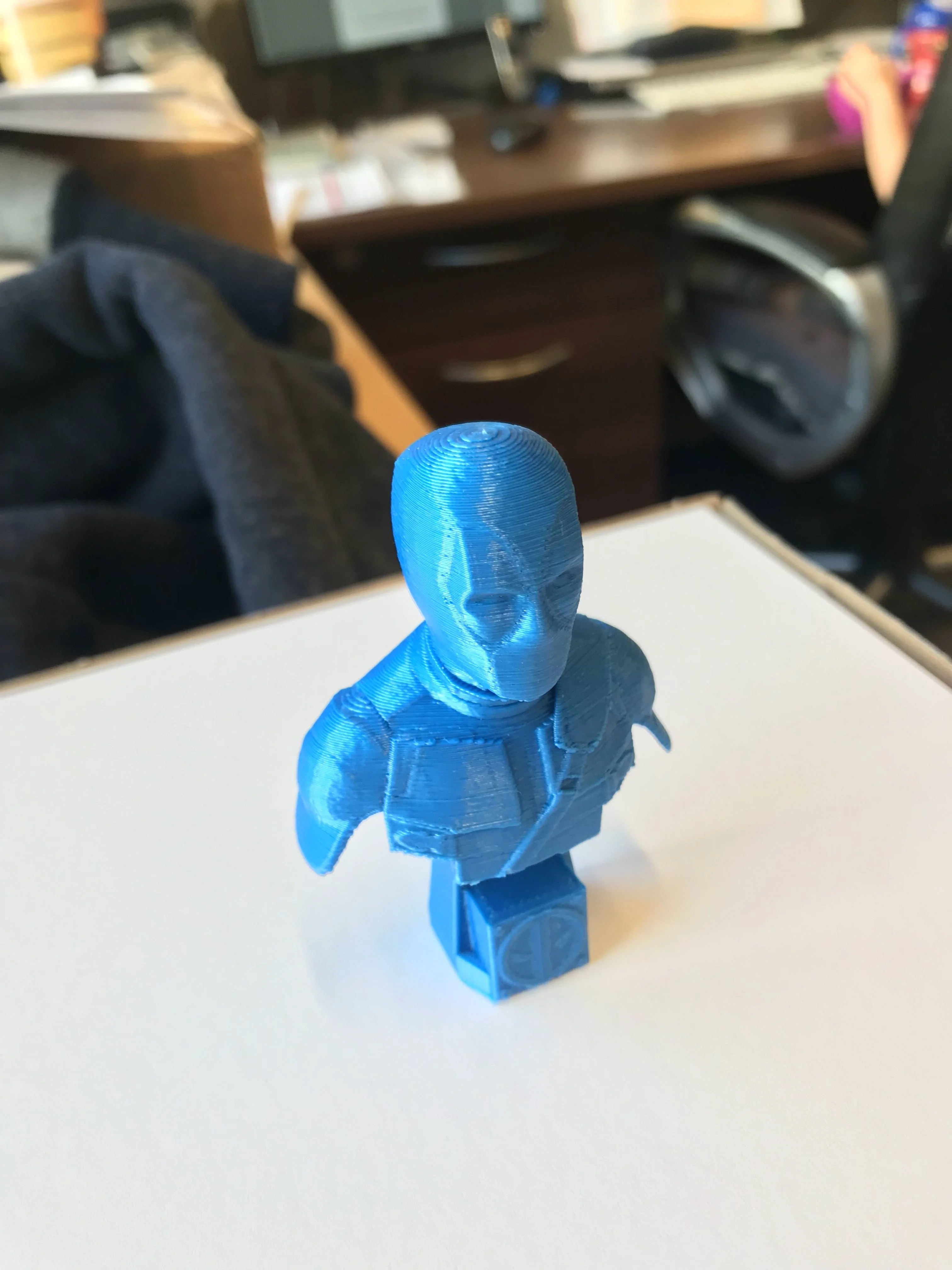

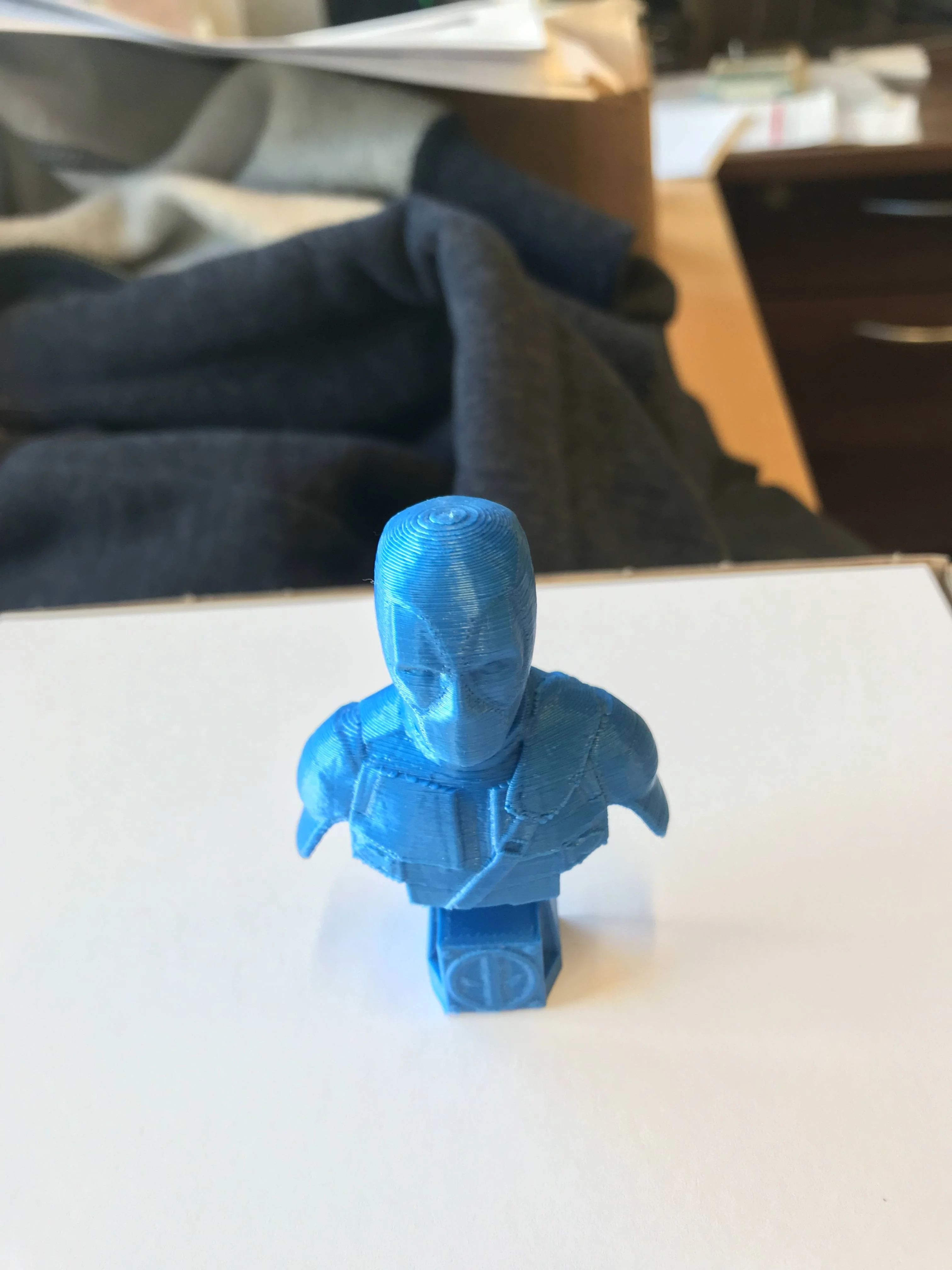

Printed off a mini Deadpool bust last night too. Again, not perfect but for a scale down of a larger model it's not too bad. 75mm high.
Still playing about with lots of slicer settings using Cura.

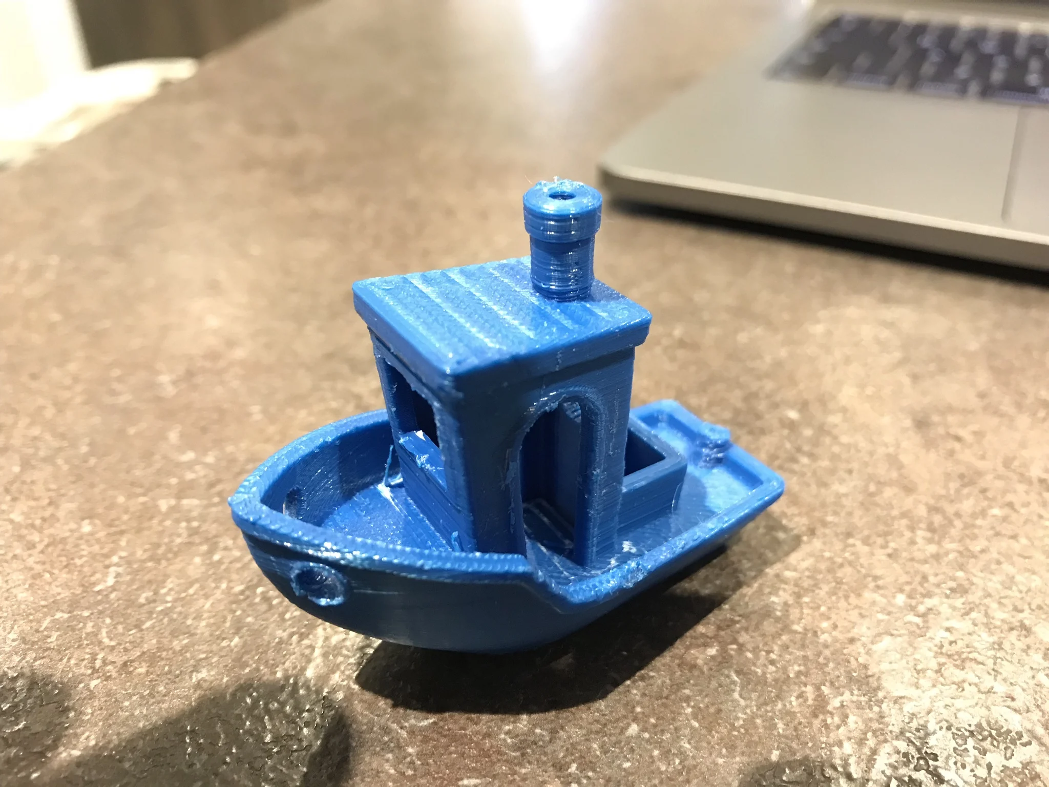

Could someone who knows assess this benchy?
I didn't use any supports. It came straight out of the printer like this.
I (myself) think it looks good.

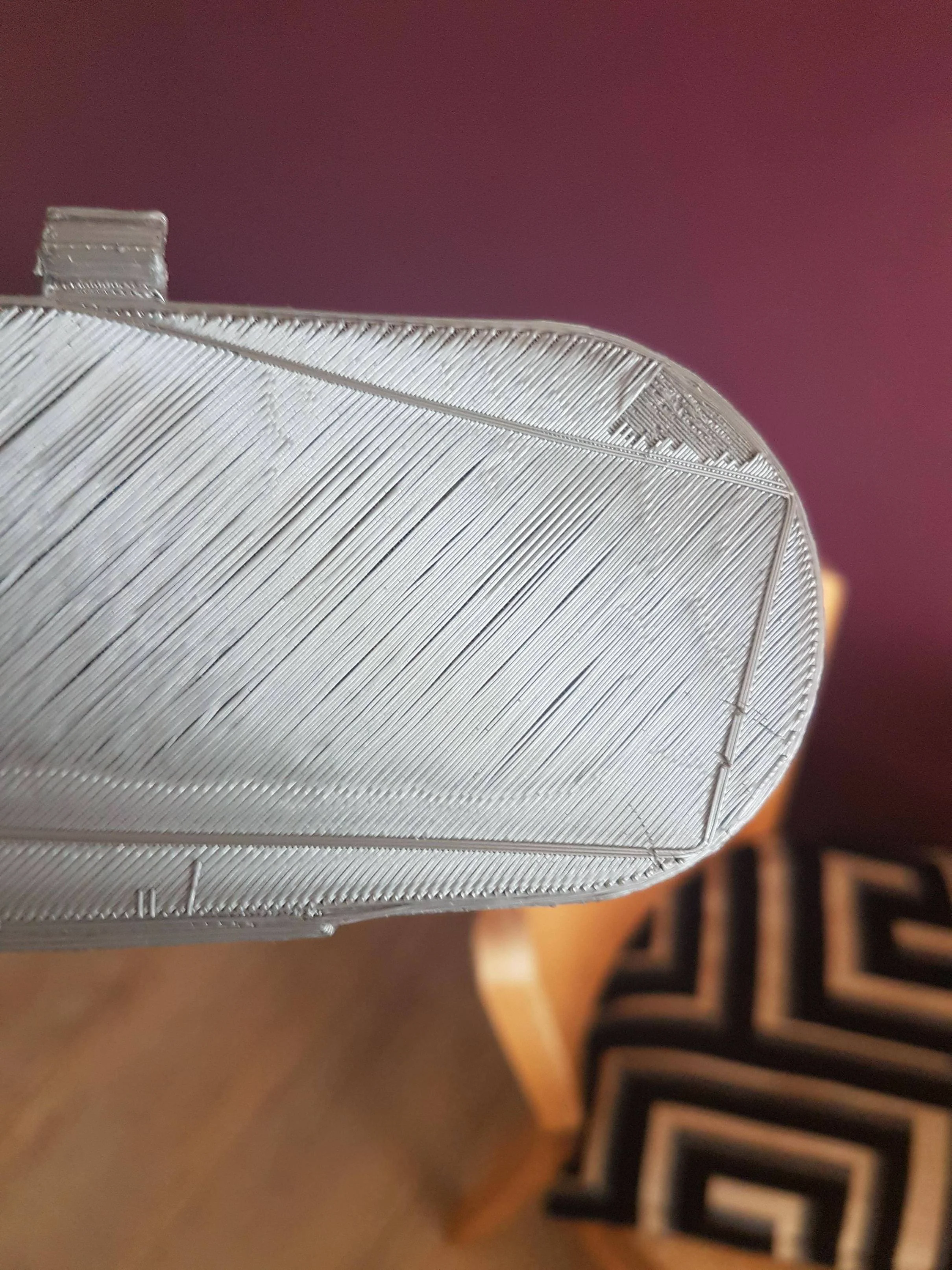

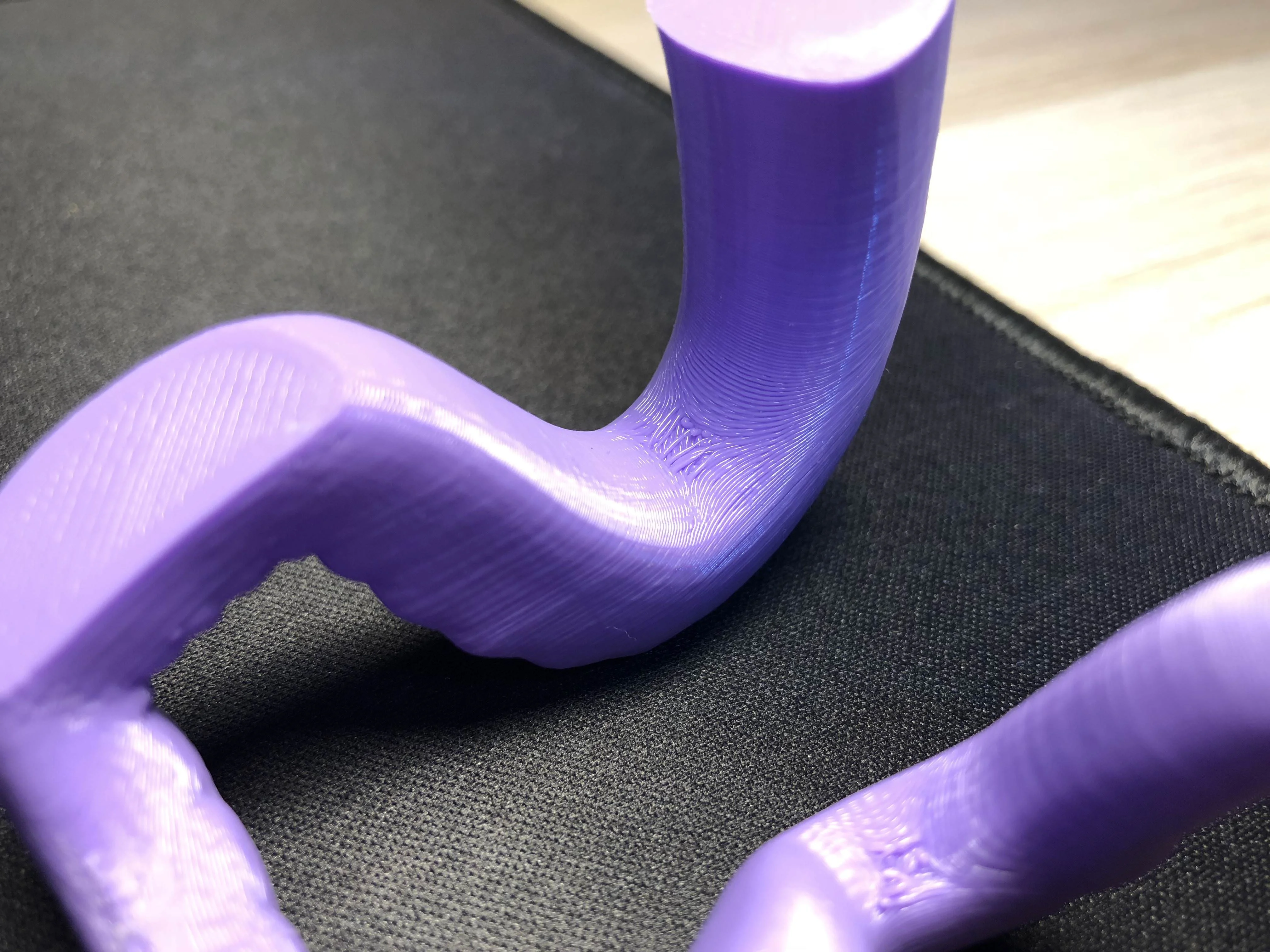

Can anyone help.
I have a weird (as a novice) scenario appear today.
A couple of PLA loops have appeared in my model that are not present in the slic3r model.
I've never seen this before.
At first I thought it was an error, so. I reprinted. But it's not.
It's on the bottom of an external Surface plane. (plane is about 10cm by 5cm)
The printed 'strand loop' is printed then the flat base on top
The flat base is printed on a support bed due to an overhang in the model
It looks like the strands are not part of an actual layer.
The same effect could by placing the loop by hand after later 20 and printing layer 21 on top.
I will add a pic later to clarify. But it Seems Very odd.
You cant remove it either unlike all the support material I've printed
I wondered if its Because I'm trying to print a large external Surface plane on a support structure?

Could be that the STL file needs fixing.

if on win10 load the stl up in 3d builder, import and check for errors. Had a fair few of thingiverse that needed fixing.

Interested to see a picture, I can't visualise what you're driving at. Whenever I have any failed print that looks like it might be gcode related, I flip the item 180º in Cura and make a new Gcode just to make sure it's not a dodgy file it's output for me.
If it's just a hanging bit of filament, it probably is due to the support. I've printed a couple of bits without support that were sort of pushing what can be done, and on the first couple of layers the filament just ends up hanging there. I've tried to photograph one to show you what I mean:
This isn't a very extreme example (the worse bit on this print I filed off) but basically where the printer's extruding from point a to point b, it's sometimes basically printing on thin air and sometimes the extruded filament will hang down a bit.. generally it will catch up after a couple of layers but you often get these scruffy bits on the bottom. I do find that even supported overhangs often have this to some extent. Is that what you mean, or am I barking up the wrong tree?
With this it can either be helped by supports, or better cooling etc. I've seen some pictures where some people get their printers to bridge crazy gaps and still have a good finish, no idea how they do it though! I have a petsfang cooler on mine with a blower fan and I think when the fans are on full whack they can do really good bridges and overhangs, but I never really have it turned up that high as that can cause its own problems. That's the way it goes with this hobby from what I can see!

So, 1, that hinges section at top of the pic is overhanging and lower than the base.
So a support structure is printed for the whole of the base.
Im guessing this leads to the non perfect base?
2, that's angular strand I can't see when slabbing though the sliced file. I even tried to pull the whole layer off. But I'm convinced it's part of the model, as you can see. It wouldn't come off!
Are you using Cura?
With it set to model view when you rotate the view the underside of the model is the whole base red? If it isn't then it isn't place perfectly flat on the build surface.
Something Ive had a couple of times
I'm using slic3r (it came with pre calibrated profiles for my mk3)
I see the red surface so I assume the colours are same in slic3r. I don't see those extrat lines at all.i will look closer. But they seem to serve no purpose. What I might do (this is my 3rd print) is chop off the overhanging hinges and print them separately. Will allow me to print that flat surface directly on the bed.
I guess it's not great too build a flat large plane on supports?
The overall I'm getting from my printer is fantastic. I'm impressed with 0.1mm especially
do you have a link to the STL?
Anything that prints flat, is going to have a bit of a rough base, where possible you have to print everything standing up, for the best overall finish

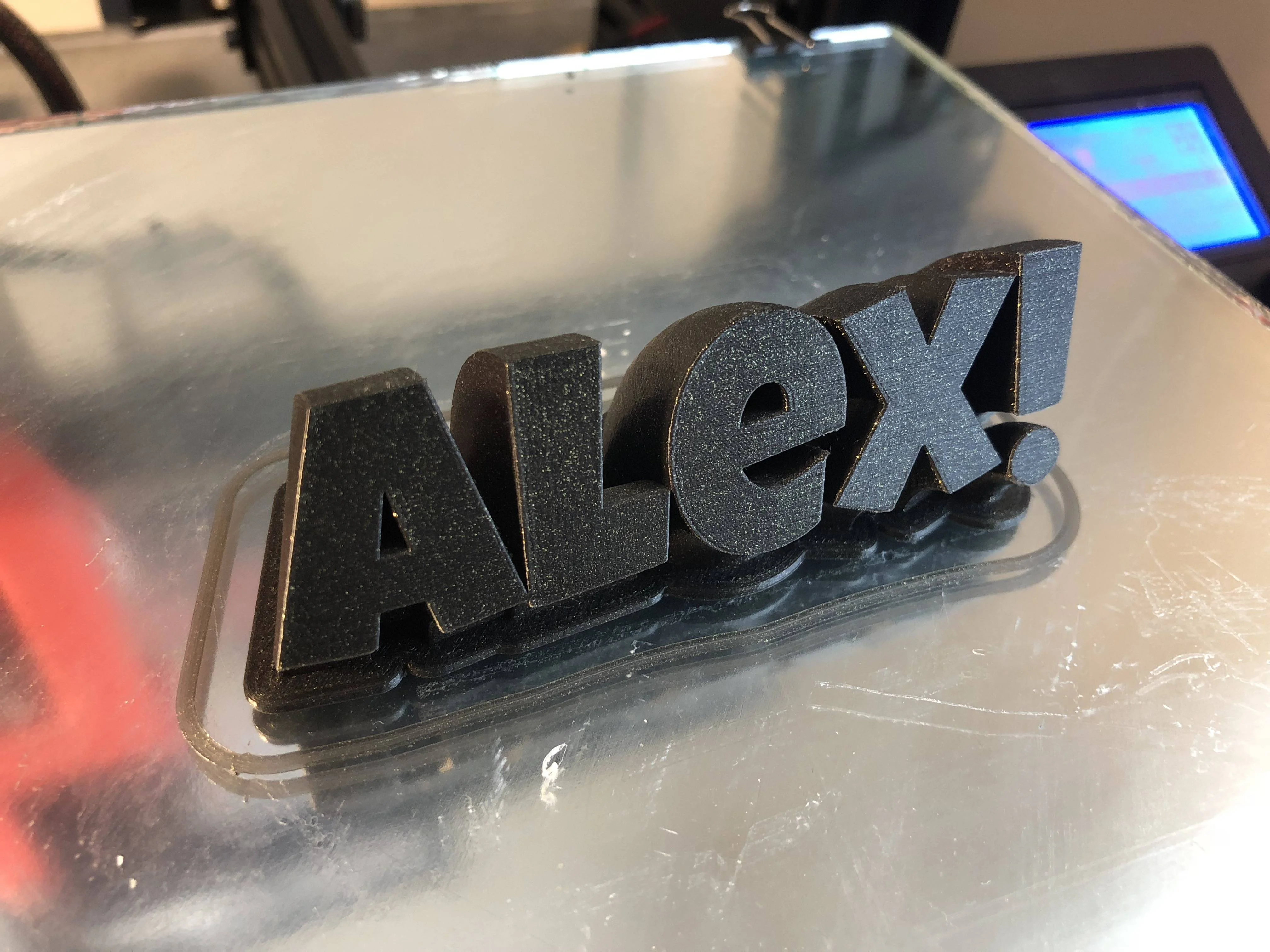

Hi, i am pretty rubbish with 3d design stuff, what did you use to make your name? Can you do one for me and send the file :P plz lol

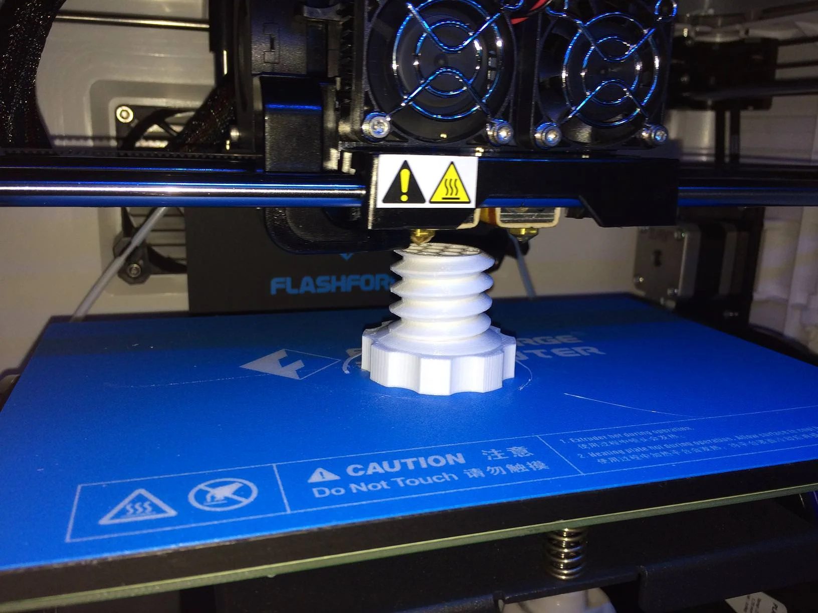

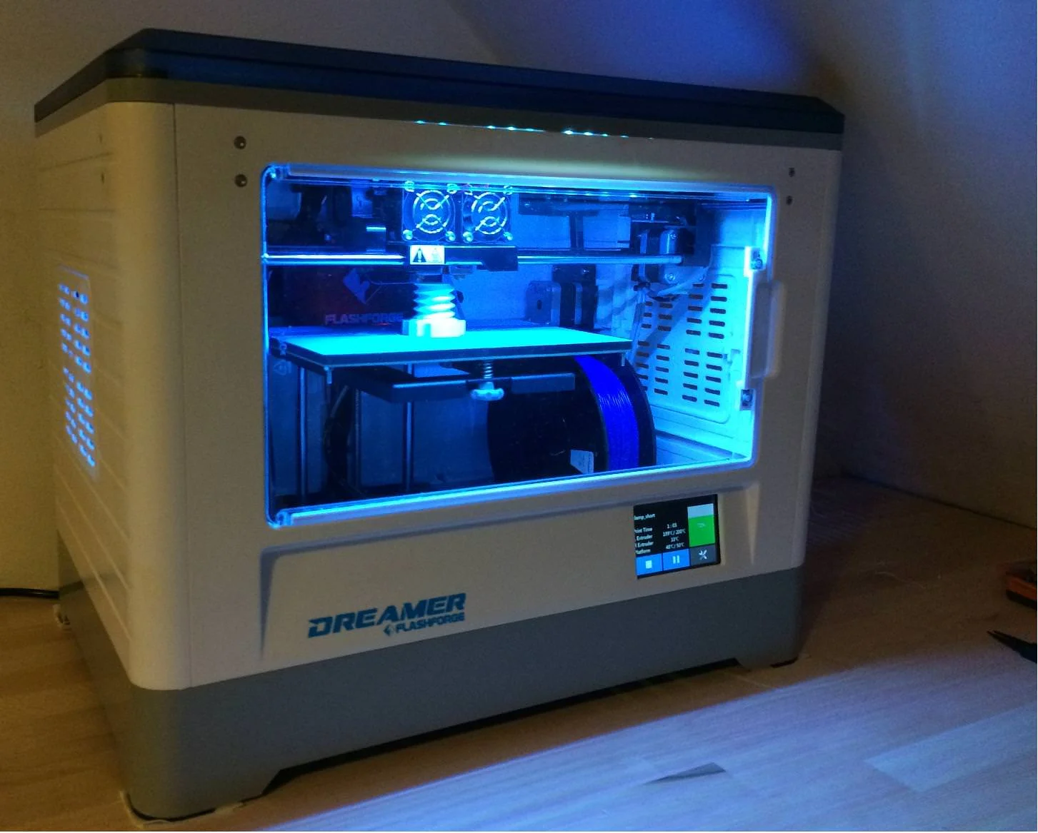

Potato photos due to printer being in dark corner of man-cave, printing my first non test print (screw for desk mounted headphone holder), just printing on standard quality currently it has two higher settings.
Very happy with the results (quality vs time to print), looking forward to printing more.
