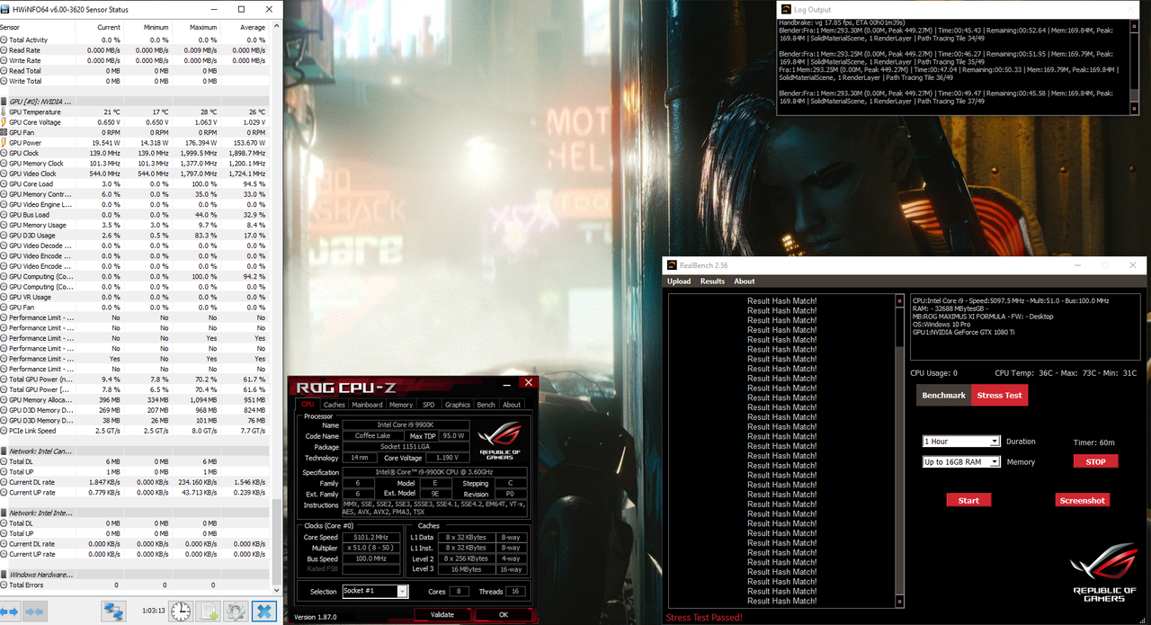

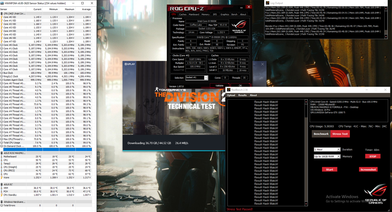

Screens of my 1 hour 5.1ghz run of RealBench at 1.243v under full load which AI Overclock set for me at 51/51 after reassessing my system, which it does every now and then, based on my cooling.
Fifty minutes in under full load.
1 hour completed, max temp was 86c.

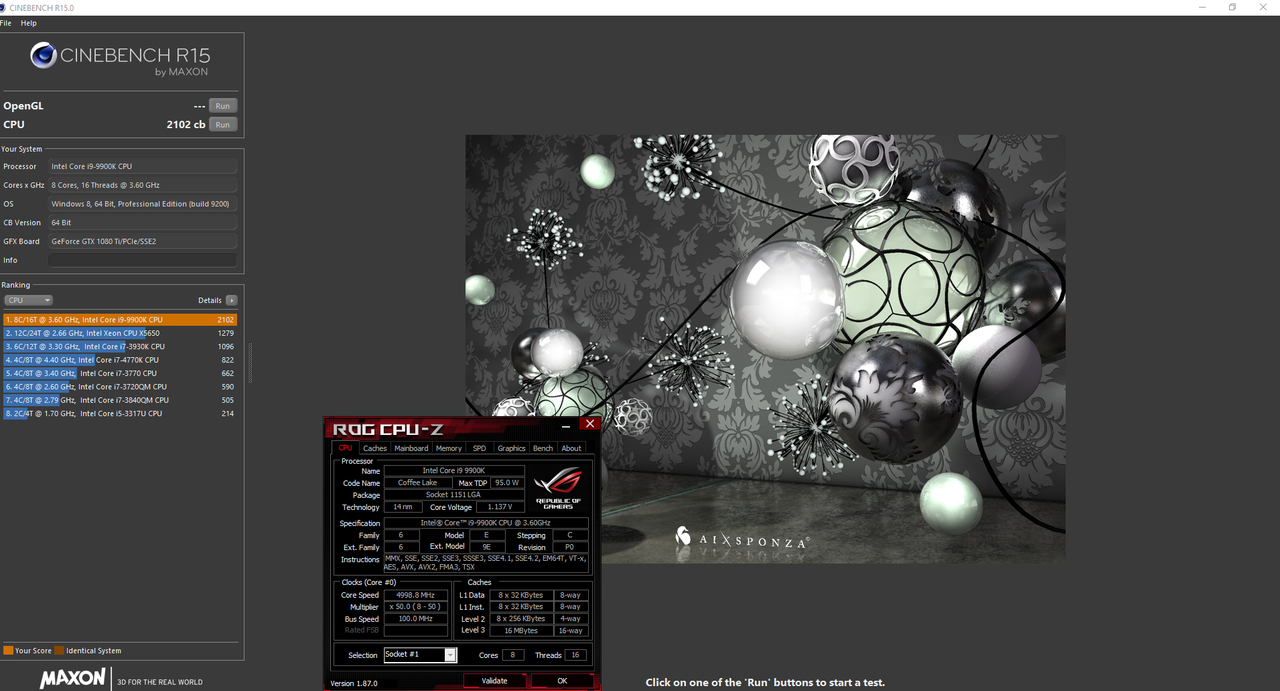

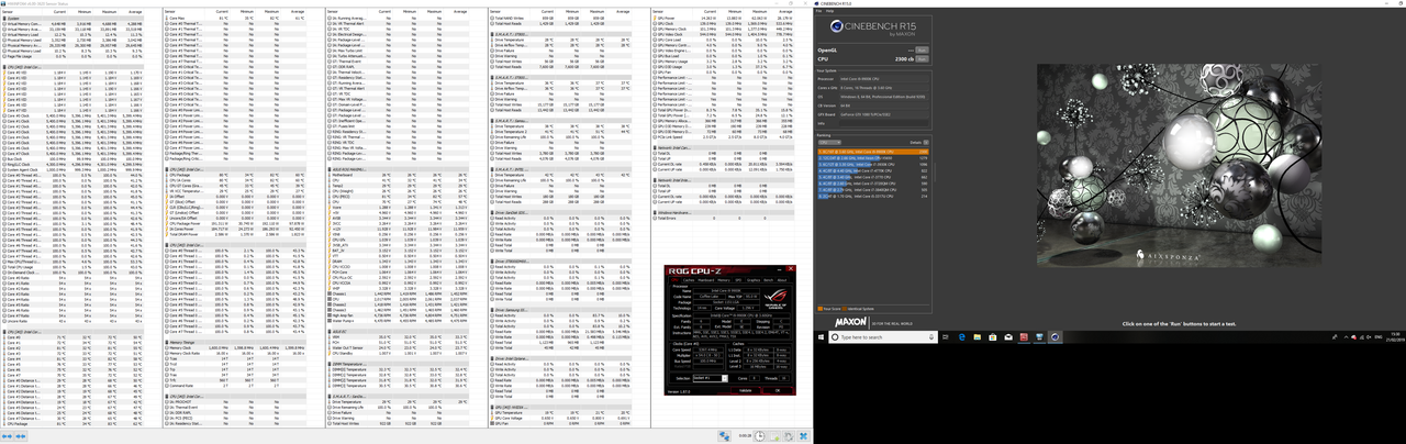

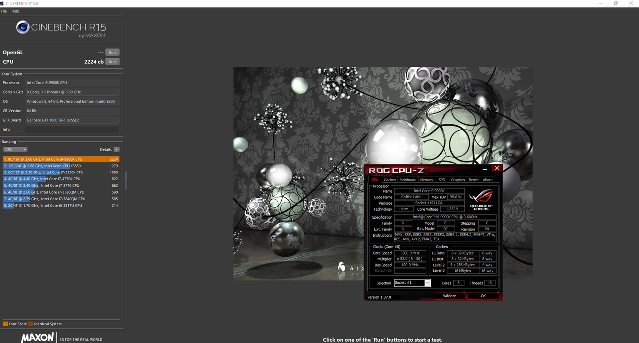

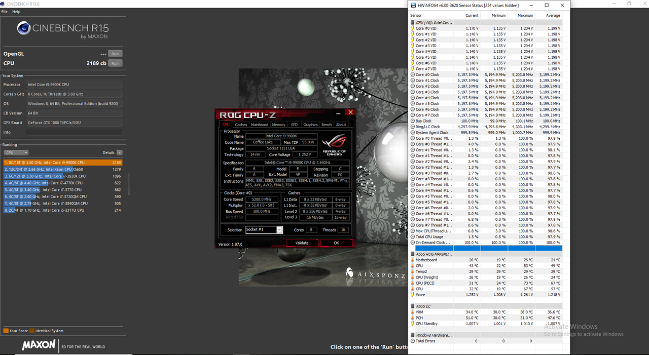

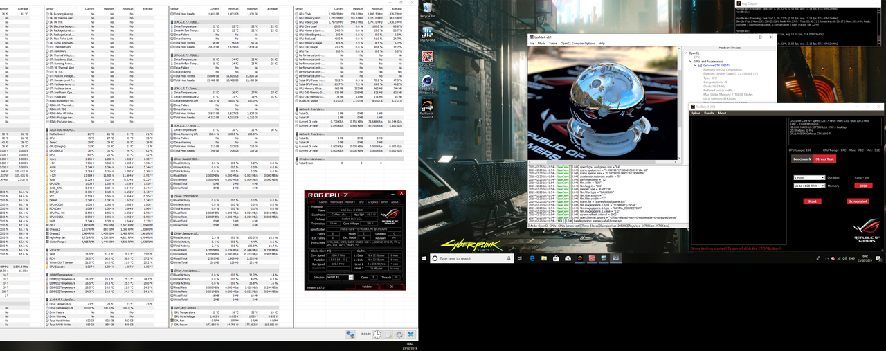

Okay, I finally pulled my finger out and uploaded some images.
1.128 was the lowest vcore I caught in a screenshot but not the lowest I observed.
I think the lowest vcore for this was about 1.146v according to cpu-z
The score on this one is quite low because I had other things running in the background while benching during the 5.2GHz run.
All runs were back to back and with an ambient temp of around 18 degrees ish.

Some of the runs have lower than expected scores in Cinebench and this is due to other things going on in the background while I was benching. I only have the one PC and not a great deal of time so I have to multitask, sorry about that. I may revisit this and update the scores if I begin tweaking the RAM and working on lowering the vcore for a given frequency.

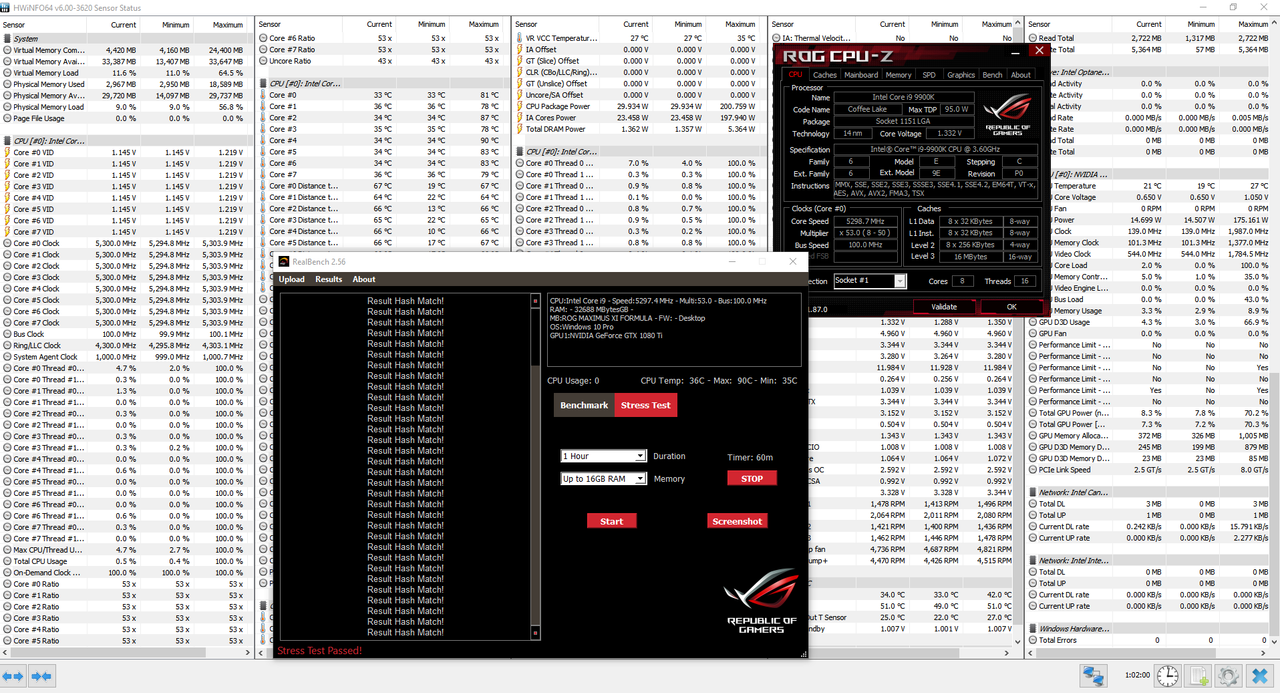

I can run Realbench at 5.4GHz but it starts giving WHEA errors, you'll see that all my screenshots include HWinfo to show that each run was WHEA error free. I 'think' I am at the limit of the board now in terms of power delivery, or perhaps my loop is at the limit in terms of heat but I am not going to try overclocking at below ambient.
For what it's worth, the VRMs on the Maximus XI Formula peaked at 42 degrees during the 5.3GHz 1hr Realbench run and don't go higher for 5.4GHz Realbench so I think they are doing fine. Even if the temp sensor is inaccurate and is reporting something crazy like 40 degrees lower than the hottest point I'm still well within the spec.

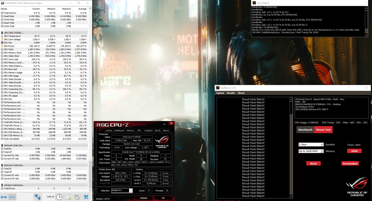

At load it drops to 1.288 which you can see (hard to tell, sry about that) in the row just below the CPU-z box.
Current 1.332 / min 1.288 / max 1.35
I thought it was set at 1.35 for vcore in bios with llc7 but if the max is showing as 1.35v in hwinfo that seems unlikely. Let me check and get back to you.
EDIT: Bios is 1.35v so the 1.35v maximum in HWinfo must have been a spike. I've just confirmed this by running everything again and recording the same figures with realbench running while I type.
Fwiw the 5.4GHz Cinebench run was also at 1.35v in bios with llc7.
