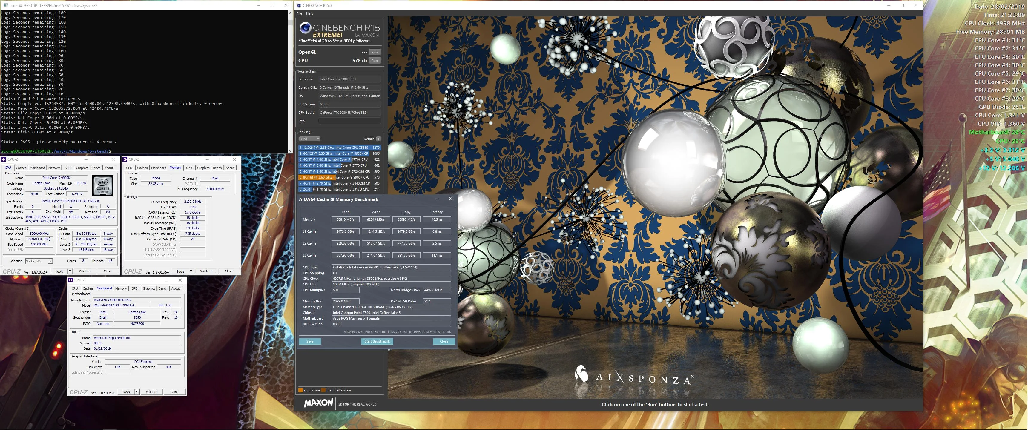

Toying with 4200MHz on the XI Formula (4x8GB). Beyond this on a 4 DIMM board requires a fairly exceptional IMC
VCCIO 1.2v / VCCSA 1.24v
Very nice SS, I can do 4133mhz @16-17-17-42 CR2 with two sticks of my 3200mhz cl14 on my Extreme. Not tried any higher on this board as yet, but I know they will do 4234mhz.
That's decent for a T-Top board. Two sticks can often be tougher in this configuration. It helps to have a kit validated for those speeds (4200+), though. The guardband is fairly narrow up there.

I snapped up a 2nd hand 9900k 6.8-9ghz (ln2) which arrived today so got that to fit and test tomorrow when I get home from work. Also a delid rockit kit and copper IHS ordered so I can do that in a week or so.
Nice scores btw! If mine comes anywhere close to yours, I’ll be happy :)
And a good IMC as well. ;)
Depends what you want to do with it. A lot of samples will POST up there, IMC variance comes down to how conditional it is. The stability window on VCCSA/IO also can become fairly narrow, too.
Whilst I've got you in quotes, here's 30 minutes of RB on my so-so spud. Things could perk up if I moved the setup to the bench table and improved temps, but it's currently home to my X299 system.
LLC6 / Adaptive / 1.385v / RB load 1.315v
Package TDP 195w / 2x 360mm EK Slim Line
VRM Crosschill / 2080TI/ EK Acetel Full Copper CPU
Uncore: 45
Core: 50 (no AVX offset)
DRAM: 4200 CAS 17-18-18-2T 1.4v
VCCIO 1.23 / VCCSA / 1.25
Water T: 33c
Very nice, but those temps are horrible. I take it your memory requires high'ish SA and IO voltages, when I run my 3200 kit at 4133 I only need 1.150v on both for HCI stability.
Realbench is based on Package, it is what it is and water temps are fair. Try those voltages with Google Stress app or Ramtest. I use this system daily so the odd synthentic bench means very little to me when it comes to CPU load.
If I can pass 1000% Coverage with HCI at these IO and SA voltages that's good enough for me. ;)
HCI is better at testing the memory/uncore interaction. If it’s setup correctly (one instance per thread with 90% available memory) then it’s still very much a valid test of stability.
Stress app test isolates the DRAM subsystem better, though. An hour can be fairly telling (plus it’s easier to run than HCI, and coverage is quicker).
A higher VID and lower loadline on this box hasn’t had much of an impact, the end result is similiar at these kind of loads (RB). On a better CPU I may have been bothered to delid.
