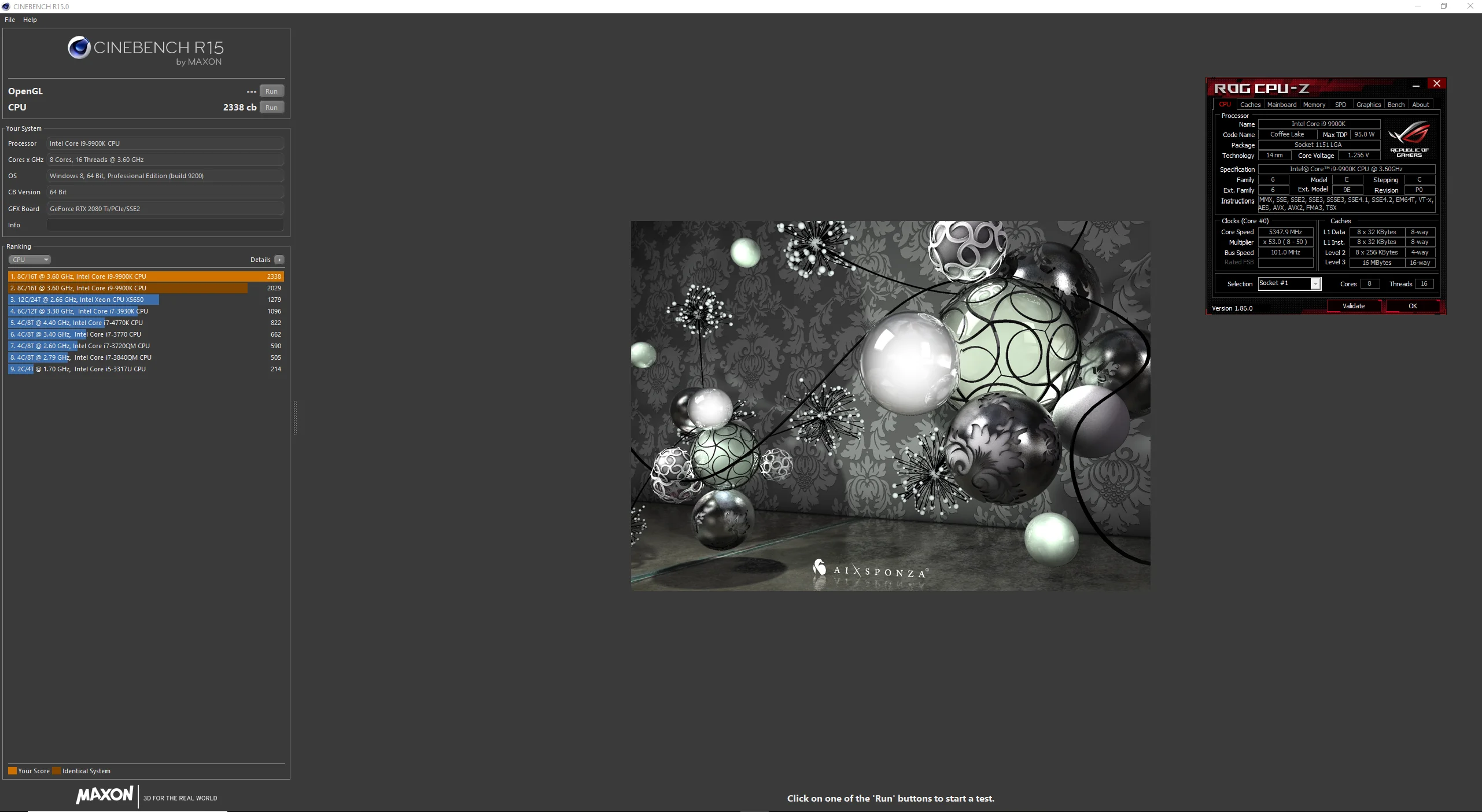

I snapped up a 2nd hand 9900k 6.8-9ghz (ln2) from 8 pack which arrived today so got that to fit and test tomorrow when I get home from work. Also a delid rockit kit and copper IHS ordered so I can do that in a week or so.
Nice scores btw! If mine comes anywhere close to yours, I’ll be happy :)

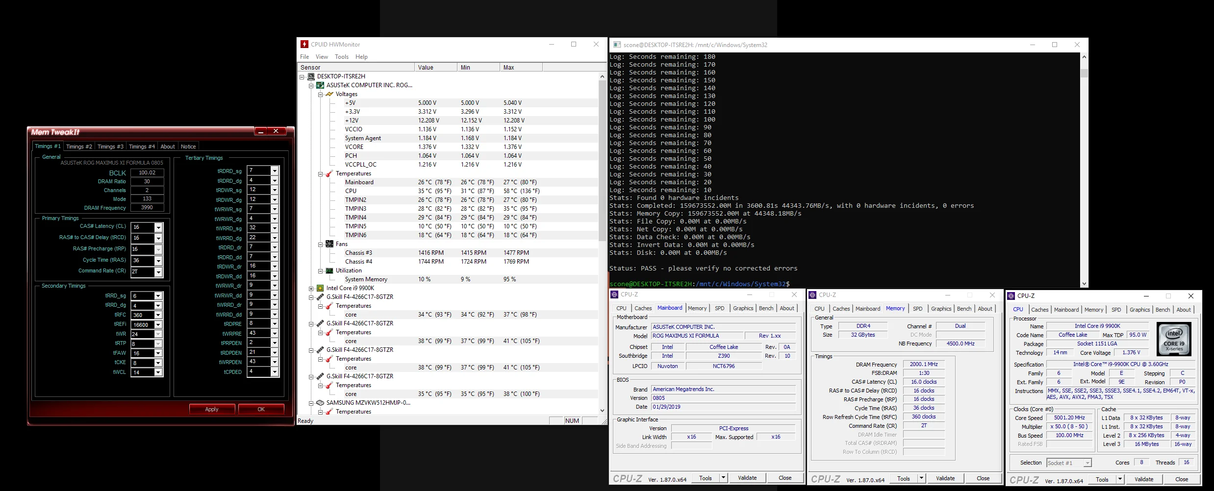

Upping the cache ratio now to the 48 multiplier, my chip can do 50 at least, 52 core ratio. Still using Aida64 non FPU/AVX, I don't use it so what's the point in my opinion. Load voltage 1.243v, max temp on one core 67c, lowest core 61c. Average core temps between 52c and 59c. Package temp max 67c, average 63c. Will keep tweaking. ;)

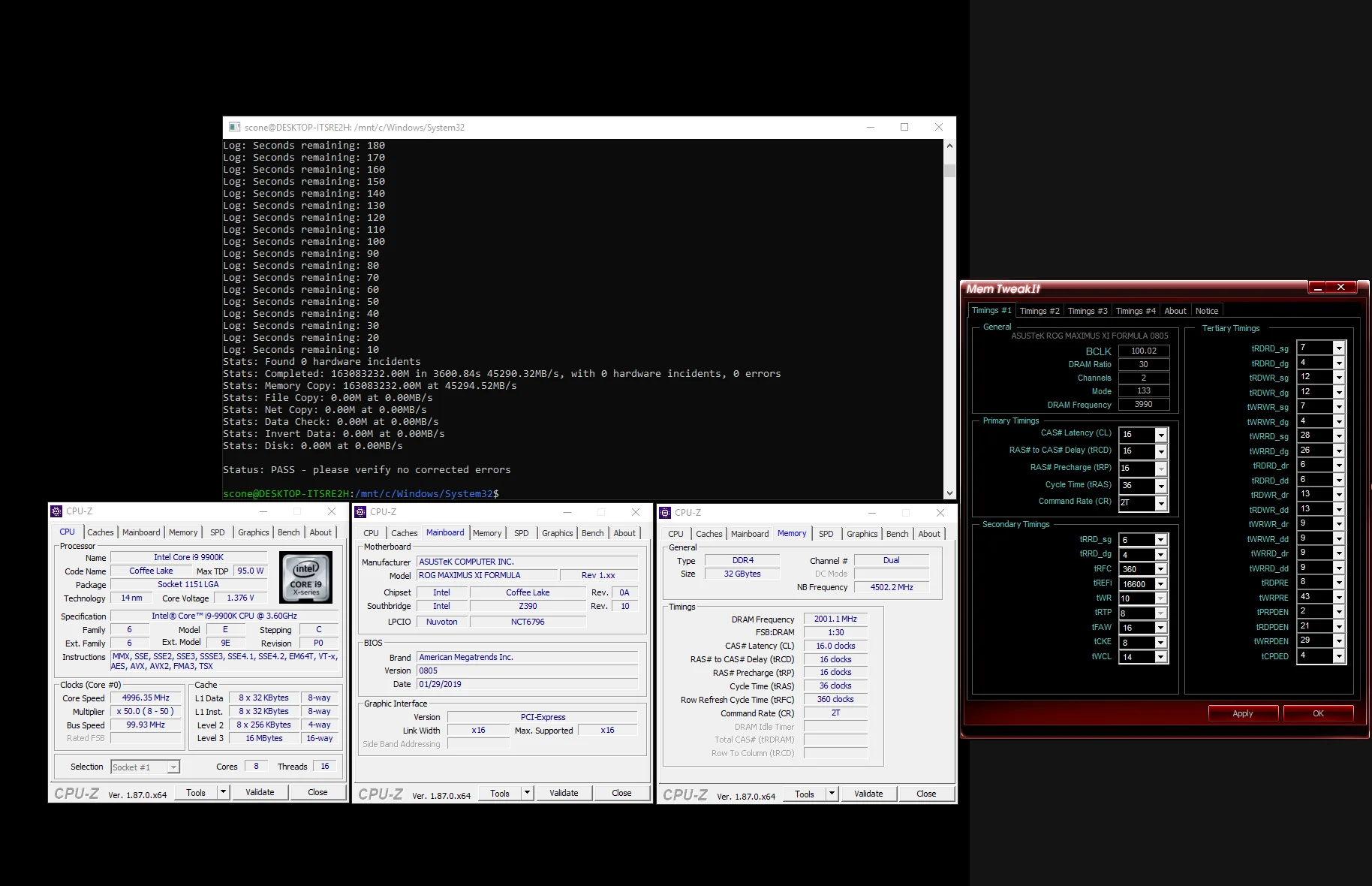

Just on my loop which is 3x360mm rads. Will be running at 5.2ghz (0 avx) for 24/7 usage, 4000mhz on the memory.
Load voltage 1.275v, around 200w, 80c on prime95 small fft's. Realbench around 75c.
