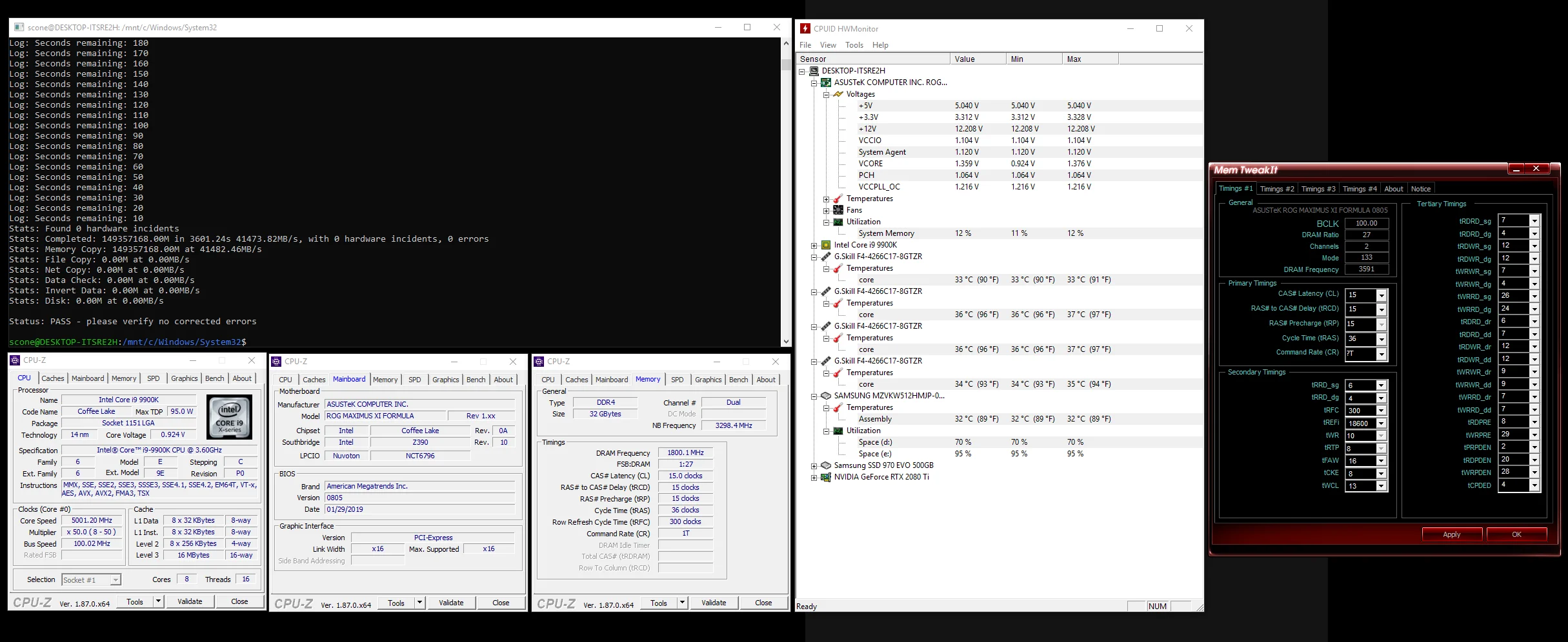

Do I just look up the rated timings on my g skill 3200mhz ram?
3600 15-15-1T
VCCIO 1.085v / VCCSA 1.12v
